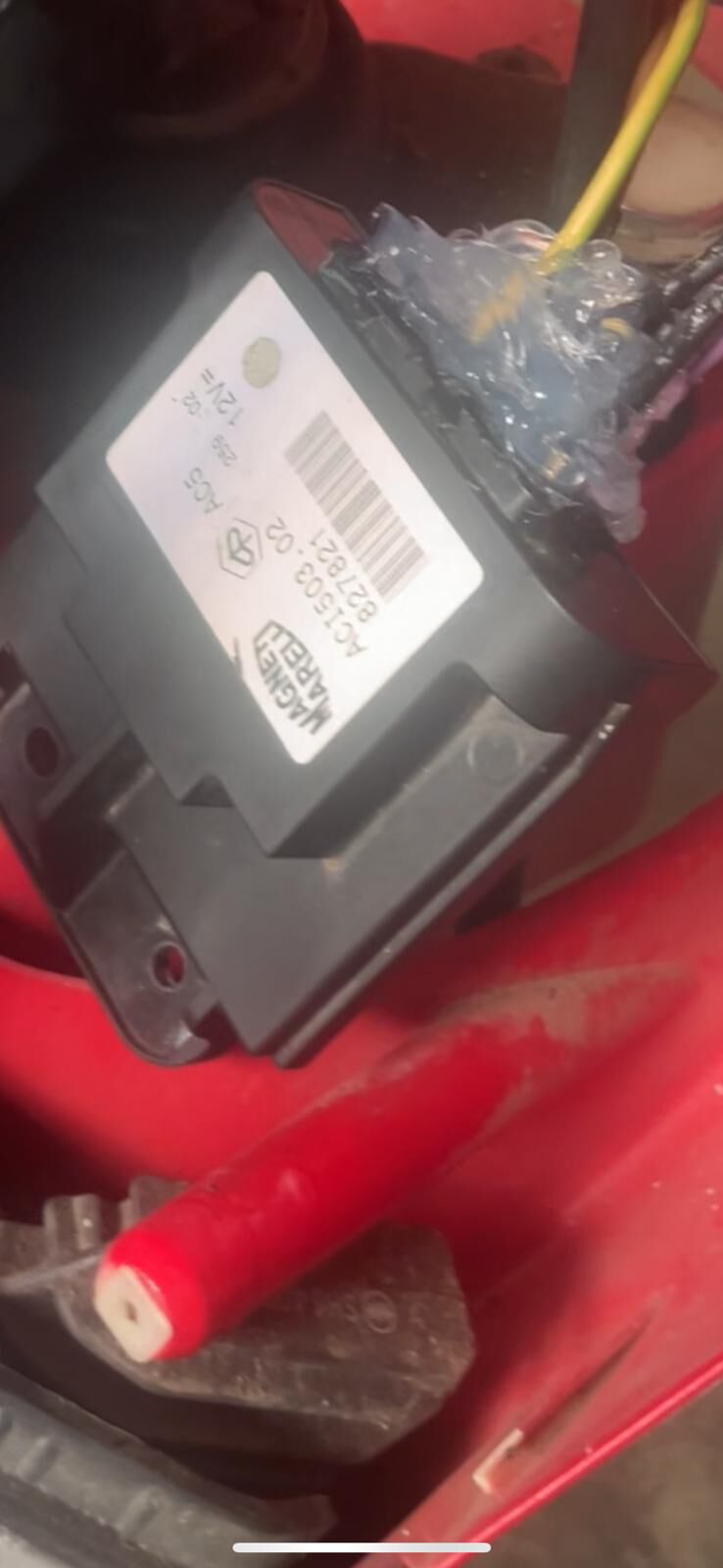

I need a picture of the plug going here. Since I do not know the position of the cables. Please photo of various points of view. To be able to differentiate well the position. thank you very Much.

Hi again
Oh , you've got a real mess going on with that wiring. I don't know, I think I suggest looking for a new wiring harness for your scooter and doing it once and for all. Once you have a working connector, you'll be able to swap modules without any problems. Just look for an installation where the CDI connector matches the VIN number starting with ZAPM. From a Vespa LX 125, LX 150 (carburetor models), Piaggio Fly, but only the first 2006 models, I think. I'm sure you'll find one for a good price somewhere.
Perhaps even a simple plug transplant would save the day. I'd avoid soldering (extending) the cables, as it could cause problems with "cold solder joints" and sudden power loss later. Thanks for the advice, I still need to think about that carburetor. I've always had the impression that the CVK2600A only reacts later to the throttle, not the amount of mixture delivered to the cylinder. When I installed a slightly larger 84-gram jet, it muddied it up a bit. And since I'm somewhat comfortable, the choke automatically suits me Laughing emoticon . As for the rollers, I'll try installing 15-gram Malossi rollers in the spring, since I'm currently using 14-gram rollers. Thanks also to the friend for the link. Well, the Polinii 198 was purchased yesterday .

Again thank u very much for the suggestion bout CDI wiring replacement, will do it asap and then try the malossi CDI once again. In regard to advancing the starter, since is possibile to reprogram the Malossi CDI, do you have done it? Or just staying on factory preset? In the next im gonna search also for a crank to replace mine, maybe also a longer stroke to port it at 218cc or similar w a spacer under the cylindeer. Any suggestion on products to place on 198cc Polini? Camahaft are not in production from anyone in europe but Malossi and Jasil should have a crank set
