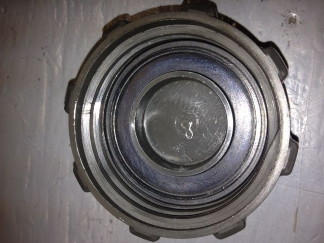

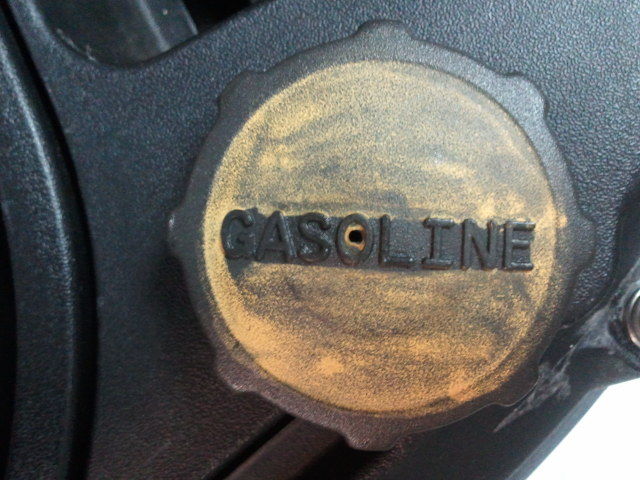

Drill a tiny pin-sized hole in the gas cap and you will never have to worry about the problem again. I promise you it works. Replacing the hoses will do nothing but waste your time and $.
I listened to my bike make stupid fart noises and stink up the garage for one day before I did the gas cap modification.
The hole is so small you wouldn't even notice it, but it works.

As I already said, replacing the hoses is off the table, so thank you for confirming this decision.
Your hole in the gas cap was called "a very bad idea" by some of the big wigs here. I think it had something to do with the scooter's rubber showing sideways. Good that it works for you. However, a question: when I park my hot scooter in the garage and the hot exhaust keeps warming up the tank, where will the fuel fumes go if not out that pinhole and into my garage? Or am I missing something?

The gasses never get built up and the tank vents all the time so there is no built up smells.
You never listen to any of our advice Arno and I wonder why you even ask for advice at all. I think it was JimC who all but begged you to disable the evap equipment last time you brought up this topic and you argued him the whole time. At the very least you could try my mod and get a new cap if you didn't like it. I live in the hottest place in the country and I know how gas fumes get in the heat and after a ride and what they do to a GTS.

Mine's vented already
My GTS' gascap came with this small vent "notch" cut into the inside allowing pressure out as it was designed. (11 o'clock position in this photo)
Our GT200L gascap doesn't have the cut out.

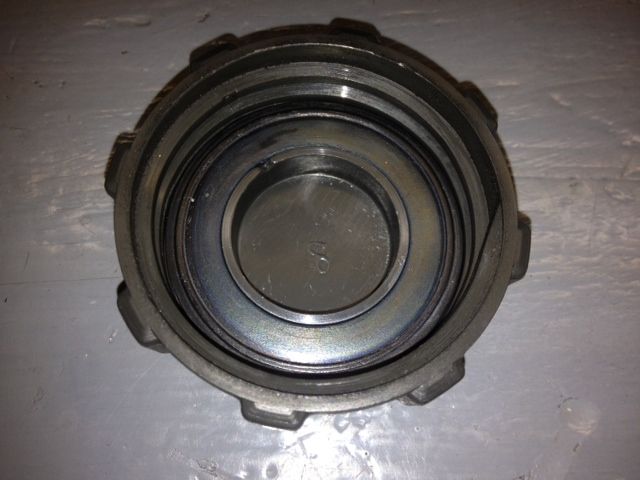

Posts: 7576
GT200L cap....no vent notch

How does that notch aid venting? The sealing ring is still further into the cap...

It lets the pressure out, slowly past the gasket, Otherwise whats its purpose and why the GTS and not GT200L.
Why wouldnt there be a separate gascap made for the US? Theres a separate entire evap.emissions control system made for the US.....

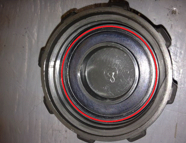

Good find about that notch difference in the fuel cap. Unfortunately, it has no effect on the GTS' seal, which is formed at the outer edge of the cap's gasket. See the image below. Also look at the filler pipe of the gas tank: there is nothing that would interact with this notch.
That said, our ingoing approach with this thread was wrong. It was going a palliative route, when I am really after a curative solution. So I need to find the etiology, to stay with medical terms.
My plan is now to remove the evap system and inspect all the parts and connections in hope to find the leak, fix that leak, and put it back together in working condition.
The advice I received here will be immeasurably helpful to achieve this goal. As I said, I will report on what I find and will keep asking and discussing, should there be further questions. Thank you for bearing with me.
The GTS' gas cap will seal only along the red marking (approximated). (Image shows a GT's cap)

jimc wrote:
DO NOT DO THIS! Unless you know your tank is vented that is. On some models (GP800 for instance) tanks are pressurised to some extent by design - they have a pressure release vale instead of an open vent. Plus drilling a hole is equivalent to just having a vent tube to ground instead of the evap crap - so not a solution for Arno/Salima.
3 riding seasons and 5k miles later, 2 in the Florida heat with no issues = working solution. Taking the Evap crap off vents the tank anyway and many people here have done just that with no ill effect. I don't know where your argument on this comes from with this particular line of Vespa GTS machines.
