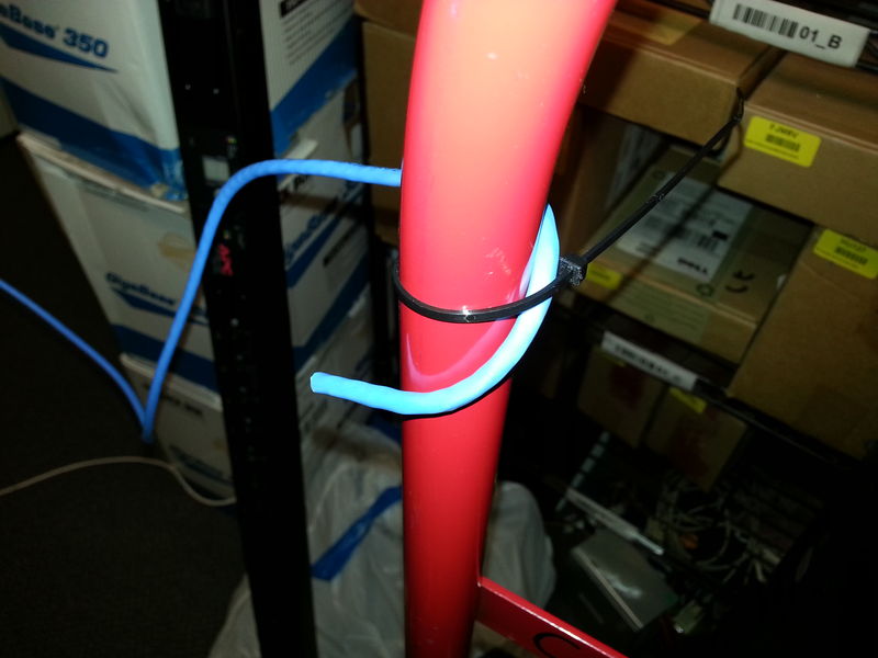

One thing I forgot to put in the wiki is it may be a good idea to put zip ties on the anchor points both on the scoot and trailer. This is to help prevent them from unhooking in the event of hitting a hard bump. Unlikely but possible.

Any force sufficient to dislodge a properly oriented and tightened ratchet strap's hook would be far more than the force required to break a plastic zip-tie though. Even the largest of the ties aren't designed to actually resist any kind of serious pulling stress.
He's talking about tie wrapping the hook of the strap so it doesn't come off.
Mount hook on bike and vehicle or trailer, then use the tie wrap so the hook can't come loose. Not sure if that helps explain it better or not.
