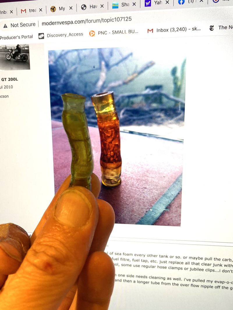

Well, I have extracted this fine specimen of "Tubus Corrupta":

Thanks for the added info, Richardsan and Judy.
As yet, I have only replaced the #1 "tubus corrupta" in the photo above, but that solved the gas leak problem! I bought the higher quality tubing, and some clamps, from my local auto supply store. Although I was prepared for a deluge, there was no flood, just a tiny bit of fuel (thanks again caschnd1!), so I think all of the attached components are sound for the time being.
