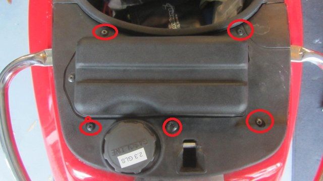

MV is, as we all know, I wonderful source of maintenance knowledge and help. Even if I know what the problem is I will throw it out here just to get it confirmed by knowledgeable people. Just as I did with this one. So I decided to document my problem in hopes of helping others.
The symptom: Starter stays engaged all the time even with the key removed. You have to disconnect the battery to stop it.
The cause: Bad starter relay
This is a easy fix. You can pull the relay and take it's cover off and clean the contacts if you want to try it. This is simple. If that does not cure it you can just install a replacement relay for $16 +/-
PROCEDURE:
Disconnect the battery.
Remove the rear cover by removing the 5 screws and the gas cap.
Pull the relay.
Replace with new relay.
GOOD LUCK.
remove the 5 screws and the gas cap to remove the cover

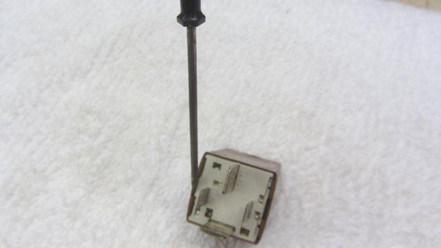

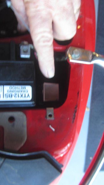

This is the starter rely. Just pull it out.

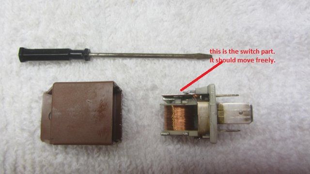

if you wish to try and clean the relay gently pry it open
