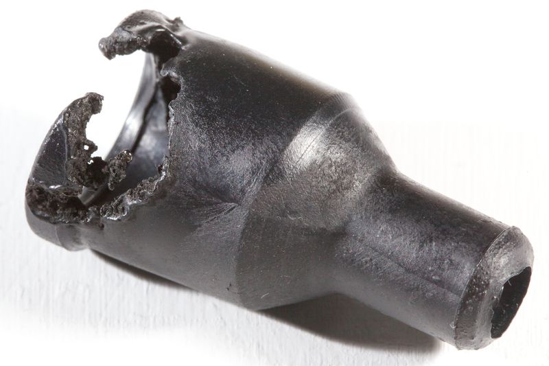

2012 300 GTS Engine Cut out issue RESOLVED.
Here is my experience for the record. After 620 km I experienced engine cut out on my 2012 300ie GTS.
Engine stall ONLY occurred from idle.
I brought it to my mechanic after reading the forums and he determined two different issues:
First, he tested kill switch. Switch would kill the engine, but the engine would start with the kill switch still turned off. He replaced the switch and then it operated fine.
Engine still stalling though...
Secondly, and these are his words.
"Ignition leak found to be cause of fault. High tension wire (spark plug wire) appears to have been torn during assembly. Having the high tension wire connector at the high tension coil exposed has led to arcing of the spark to the frame. This is evident by the melting of the casing of the high tension coil and the above mentioned torn grommet."
I've included a photo of the melted cap. The melted plastic encased the high tension wire and was quickly filed away, tested and worked fine. No more stalling. Warranty item.
Happy to say the Ti-Fighter is back in action! No stalls, no worries.
All is fine now! I hope this info helps someone else.

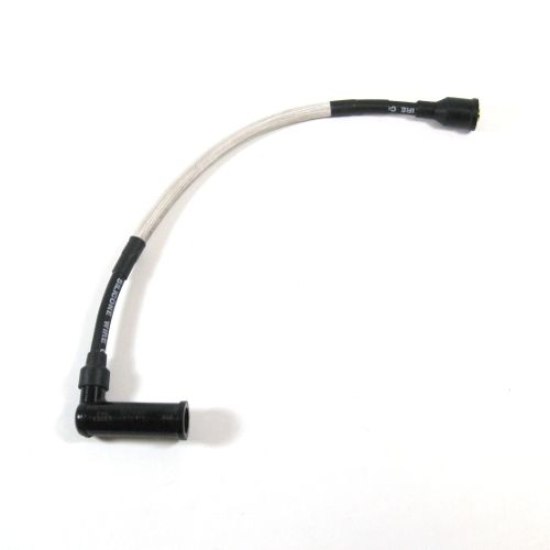

Simple Solution
Bill Dog wrote:
My "less than 1000 miles on it" 250 died after the HT cap came lose from the lead so it probably left the factory like that and my "less than "500" miles 300 Super has had the cutting out for a second experience but my local tech extended the cable a little just to make sure it can move a little without breaking contact and it's not done it since.
Oddly enough the boyfriend of the new owner of my 250 had two engine out repairs in an attempt to stop his 300 doing the same and they havn't cured it.
Bill X
Two years ago I installed this in my GTS with great results. This product is exclusive to SW (and so is the picture). Why not give it a try?
