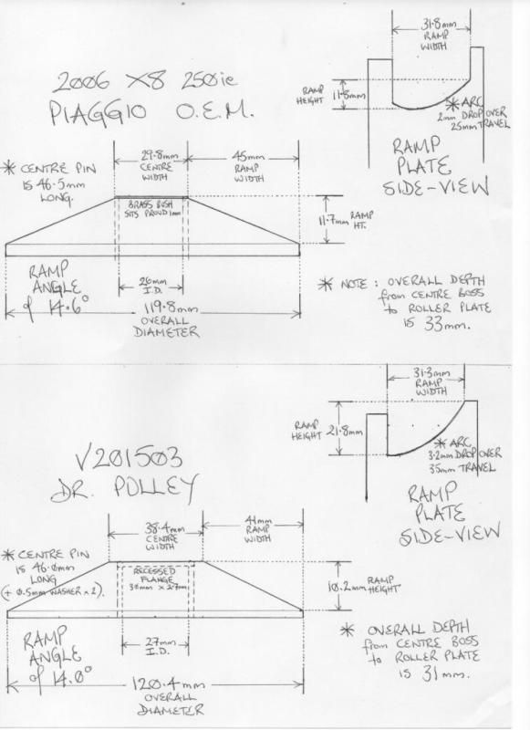

Gday everyone.
I bought the V201503 off Dr Pulley on the Xmas special too, and I have promised the man performance test results to go up here too.
I will be picking up a new belt tomorrow, so I expect that in a week or so from now I will have all the results I promised (I have 5 days away at work in between, hence the delay).
I have however, taken some measurements of the V201503, and it MAY indicate what we MIGHT be able to do to use them successfully.
Attached below is the little comparison sheet I drew up. I don't reckon it was a waste of time at all, because now Mr OopsClunkThud will have one more variator to add to his list of options!
The first thing I noticed, is that the ramp distance from the centre pin flange to the outer edge of the pulley is 10.2mm for Dr Pulley, and 11.7mm for my stock X8 250ie. This would mean the belt MUST ride higher in the sheaves, as the outer edge distance between them will be 1.5mm less at full throttle. A spacer washer fitted over the pin, but between te sheaves would be the first step to correcting this decreased gap, to keep the belt at the same distance as stock. It may not be an issue on Leader motors, and I don't know about the Quasar 300s, but my 250 as stock has a small amount of belt rubbing already, with NO mods at all, even rollers.
The second obvious difference between the two variators, is the angle of the ramps for the sliders/rollers. On the stock variator, the ramp for the rollers only rises 12mm or so, over a 32mm or so distance. However, the D.P. ramps are much, much steeper, rising nearly double OEM at 22mm, and over a shorter distance of 31mm. I will leave it to others much more versed in CVT nuances than me on how this would affect the operation of the variator, but I would expect the rollers to rise much quicker up the ramps, and also exert greater pressure on the sheave from the same roller weight, and at an earlier stage.
There are differences in the belt face angles also. I measured the OEM ramp face at 14*, and I measured the D.P. ramp face at 14.9*. Now please bear in mind I'm going to the city tomorrow to get new glasses when using the angles as a definitive measure! I can still see the verniers properly, but I can't vouch for exactness! I spose it's enough to say the D.P. angle is slightly higher.
The quality of the piece is exemplary. The alloy is beautifully made and machined, really nice piece. It's also quite a bit lighter than OEM (my scales don't read that exact). All in all, I'm very happy to have spent the money to have bought the piece, it's very shiny!
Performance reports to follow. I promise Dr Pulley!

Fatboy, I have a range of sliders in my garage, but for the standard variatot I liked 11 gram, much the same as everyone else has said. In my Polini variator I prefer 13 grams.
Monrod, don't forget that the sliders are working against two ramps - the one in the cast half pulley and the one in the metal plate at the back. So one has to look at both for the total picture of gap versus radius. You will also need to measure the two back plates to complete your comparison. Of course, if they are the same then no problem, but near as I can remember they are very different.
I disagree about the sliders moving faster up the steeper ramps - I think it will have the opposite effect. The centrifugal force of the rotating sliders is fighting against the contra spring in the clutch, and I think having steeper ramps is like going uphill. To get the same amount of slider/belt movement at the same revs, I am convinced you would need heavier sliders to push against the steeper ramps. Or, in other words, steeper ramps will keep the engine in a "lower gear" for longer as revs increase.
Mike
Mike
Yeah, that's cool. Thanks Mike.
As I said I really wasn't sure, but I'll take your word for it!
And yes, the backing plate is different. How different they are working together compared to stock is out of my knowledge zone I'm afraid.
