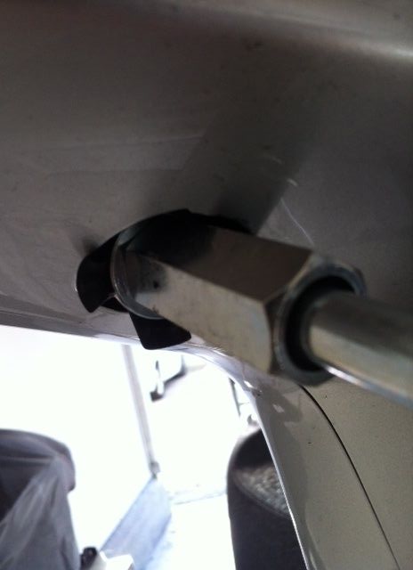

Hi All,
This afternoon I installed my small Vespa windscreen. I read through the MV threads and felt armed with all the info I needed.
I pre-assembled but kept things loose for adjustment, and tapped the posts/struts into the headset with a light mallet tap.
I noticed that after installation some of the plastic expander bolts are visible from the outside.
Please see photo.
Is this typical or is the expander bolt not in all the way. It's tight, seems to fit the headlight properly but the exposed expanders seem wrong. Is it? And if so will I be able to get the expander bolts the lay flat again to give it another go?
Thanks for reading.

I have an aftermarket windscreen on my GTS, but I had a Vespa-brand one on my old LX. If memory serves me, that is not correct. Something's off, though I can't pinpoint it from memory + the one picture. Hope others chime in and you get the answer(s) you need.

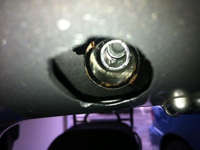

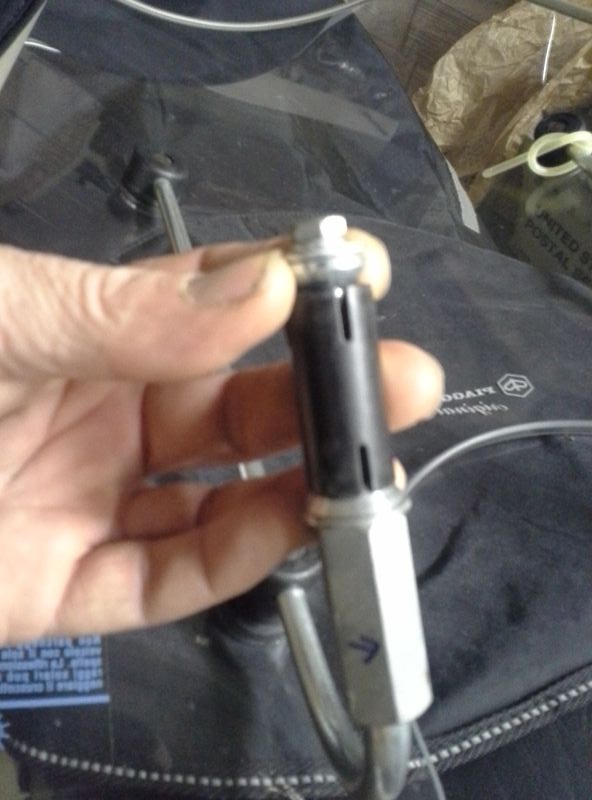

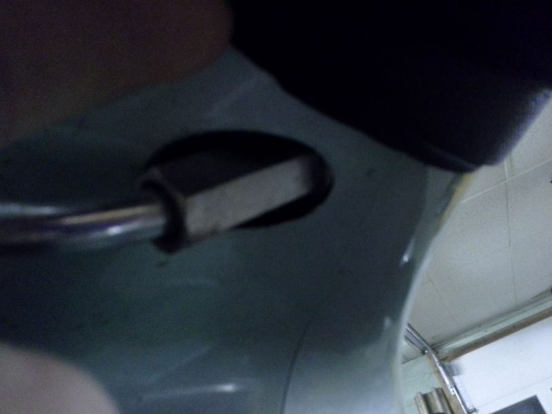

Here's mine installed...snugged up tight....
None of the black part is exposed..I would pull it out...find a drawing of it and reinstall...I'm betting something did not go together correctly...
The black piece you see is the part that expands to hold in place...

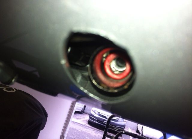

Update
So I took another stab at installing this windscreen on my GTS250.
I double checked the order of parts and carefully compressed the black plastic expander barrel into it's original form (from my failed first assembly attempt). With the left and right windscreen posts set up identically for installation I carefully and fully inserted the assemblies into the scooter.
Before I tightened anything I immediately noticed the right post (my right, facing the front of the bike) was sitting deeper into the hole. I took the posts out and felt around for any burrs. Nothing.
I peered in with a flashlight and noticed that the left hole had some sort of red washer/cover around the mounding hole that the right side did not. My guess is that's what is causing the left post to not seat all the way into the hole. The right side does not have this.
Please see pics below.
Does anyone know what side is correct? Should I try to remove the red washer/cover so the two pieces will sit flush? I will be the first to admit I am new to working on scooters, but I'm not a mechanically challenged moron.
The bummer is the the plastic finish around the holes is starting to take a beating.
Thanks for reading, and I appreciate all comments.

Well, mine certainly did not (does not) have that red washer business.

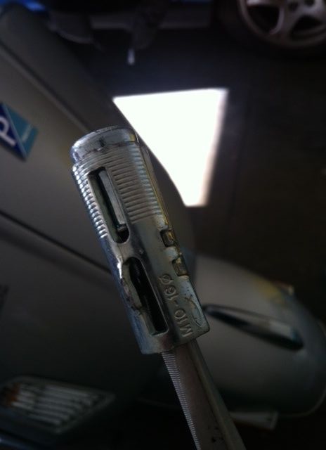

Finally
After multiple install attempts, scouring the interwebs for info, and chatting with the fine folks here on MV I finally got fed up and took the scoot to my dealer to see if they could shed some light on my inability to properly install my windscreen.
With my pride in the gutter I explained to the dealer that I had been unsuccessful with the install. He examined the mounting holds and says:
'Did we have a different windscreen on this in the showroom? If so we did not take out all the hardware.'
'Come back when the service dept. is open and we'll figure it out.'
WHAT?!
Thirty seconds back in my garage and a long flat head later... Disco.
