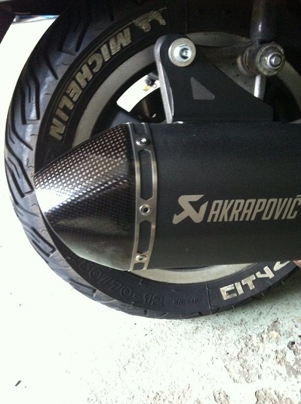

well... i'm F**ked !!
i got the DB killer in the mail, i went ahead to install it and drove 25km untill the exhaust was hot and tried to remove the bolt.
it did not work and now my allan key has no grip on the bolt anymore, and yes i'm using proper allan keys with a rounded head...
i have no idea what to do now
If I understood you right you make round inside your bolt?
http://t3.gstatic.com/images?q=tbn:ANd9GcSfccVpZLm8TC2DiwNr6BDnK6n0maK6IA8FXG3Mkk5X4yEbfV44
and now your bolt not coming out?
It's easy man.. Сut your bolt in two sides.. and make it like in the right bottom bolt..
http://pics.livejournal.com/tema/pic/000cy0gb
and then unscrew it by large flat-blade screwdriver

That's the problem, the bolt sits in a angle 10cm deep in the exhaust ((

photo's
(appearantly i can't get all the photo's in 1 post so i'm forced to to it in several posts...)
the akra

Okay clear now.
Think your going the right way by trying to break and grind out that welded on nut in there.
That's the only way to, and the safest way, if you scratch something then its the db killer witch is going in the bin anyway.
Have patience it will come out..
