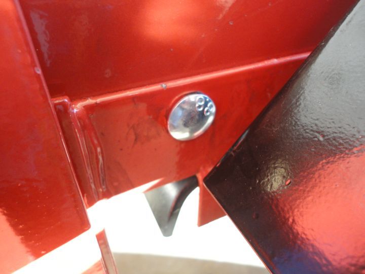

The basic trailer construction was fine. Only one major 'gotcha' - be very careful with tightening up the front hitch bolt, you may need a stand-off washer between the hitch and the frame to prevent the hitch inner tongue from being squeezed immobile. The instructions suggest three coach-bolts each side are needed to hold it folded flat - one is quite sufficient (and its length needs to be cut down) as the locations for the others are buried behind wheel arches etc.

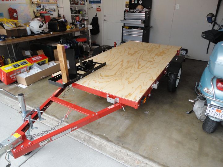

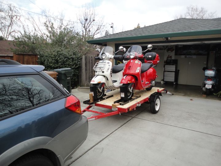

To fit two Vespas onto the bed, they have to be staggered. I arranged for the right-hand scooter wheel-chock upright to be right above the front of the floor, and the left-hand one about 10" further back. The existing fixing holes in the base of the chocks are staggered, so you'll have to drill at least one more hole in each to allow a couple of bolts to hold each one down to the centre frame member of the front part of the trailer. I arranged the front-back centre line of the chocks to be right over the 2"x4" slots provided at the front of the frame. Like this, two GTSes fit side by side quite happily. The tongue weight came out at around 40-50lb, which proved just fine.

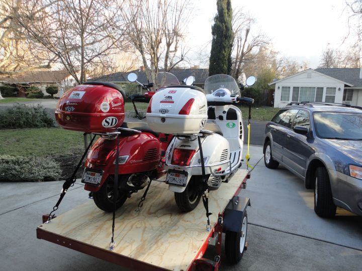

Tie-down points - I bought the smaller HF ones, and bolted them to the frame with 1/4" bolts in suitable places. A couple of holes wouldn't sensibly be through the frame, I used 1" dia washers to stop the bolts pulling through the plywood floor.

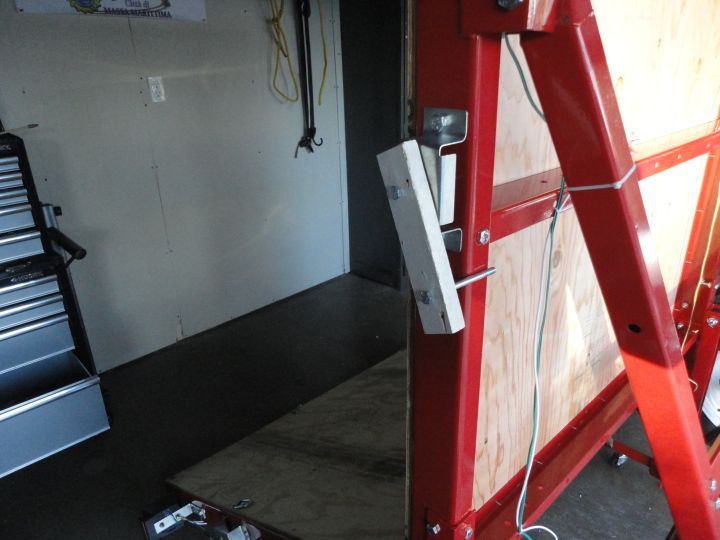

When folded and upright, the trailer rear wants to start folding down to the floor - I made a 'U-bolt' with a gash bit of wood and the long bolts that were intended to hold the ramps together (which you don't need to do) to hold it all together.

Getting chock positions sorted
Loaded up
Loaded up

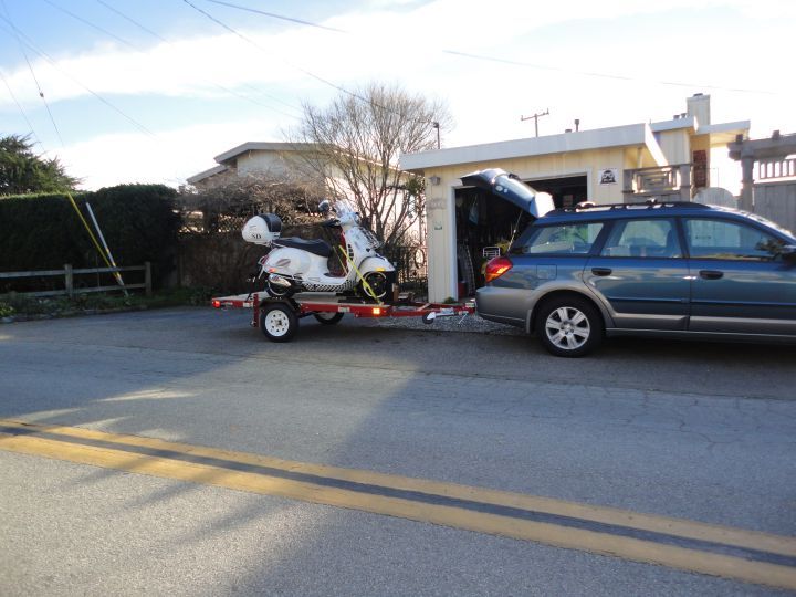

After an 85 mile freeway drive
The only coach-bolt position really needed
Home-made 'U-bolt' to stop the rear from behaving badly when upright
