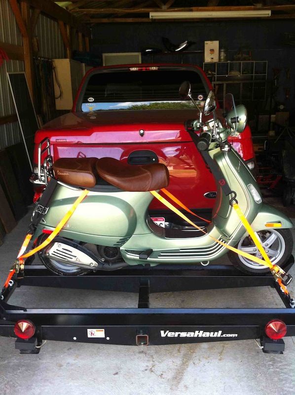

Anyone any comments on this alternative to trailers or truck beds? I really do not like riding vast distances.
This rack seems to be solidly made. The scooter rides nicely behind my Dodge Dakota.
Miss Agnes helped me load the GTS onto the Versa Haul.
Port side.
Starboard side.

I've used a variant of that carrier before. No problems to report.
I think I would tie down the rear end slightly differently, though. I would anchor closer to the attachment point of the rear rack, closer to the body, to avoid using the rack as a lever. Either that, or I would just tie the rear wheel down directly to the carrier and let the suspension do the rest.

I should use the rail that is adjacent to the seat. I tried to keep the strap away from the paint. The rear carrier seemed to work OK when the scooter was in the truck bed.
I will remove the seat cover for a 'real' trip. And probably put the pet carrier (Which is full of shtuff) in the truck bed; also have to tank fairly empty. All that to keep the weight on the rack low.
The good folks at Scoot Richmond suggested that I use ratchet straps to make the job of cranking down the front suspension a mite easier.
Someone at Amerivespa 2013 suggested additional straps from the Versa Haul, over the tailgate and to an attachment point in the truck.
I always put a twist in the strap to stop it vibrating in the airstream.

Nice looking setup. In answer to your question about adding towing lights I'd say yes. Look at it this way, they're dead simple to install since they're held in place with really strong magnets and they add a measure of safety to your package. They're also not expensive when compared to traffic tickets or the odd chance someone claims they couldn't see your lights.

Thanks for the comment.
Um, what holds down the rear end of the scooter in your setup? I do not see a strap.

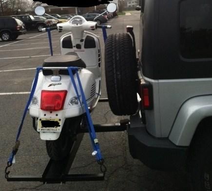

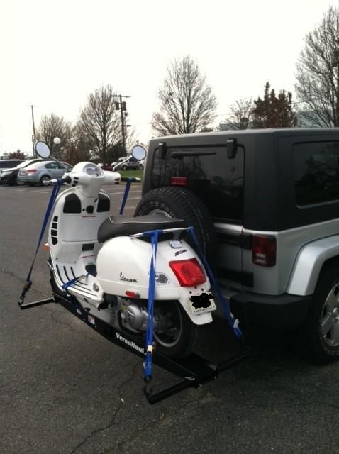

This is mine ... picture taken before putting tie-downs. Tie downs were put the same way as the members did on this board (thread)
