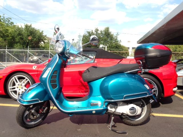

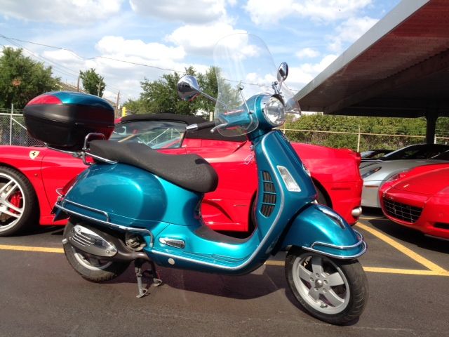

I'm considering adding rear crash bars to my GTS while it's at the shop getting repaired and repainted. Opinions on the quality of the Logoscooter , Cupertini, fa italia or Faco crash bars?

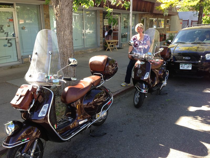

I think the OEM ones look the best. Thankfully I haven't had to test the ones on my GTV yet.
OEM crash bars on a GTV.

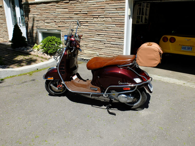

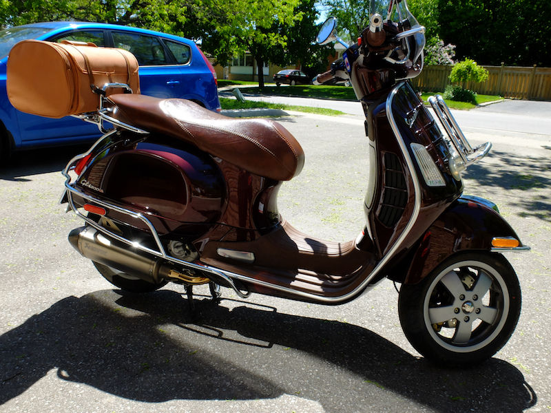

As seen on a GTS. I prefer the build of the OEM.
The Vette is feeling very lonely too :LOL:

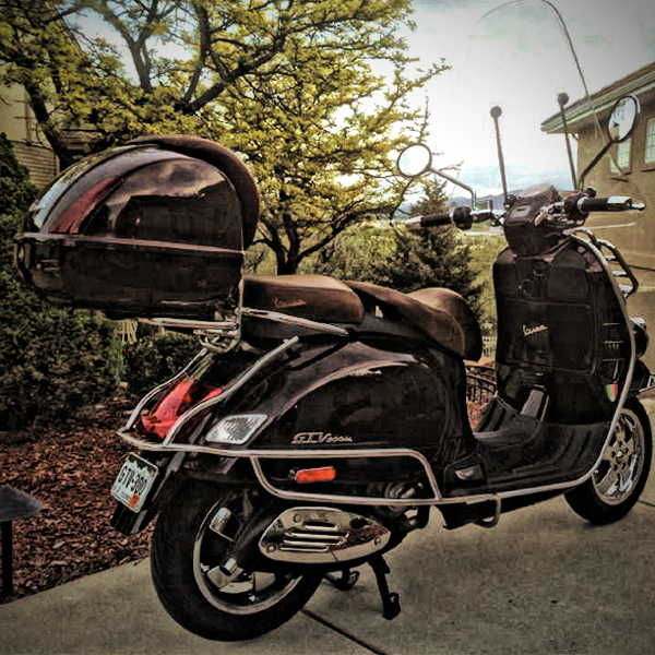

None of the OP pictures show the OEM crash bars, but I see that other owners have filled in the gaps.
My turn.

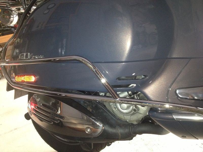

Piaggio branded here and it protected scoot completely when it when over in soft blacktop.
Posts: 39726
Posts: 39726
Yep. That version has pretty good attachment points, plus the added benefit of one side being connected to the other side via the hoop over the tail light.
