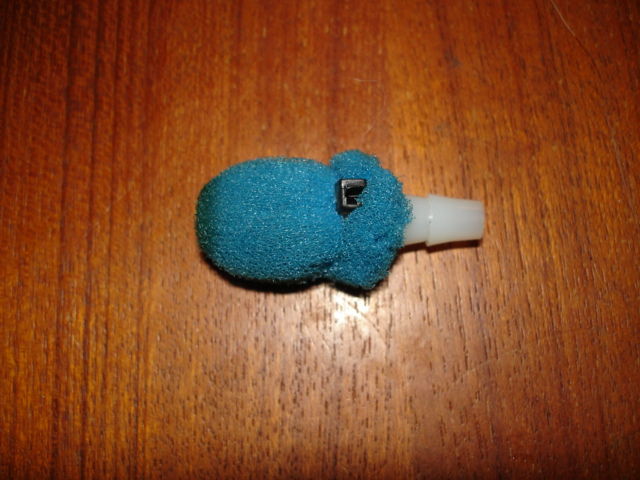

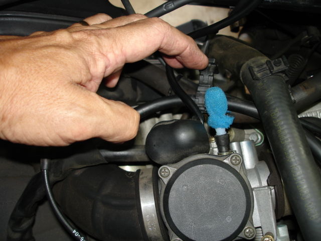

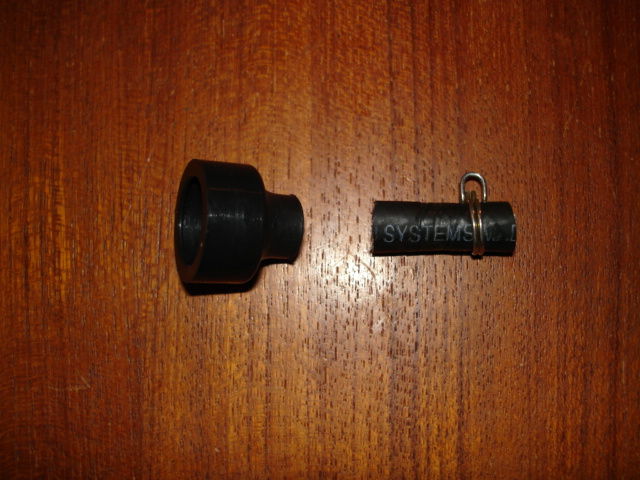

I did disconnect Evap on GT200 and decided to place a foam filter as a precautionary measure.
First was very simple, wrapping foam around plastic stem and affixing to carb.
Second (what's there right now) is a bit more involved. Picked up a foam filter disk, housing and then affixing to carb...which reminds me that I should either clean it or change it out.
Note: I cannot find the HPI housing anymore...so I opted to simply purchase similar filter material and replace as needed.
Most have opted to leave port open...without filter.
