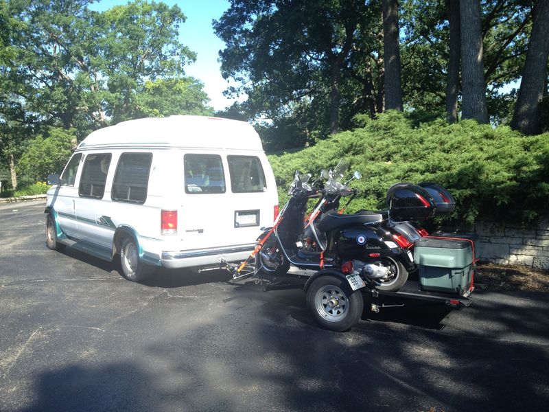

Here's a shot of our trailering fun while stopped in Chicago area to spring my 90 year old mom from assisted living to take her to Michigan...
It's a Kendon Standup trailer with 2 Harbor Freight chocks fitted on the rails. Great trailer...
Unfortunately the weather has completely sucked since we arrived. Rain, chilly, cloudy, and we're 1 block from the beach. We left Colorado's very high temps hoping they'd follow us to the lake. Oh we'll, at least the scoots are fun (and running fine again). Clown emoticon

God bless your Mom. Scoots come and go, but...
People are forever.
Wish our bodies were as easy to fix and reset as your nice scoots.
