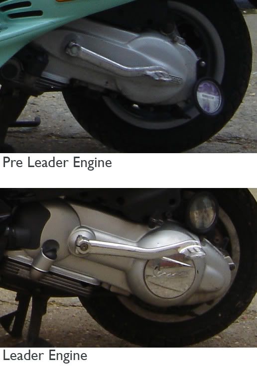

As this is an ET4 there is no chrome cap on the transmission cover... The whole cover has to come off. Nothing too difficult, but you will have to loosen the air filter to gain access to some of the screws...
Once they are ALL out you may need to tap it gently (preferably with a rubber hammer) to vibrate the locating tubes loose before it will come off. Best not to use a screwdriver in the joint!

The pre leaders don't have the chrome cap but the later leaders do, Id still take the cover off and inspect it, when was the belt and rollers last changed?
Note, the chrome cap may be a different colour

Thanks for the information. I was thinking that the ET4 was a leader engine and had the chrome cap. Good advice to take the transmission cover off to clean up the clutch mechanism and inspect the cvt. While in there, you could blow out all the dust and/or remove the clutch to score the "shoes" and bell. Nevertheless, the graunching is indicative of dust build up in the clutch bell. Humid conditions tend to accentuate these symptoms.

Actually, you could be right.
All my ET4s are pre-leader, but those made post-2000 do have the leader engine. So, if all of those have the chrome cap, it will be there...
Why on earth didn't they change the model number with the engine change!

Not to confuse the situation, but my '03 ET4 has a factory clutch cover that says Piaggio and is not the chrome Vespa one that some people are referencing...
