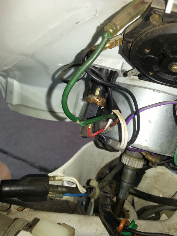

The green(ground) wire on these are notirious for their crumbling insulation. Most people just run a new one since replacing the whole wiring loom is a pain.

oh heres that damaged wire. looks like a frustrating job.

nice P. the green wires are always shit

As a short term fix you can probably use the neutral switch wire to be the kill switch. You would lose the illumination of the neutral light in the speedo, but you'd gain a kill switch until you get around to running a new one.
i might just run the new wire. my neutral light dosnt work either so il need to check that wire too probably

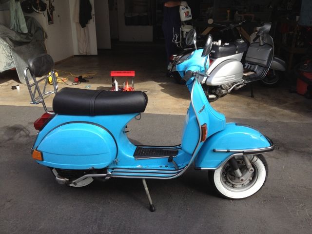

Just an added note, It looks like your rear rim is set-up wrong. It should resemble your front wheel, which is set-up right. Just a minor observation.
Is it backwards? Now that you bring it up I can see a difference. I put it back on the same way it came off...

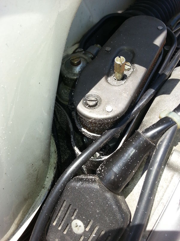

Great story & a beautiful white P. Congrats on knowing what you have and valuing it. But isn't that new B6HS you're running the wrong plug? Shouldn't it be a B7ES or B6ES? Longer reach for your fatter head, gonna run even better now!

....I thought this thing needed a short plug...shhhhhh
I'll get on that before I ride again. Im glad I mentioned the plug type I used and thank you for pointing that out.

Love it. Don't even use a B6ES - I would use a B7ES-B8ES.

yeah i got a number 7 plug. works great now haha. also i turned the rear wheel around to the correct position. handles better but its rubbing now! the sidewall is rubbing the clutch side of the engine. theres white dust all over

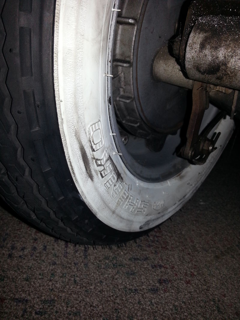

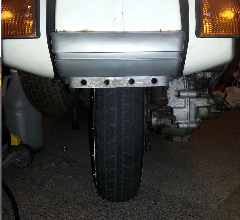

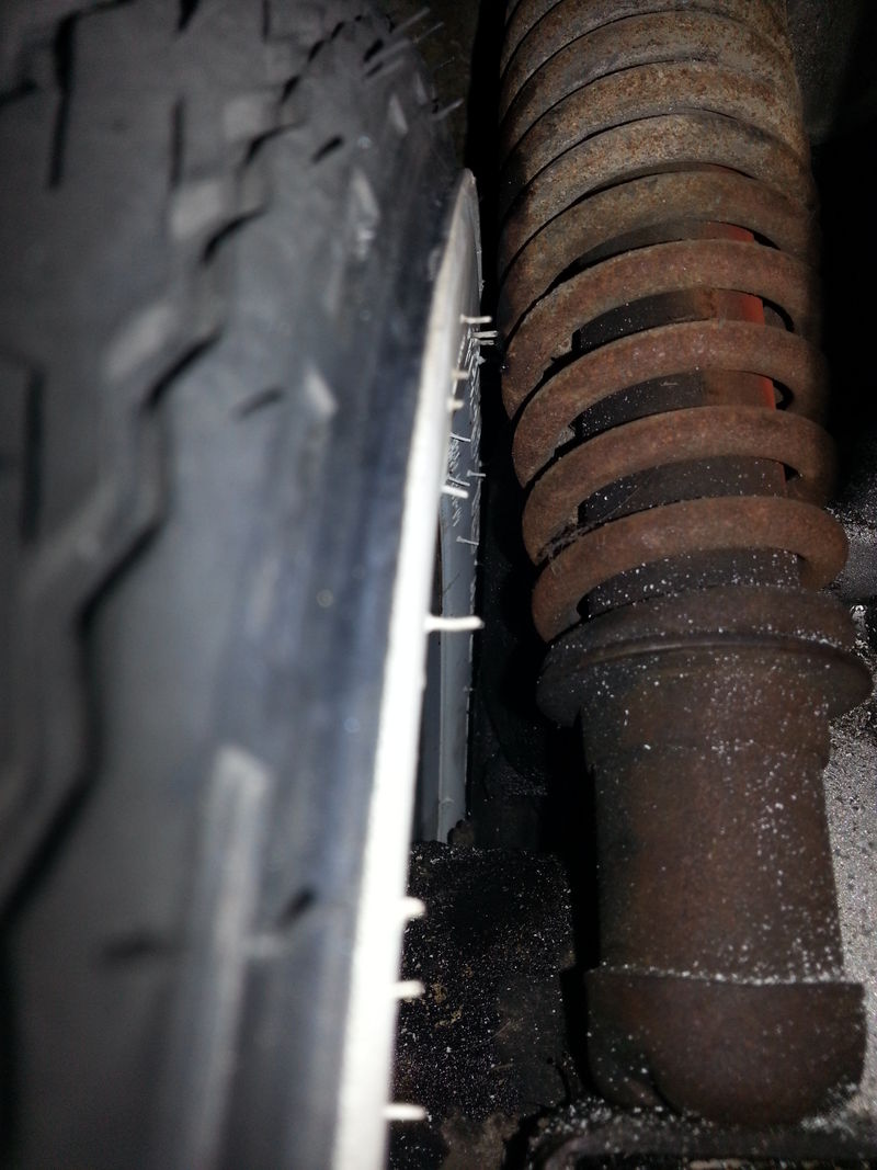

ouch. the damage on the tire isnt all the way around. looks like the wheel tilts when it spins.

That happened to mine, caused the tire to blow at 55 to 60 mph, not pleasant. I would suggest a set of new Clauss mounts. Its a PIA getting the old engine mounts out, but well worth it.

Alright, so regarding the rubbing tire...Ive found two odd things besides the possibility of bad engine mounts.
A: the tire actually measures 3-5/8" wide overall, not 3-1/2.
B: the rear hub has a tiny bit of play in it. Like if I grab the wheel and try to wiggle it, the hub lets it move maybe 1/16"
Should the hub have this amount of play? 3-5/8 is probably too wide for the tire but I think it only makes contact when the hub shifts....I dont know whats normal for these components.

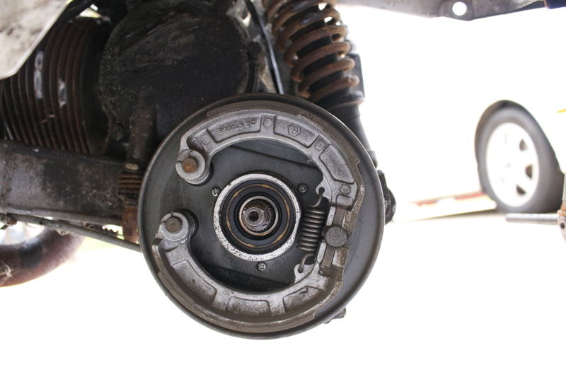

Pop the cap off your rear hub & see what's going on in there. The hub should be tight to the axle & not 'wiggling' like that. Maybe support the rear end or motor (WHOLE f'n threads on this*), take off wheel & feel for hub play with your hands if in doubt.
There was another whole thread* recently on over-fat whitewall tires that rubbed like yours both front & rear.
But DO take the BEST pic you can of your scooter square on from the rear, portrait mode and post it up for more opinion on your motor mounts BEFORE you attack them. Worn motor mounts don't tilt the wheel into the clutch cover, they just tilt the whole assembly.

The shock and engine are not tilting the wheel. The wheel is tilting with the hub. I will take the cover off and look at it tomorow. The only rubbing whitewall threads I've seen involved continental tires, which is not what I have.

This one makes me wonder about the shock.
Why do its vertical & horizontal elements appear to be SO out of square?
Your straight on rear shot is ~OK, but could be MUCH more useful in seeing the motor alignment if your shot is of the whole bike and as 'tall' as your camera allows, rather than wide.
This will help see and use the 'longest' centerline to find true vertical. The short section of white center seam isn't long enough & the separate plastic bumper doesn't count.

Don't like adding this, but please don't ride it until you see what's causing this.

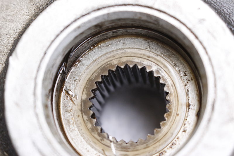

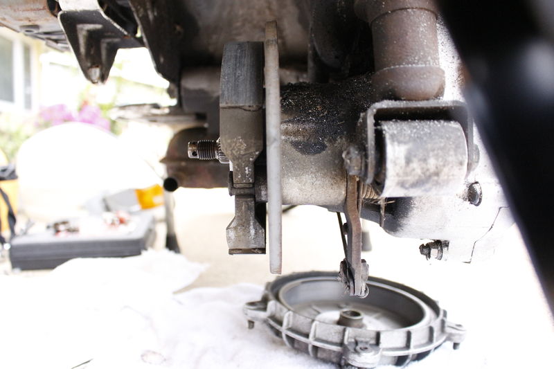

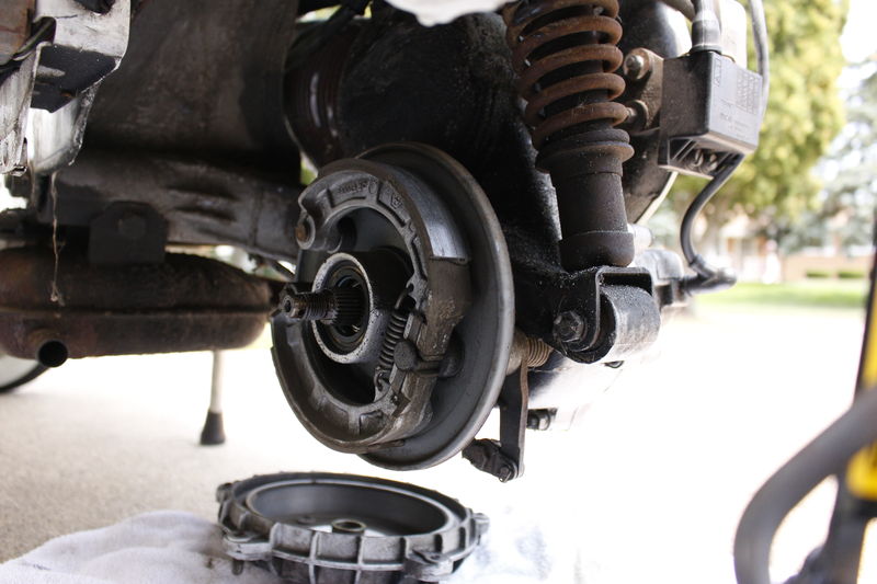

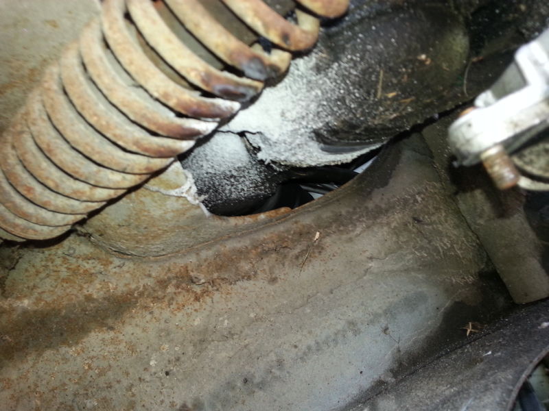

So I pulled the cap off the rear hub and pulled the cotter pin out. Low and behold...I was able to unscrew the castle nut by hand. I probably should have checked this first. I looked at everything else and tried to shake the brake drum and the shaft and all but it was all solid. I looked at the teeth on the hub cover and the shaft and they look ok to me.
I put the nut back on and tightened it has hard as I could by hand and this stopped the wiggle. I spun the hub and looked at the end and I didn't see any side to side oscillation.
I took pictures anyway. The engine has grease on it which also has bits of rubber stuck in it so it look pretty dirty. I rode around briefly today and didn't notice any new damage to the tire.
... I rode around briefly today and didn't notice any new damage to the tire.
OK now, NO more riding for you until you torque that nut up tight with tools, preferably with a torque wrench. Or as ~tight as you can~ without one.
sorry, seems to be a nasty new habit of mine...

Heads up you definitely want to torque that rear hub on TIGHT! Put a new cotter pin in too while your at it.
This link has torque values at the bottom of the page for reference.
http://www.vespamaintenance.com/specs.html
I had the same rubbing problem with a P200 I had a few years ago. Just like your dad's bike, it was a 81 P200 with Shinko whitewalls. I barely put any miles on the tires before I noticed the white rubber everywhere.
I thought it was a motor mount problem so I replaced them and then sold the P before I had a chance to see if that solved the problem. While I was changing the mounts, I used a can of brake cleaner to blast all the rubber off and de-grease the engine which made it look oh so nice!
I'm wondering if the Shinko whitewalls balloon out more than other tires and just happen to rub on the rear shock???

Hahaha OH NO when I say by hand I mean I used a wrench, just not a torque wrench. I have a torque wrench but didnt know the spec so I just wrenched it as tight as I could.
Congrats on the P200 man
Thanks for torque specs and the tip on using brake cleaner to clean it...when I reassembled everything I tried using an SOS pad which did almost nothing.
This one didnt just rub the shock, it made most of it's contact against the engine case. Even now there is a very small amount of space between the sidewall and engine/shock. Small enough that the little wiskers on the tire are brushing against those parts. The side to side movment of the hub was causing the rubbing for sure though. Like I had posted earlier, the width measures 3-5/8" which means the sidewall would only be 1/16" closer to the engine/shock side than a tire that measures 3.5". There isnt much clearance back there on any tire haha
Beautiful scooter by the way. I love that color of blue and whitewalls make everything better!! God I love whitewalls
