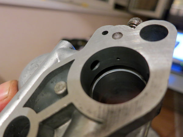

So I started inspecting the fuel pump, and the 'oil canal' on the base of the air box, and confirmed that the base gasket had the requisite oil hole in it, and that all seemed hunky-dory, and then set about cleaning the carb, and then got on Scooterhelp.com just to confirm everything. And then I started learning about the route the oil takes on its way into the carb venturi. And then I compared the Scooterhelp photo with this carb. See attached.
The red arrow points to the hole that the oil allegedly comes out of on its way into the crankcase. Note that there is no corresponding hole in my picture. I tried injecting 2T oil into the intake hole and seeing if it'd drip out anywhere else in or near the venturi / slide, and no dice.
Is it even remotely possible that this bike ran for a hundred kilometres in an unlubricated state? Because if this is a non-autolube carb, that's exactly what it did.

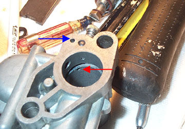

It does look like a non-injector carb. Is it a 24? Original to the bike as far as you know? I just checked 2 old 20/20Ds that seemed identical except for the additional hole into the venturi you've pointed out AND a plug where the hole was drilled from the outside, right next to the mixture screw. I would have thought the carbs would have different model numbers but BOTH are marked 20/20D and they BOTH have the blue arrow hole. Here's a pic:
carb on the right came off an autolube motor
So, maybe NO oil getting thru and you say " ...a good 10 or 15 seizures". I'd say you are a damn good detective! Clap emoticon

Hey, thanks for this. I have to talk to the owner of the bike to get a better handle on its recent history. At first I thought, nahhhhhhh, the thing wouldn't go 10 feet without any oil, but I do have a catastrophic autolube cloggin' in my past, and the bike did a good 10 km's before seizing. I wasn't certain if that was a complete oil blockage or just a fraction of it. Maybe it was the former.
Anyway, first order of business is finding out who goofed. *Somebody* did some work on this bike before the seizures began, and (I'm guessing) through sloppiness mixed up carbs and stuck a non-autolube SI 24 into this rig. I'm *hoping* it was mere sloppiness, at any rate. One thing's certain: he massively over-torqued the carb bolts. Guh!
