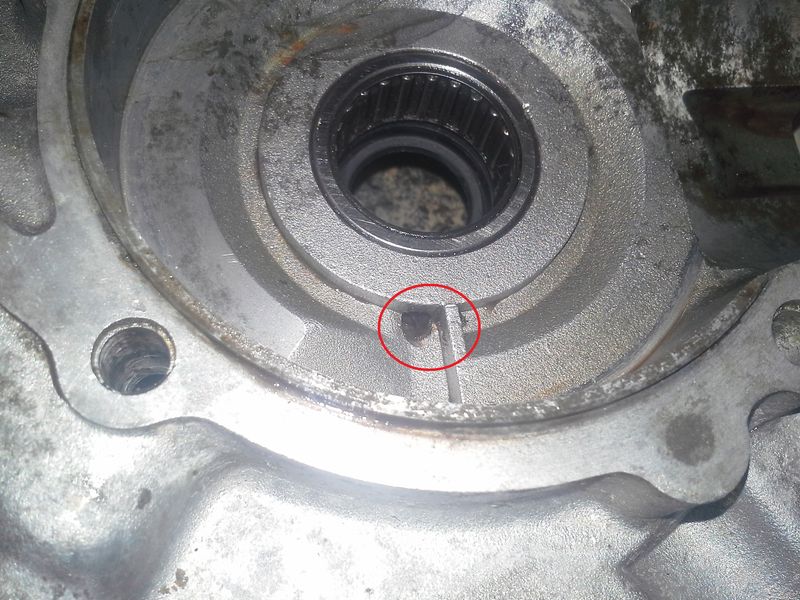

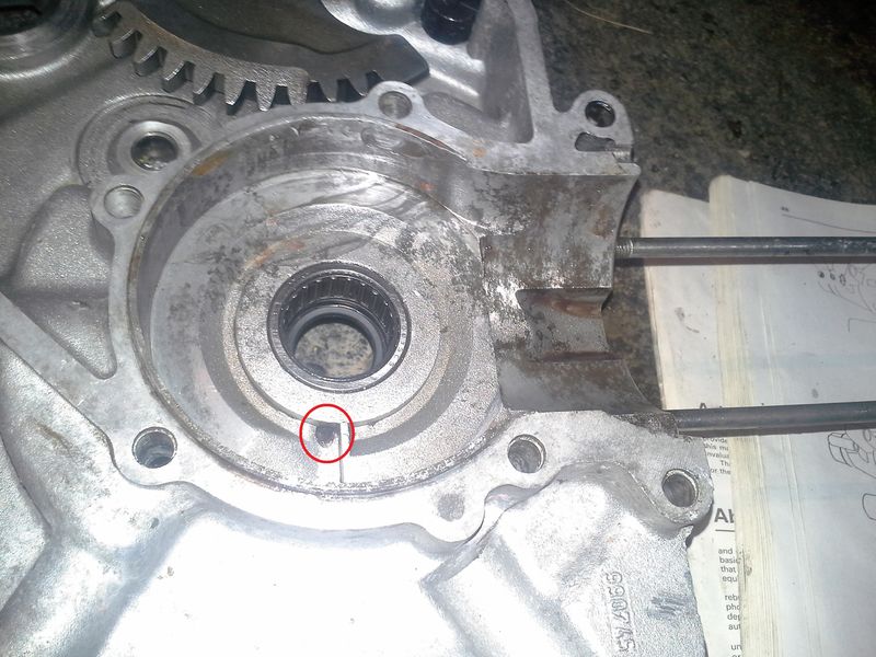

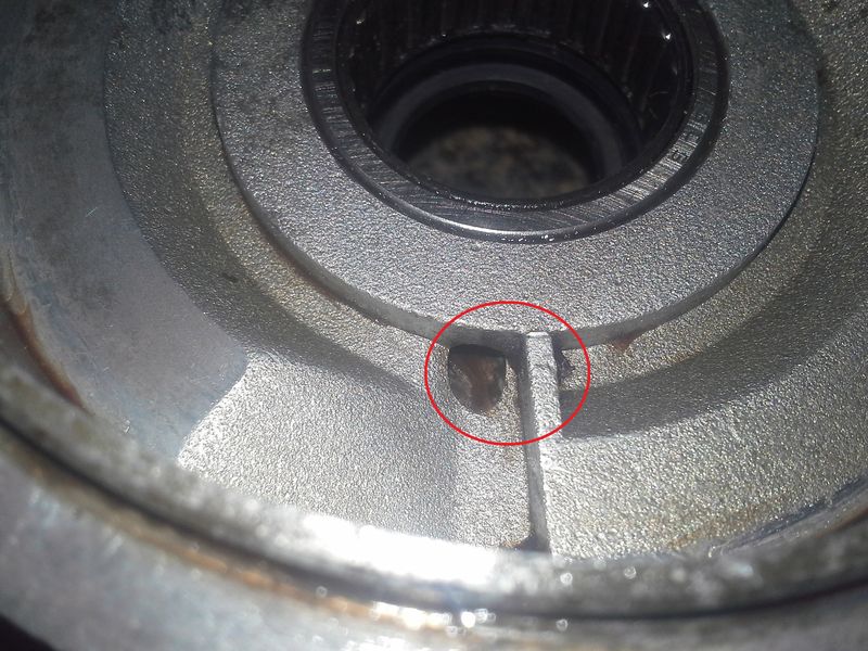

I am curious if this hole is supposed to be here...? It goes all the way into the bearing, and I'm thinking this could be why my engine was leaking everywhere....? (The oil seals all looked fine.) I can't find any diagrams of this to know whether this hole is supposed to be here or if this case is damaged....? I'm new at this stuff. Also, what kind of cleaner should I use to clean all of this gunk off with that is safe?

Yes it is. The fuel mixture comes in to the crankcase, runs down throught the hole and lubricates the bearing.
