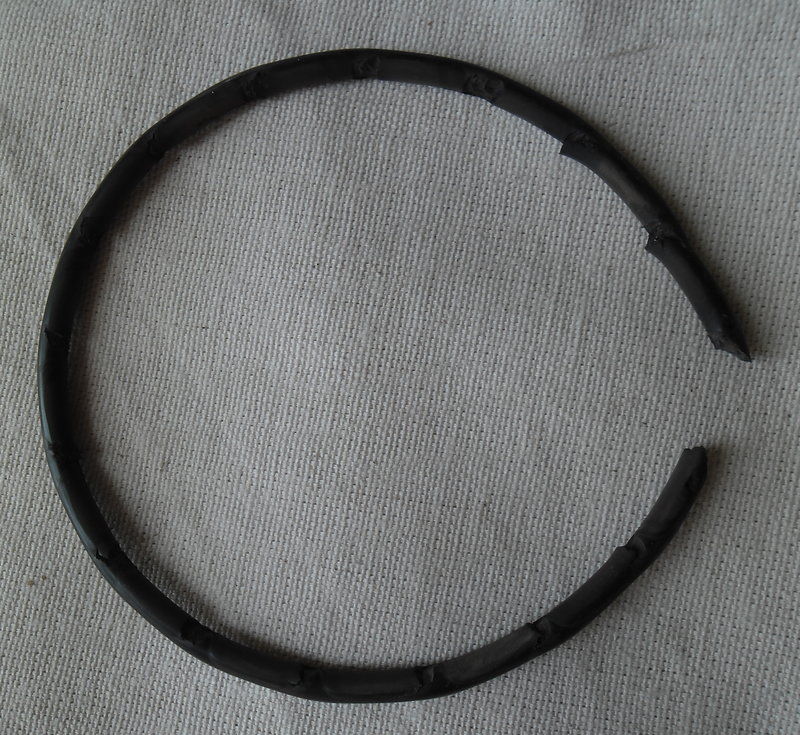

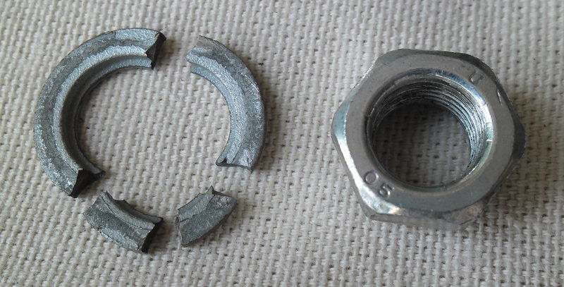

I replaced the original belt at 8,650 miles with a oem(from Scooterwest) about 3,000 miles ago so I'm not in a hurry to purchase a new one. The original had worn to approximately 19.8mm width and had no visible signs of cracks. The price of the oem has gone up since I purchased mine and was wondering if this one was really comparable.
Just FYI here are some pictures from my first belt change
Original 7 yr. old oem belt at 8,650 miles. Scooter was over 5 yrs. old and had 521 miles when I purchased it.
O-ring for variator
O-ring for variator
Variator nut
Variator nut

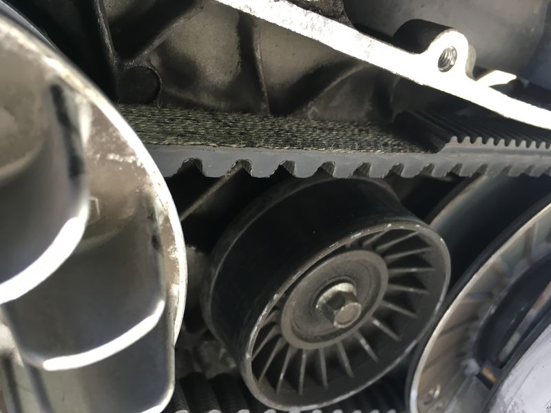

Dayco belt. 3000k until this. It came brand new with the scooter. Greek vespa service in where I've done the 30k service recommend not to go on Dayco but original.
I am a city and also long rider (3000k in a trip)....
No more aftermarket for GTS
Wow. Either OEM or Malossi on the belts IMHO. You get what you pay for, as they say. Belts have come down in price since this thread was started also. More competition between parts stores.
