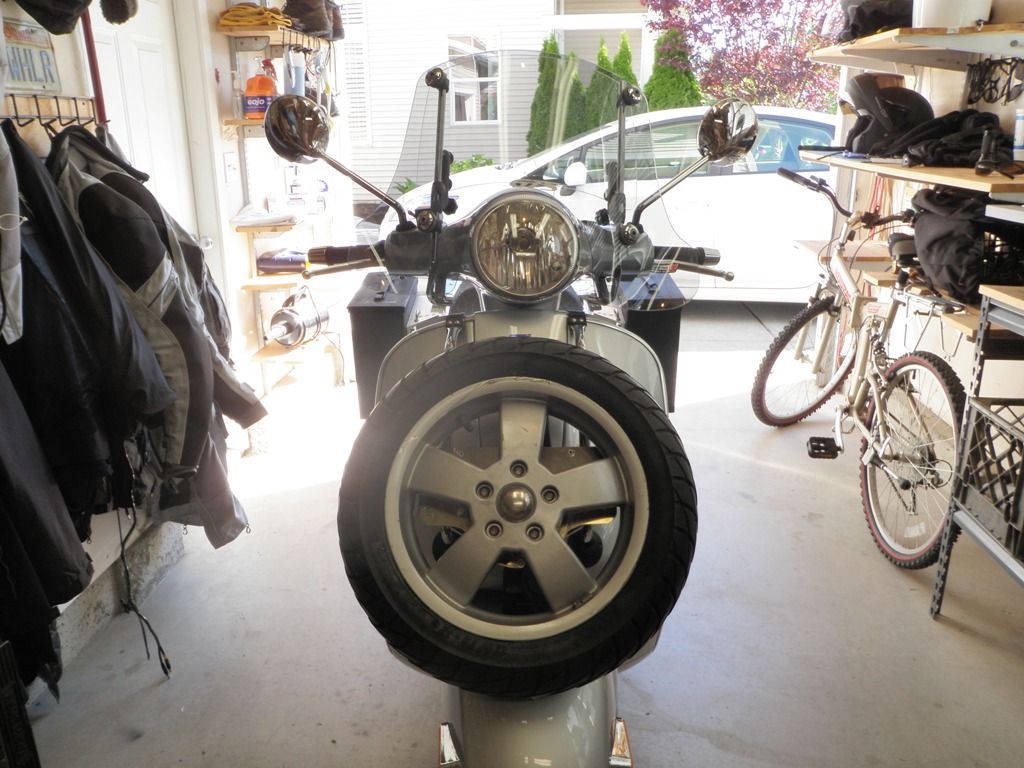

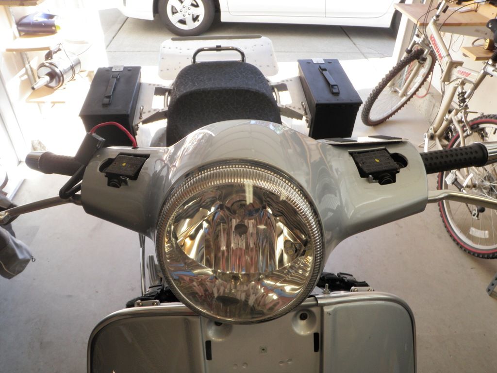

Enclosed are a few shots taken to add forward facing LED's to my Vespa GTS 250ie. The aux turn signals are needed because blockage of the OEM turn signals occurs with a spare tire/wheel mounted. I opted for LED turn signals and will tap into the turn signal aux panel. Thanks to member Bommes for pointing out this issue.
spare tire thread can be seen here:
Spare tire carrier on a Vespa GTS step-by-step walk thru
The aux panel thread can be found here:
Vespa GTS electrical accessory panel install step-by-step
Turn signal beeper thread can be found here:
Vespa 250 Turn signal beeper Step-by-Step
turn signal blockage with spare tire mounted

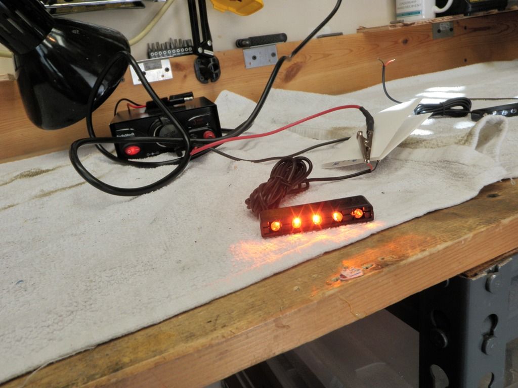

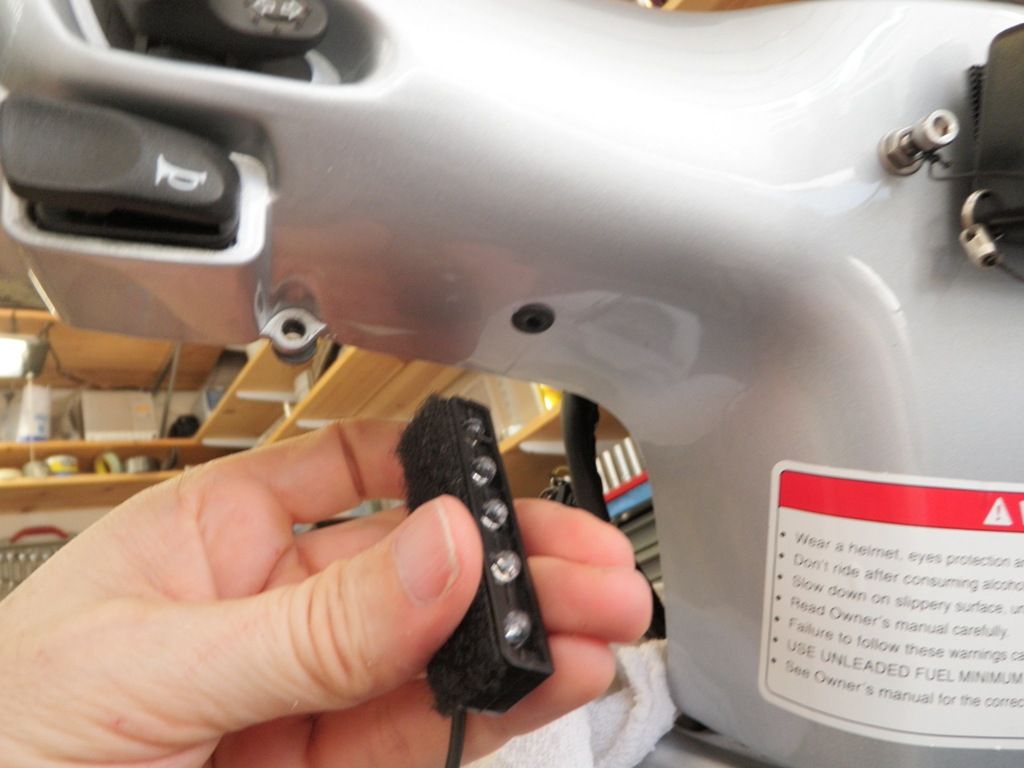

LED waterproof turn signals bench check, make sure they fire-up

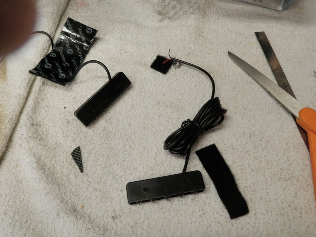

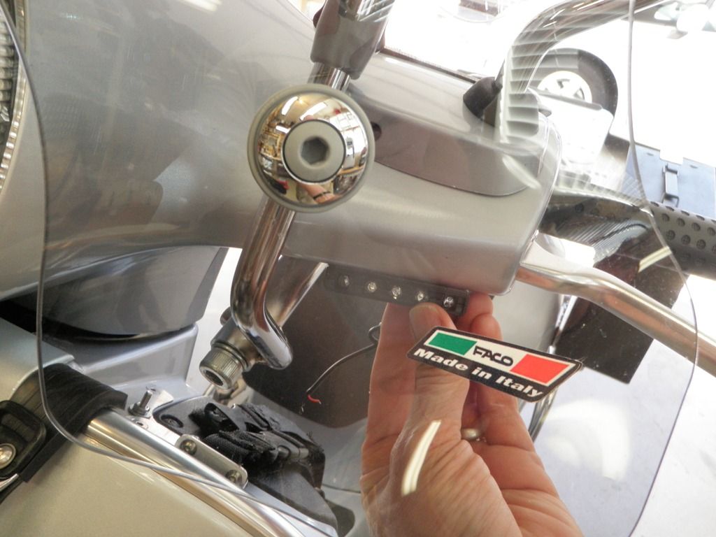

will mount here, under handle bar faring. Will attach with adhesive back velcro
remove forward faring face
velcro attach and mark location for turn signal wire

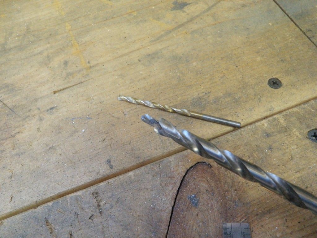

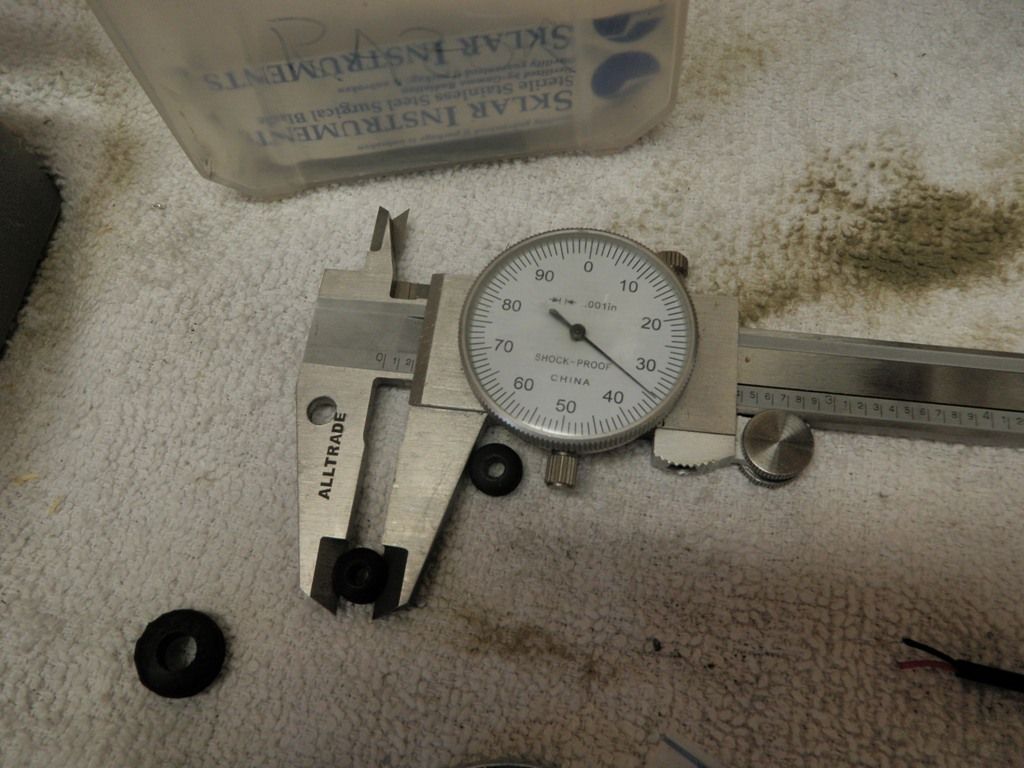

will thread wires thru weather seal rubber grommet, pick smallest size that the wire will fit thru
measure minor diameter
goto drill bit bin

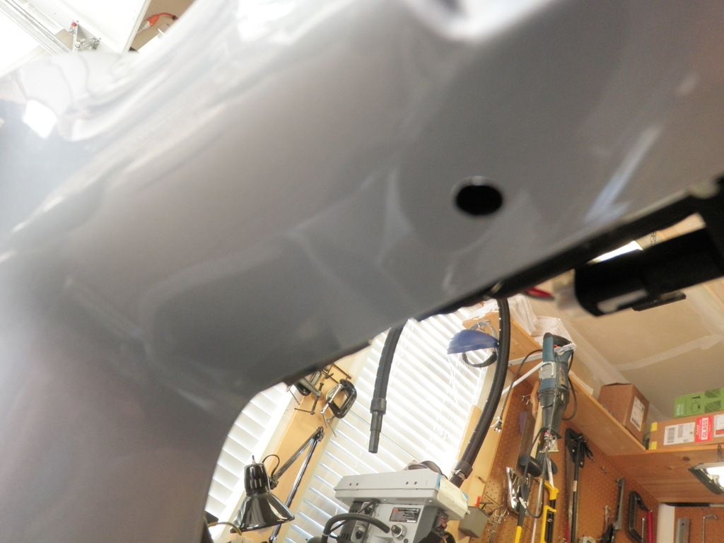

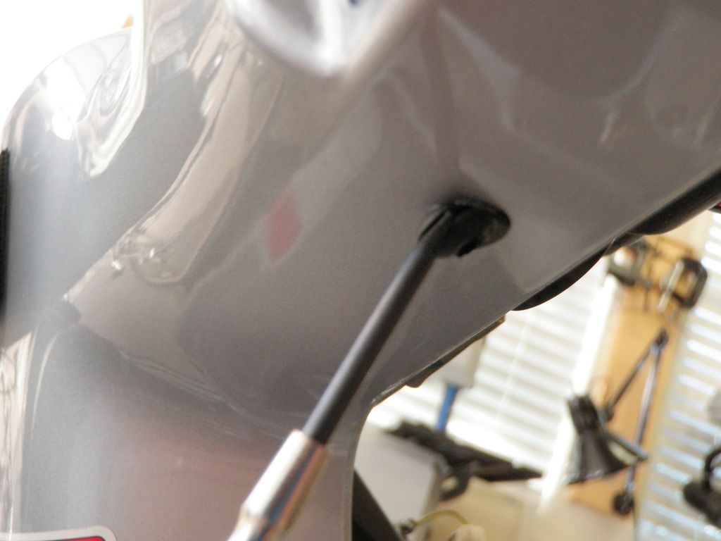

use step drill process (pilot type drill) thru faring
hole to accept grommet
work grommet in with small screw driver
ready to accept wire

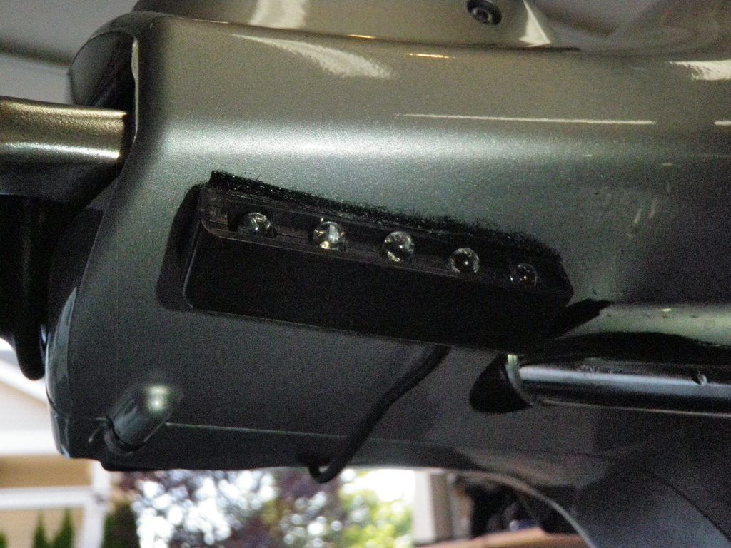

velcro the LED strip
fast forward, skipping wiring step
underside view

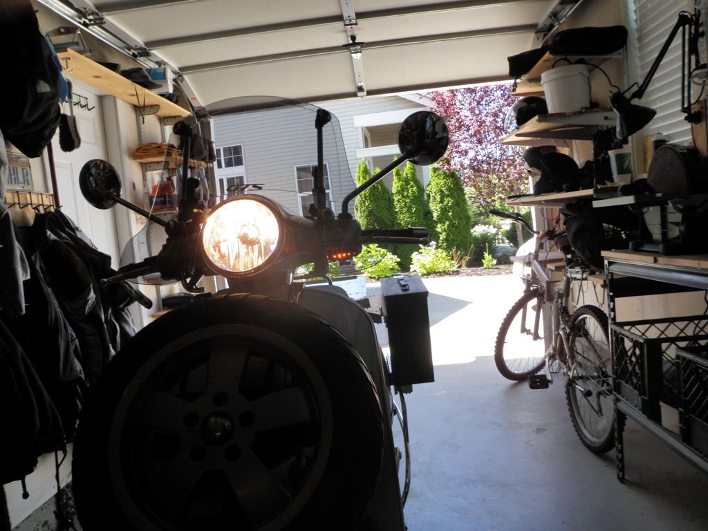

tried to catch turn signal on with camera
Review and observations:
1. pretty easy install
2. provides turn signal visibility as intended
3. Not as bright as OEM, but well sufficient. pictures do not capture apparent brightness
4. Moves with handle bars
Enjoy!

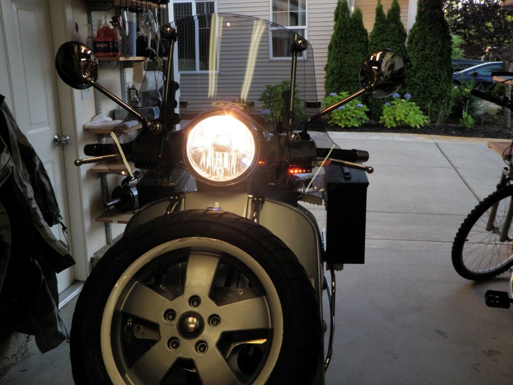

here are a couple of additional shots of the aux lights in action:
front view
offset view

Looks good.
Coups be a nice way to add running lights as well.

nice work! where did you buy the lights from? I really like the looks of the frame with no turn lights (like the vintage ones) so I was thinking of painting them the same as frame color (black) and adding leds in a diffent place
Here they are from ebay:
http://www.ebay.com/itm/Motorcycle-TURN-Signals-Blinkers-Rear-Peg-Front-Black-LED-Flush-Bike-Standard-g-/121145647072?pt=Motorcycles_Parts_Accessories&hash=item1c34d7dfe0
Motorcycle TURN Signals Blinkers Rear Peg Front Black LED Flush Bike Standard g
Hope this helps!
