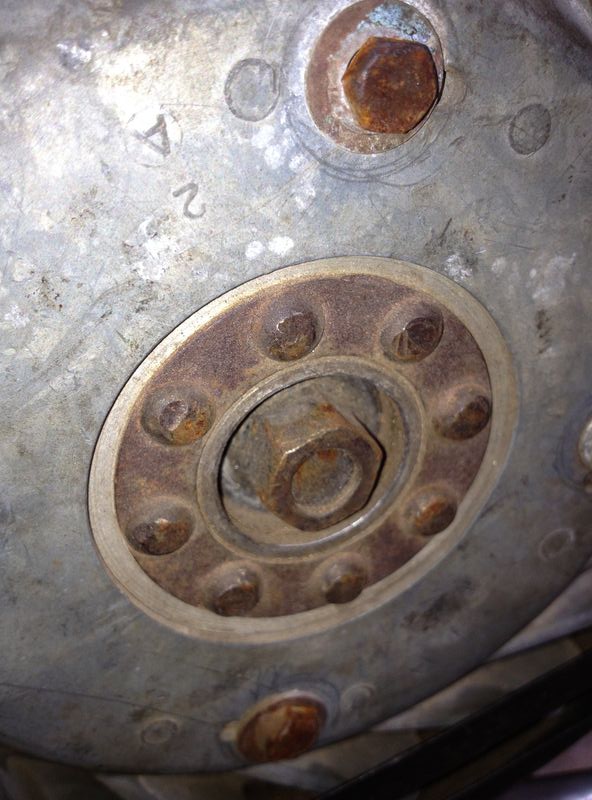

I was reading a couple of posts about pulling the flywheel on a VBA, and it mentions using the nut pushing against the circlip to get it off. How to remove Flywheel without special flywheel tool
I looked at mine and apparently there is no circlip. I see a groove in there so I assume that's where the clip goes.
Can I pull it without the help of the circlip, or will it be easier with the circlip?
Can I buy that size circlip anywhere or will I need to order it?
Thanks.

If you loosen the nut (don't take it off) and then hammer on the end of it it should free the taper.
BUT
There's a small chance you could damage the bearings or possibly even the cases so I probably wouldn't do this unless absolutely necessary.
Measure the internal diameter where the circlip seats and you should be able to get an internal circlip from a bearing/engineering shop.

For god's sake get the correct cir-clip. I know this means waiting, but it is the right thing to do.
You should be able to get one at any decent hardware store. I wouldn't worry about metric vs standard. The most important thing is making sure the cir-clip is beefy enough to take the pressure. Most of the generic cir-clips froma hardware store will be too thin metal and will twist out and get chewed up by the flywheel nut. So you'll have to get the right one.
Find someone with a VBB/Sprint and use theirs.

If it's being stubborn:
1) put some penetrant behind the nut.
2) heat flywheel hub.
3) when you have lots of pressure against the snapring(starting to bulge), give a couple sharp raps with a center punch in the dimple on the crank end. Small to medium hammer, easy does it - no mashed threads on crank this way. Turn the nut a bit & repeat as needed. Should pop right off now.
Speaking of snap rings, be sure to clean the corners of the groove well and install snapring with sharp edge facing out. If I'm using an old one I like to stretch it out a little so it's good & tight in the groove.
If it's being REAL stubborn PM me, I know a few other unapproved trix that have worked.
