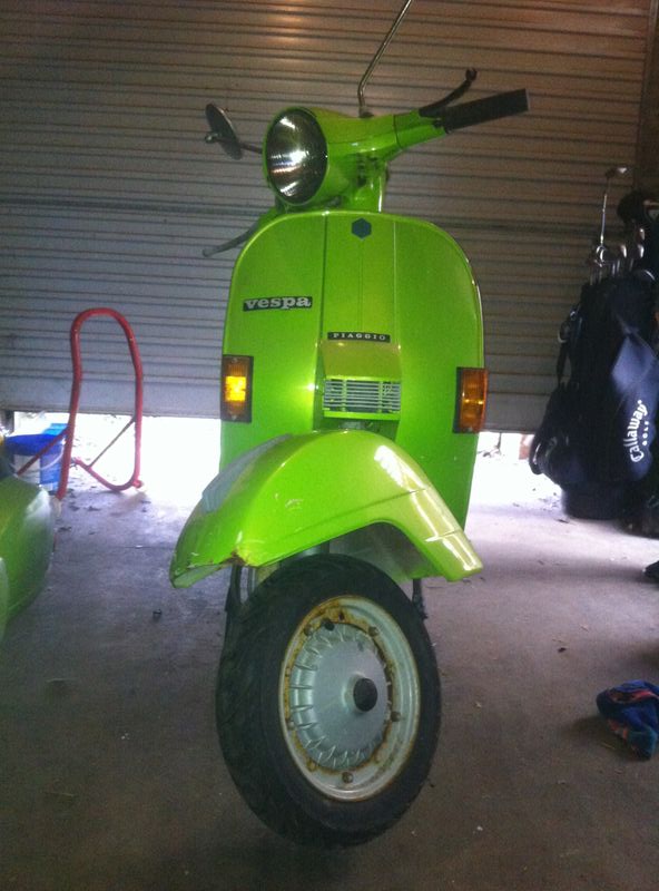

It's done about 20000k's I think it has just sat in a warehouse for a really long time without being touched. So much so that the tyres were flat and the front wheel is rusty. It has some rust as well but that's another future thread.
I'm just guessing that there could be some corrosion to the pick up or something along those lines. Ill know soon enough. Well when I get the puller that is.
I don't know anyone with a px200 so I can't swap the CDI to test. I could take it down to the local shop but I usually do all labour myself to save coin.
I attempted to attach a photo of the wasp in question. It's obviously been repainted. From that reddish maroon Colour.

Wow that's bright.Man if that wheel got that from sitting ,who knows what tiny bit needs cleaned up.Good news is there's only so many to check.
