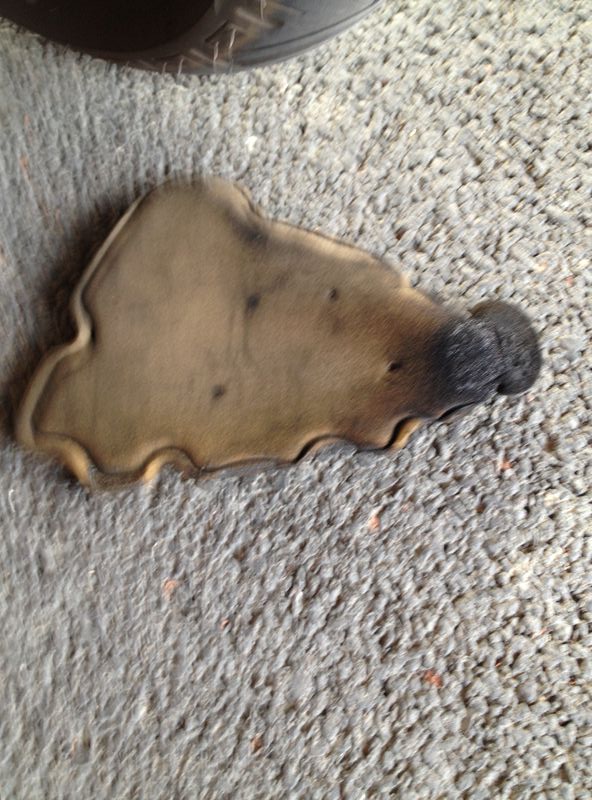

Anyway there's some pictures attached, ones of my air filer, looks worse for wear and has a fair bit of oil in it, would this be a major issue or just a replacement?

Here's the air filter

If the air filter doesn't clean up easily, spring for a new one. They aren't that expensive. I think Malossi makes a performance filter that lets a bit more air in... but OEM is fine too.

That's normal for an air filter - mine have been a lot filthier than that! Just clean it and all should be good.
To clean, just pour some petrol in a zip-lock bag, squidge it around, empty, add a 50:50 mix petrol and oil (engine oil is fine, though arguably not the very best stuff to use), squidge, remove, squeeze dryish, allow the petrol to mostly evaporate then install.

As for the filter, it's cheap enough to replace if it appears damaged at the gunked up end. I don't know the position of the filter in the ET, but if it slants to the gunky end the oil (added to the filter) could have made its way to the corner and that's why it appears extra black. The rest of the filter looks dry.
If the filter is okay, I'd wash it out with a detergent or Simple Green, let it dry a full day and oil it up with a gas/oil mix (50:50) or use a spray can of filter oil. It might be a good idea to get a second filter anyway, and have it clean and oiled, saved in a Ziploc type bag ready to go next time you clean your filter. Then prep the dirty one and be ready for the next service.

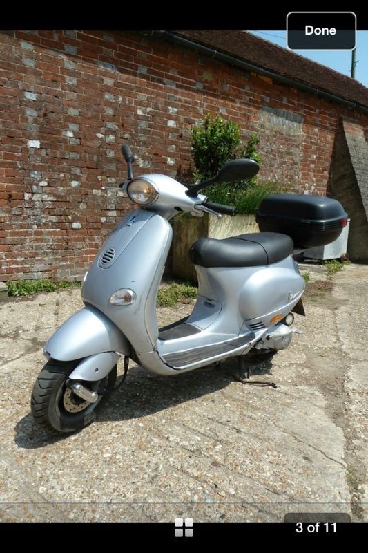

Thanks for all the replies, just dropped past my local mechanic, priced up a new filter, cheap enough so I've gone ahead and ordered one, along with a new belt and some standard rollers! It's all so cheap compared to my previous rides, can't complain! I'm going to clean up the old one too as advised for the next service, doesn't look in too bad a shape. The picture may not show it but the little scoot is quite battered externally, I'm more focused on it running right than cosmetics.

Great looking scoot!
