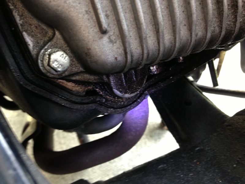

Hi, recently got my first ever scooter... A 2006 Vespa LX125.
I've noticed that there seems to be an oil leak with a drip coming down a rubber pipe. It's not fast as it never leaves a spot on the floor even over night, I've attached a pic. Any ideas?
Many thanks[/img]

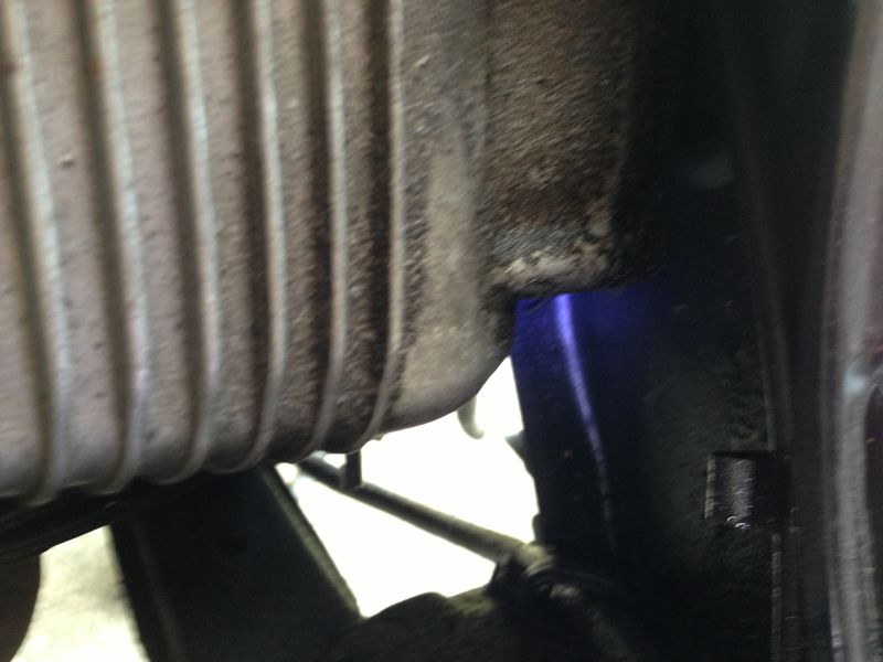

Another pic

Took the little cover off behind the foot rests and pretty sure it's coming from this area, also looking underneath from the left (sidestand) there's a cover with 4 bolts and one of the lower ones has oil on. Will it just be a gasket or maybe tighten up the bolts ?

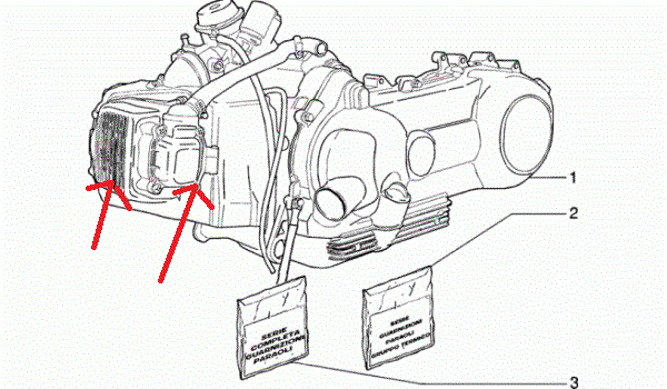

The cover with 4 bolts is on the right of this pic

See if 4 bolts are tight .If there tight then you need a new gasket Crying or Very sad emoticon

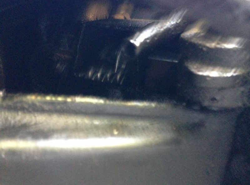

These are the areas I can see oil coming from
Would this be a big job to fix?

Mudnman wrote:
If that's 4t could be leaking at valve cover.See if 4 bolts are tight on top of motor
which 4 bolts do you mean?
Thanks for reply

By your right arrow,or the valve cover bolts.Are they loose?
valve cover as in my left arrow?
07 LX50
Posts: 1977
07 LX50
Posts: 1977
Yup

Hey don't over tighten them,just tight.

Couldn't really get at all of the bolts but the ones I could are tight. I've booked my local bike workshop to have a look Friday but I'm wondering if its worth it, overnight it leaves nothing on my drive, and left for 24 hours it left one drop on the drive. What do you guys think?
07 LX50
Posts: 1977
07 LX50
Posts: 1977
If yah got the coin let them fix it.If not keep an eye on oil level.

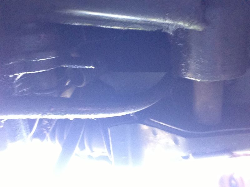

I seem to have this leak again, and its not the rocker gasket
,its a constant drip forming on one of the three thin hoses that hang down underneath the bike, what are these rubber hoses?

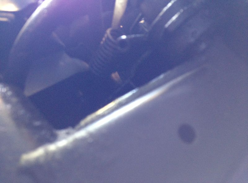

It's making a mess of the hose that runs from left to right in pic 3 underneath it

Any ideas? I really can't tell where it's coming from. It seems to be from the carb vent hose but there's also oil covering this hose for about two inches from the tip.. Could it just be blowing up with the air while riding?
Could this also explain why the oils being blown around this area? I've had a torch up under and looked directly above the carb vent hose and it's dry so can only think it's actually coming from the hose and being blown around ...

I'd clean every thing up and then look where it's coming from.Run a little bit and look ,repeat until found .
