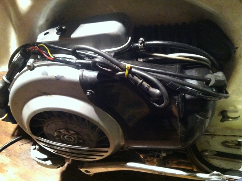

Ok last question I am almost done just reconnecting all the electrical and exhaust now. How important is adding oil to the fuel now. I have almost a full tank and I'm worried about it getting too lean with the extra oil. So I guess my question is how long does it take for the oil pump to prime? I hooked up a tube to the oil intake pipe and squeezed oil in until the pipe was full and I made sure the oil line was dripping. The last time the carb was off I am pretty sure there was oil to the carb. If I run it at idle on the stand for a good while before I put a load on the engine shouldn't it be fine? What do you guys think?
Oh I put assembly grease on all the bearings and slob reed oil on everything in there. Also the motor has been turned over many times since the oil pump was back on and filled

Well I went ahead and premixed and SHE LIVES!!!!!!!
Ran her till warm on the stand then shut her down for awhile. Tuned the carb a bit and set the idle after I warmed her again then in between freakin down pours ran her about three miles and she does just fine. I have built a couple engines before but this is the first one I have ever built for me. Feels good. Anyway time to check nuts, bolts and align my dots. Life is good and I scoot to work tomorrow

Rode in to work this morning and I am astonished at the difference. The engine is like night and day. She idles now no problem even when cold. It is so even and smooth now throughout the rev range. The last build either got some crap into it from running filterless or it was just poorly done. A stock cylinder with 20 miles on it shouldn't make more power and have better compression than the kit did right?? It does. Anyway my cheeks hurt from the grinning on the way in this morning...
This is the reason I never let anyone touch my bikes but me. Unfortunately the replacement of the bits on the shifter box didn't settle the gear jumping issue so I will order shims and a cruciform and get that sorted next week. Now that I've done it once the case splitting should be a snap. This little engine is well designed and easy to work on... Anyway
