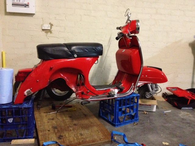

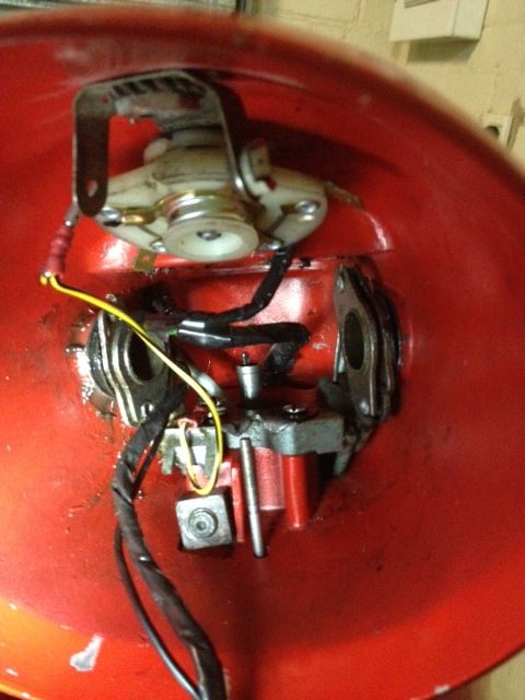

OK, so we've started the basic prep stuff and will drop and split Friday or Saturday. Hopefully Friday.
Everything is pretty much disconnected (Cables, Electrics etc). I decided to remove the Carb as I wanted to do the rebuild on this in the next day or so whilst we wait to get the Engine off.
The Oil was drained and I was surprised, well, maybe not surprised, but noticed there was a lot of black muck (carbon I presume?) and some petrol amongst the oil that came out. The oil was only filled about 3 months back following shipping from the UK and has not be ridden too much yet (maybe 200 miles). I guess this is a pretty good indication that splitting the case will provide the extra benefit of replacing all the seals?!
As My head was filthy a few weeks ago when I "decoked' it I'm presuming that may be a cause of some of the black muck? I have no idea. I know I was very careful when i decoked to prevent anything being left behind. Anally careful!
Curious as to what to expect when the cases are split!

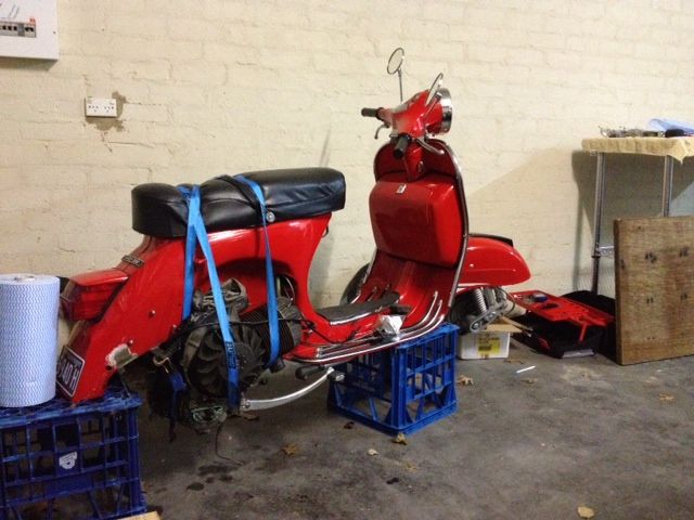

All set for the drop, and then the catcher (or protector of the engine) shot through to a sick wife. Sigh.
Soooo, the ties have it now. I'm pretty sure we're all secure and the engine wont be going anywhere without some careful loosening.

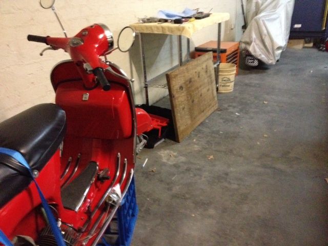

The goodies are all here. Brakes, Shocks, Pinasco kit, exhaust, clutch plates and bush, t5 4th, cruciform and other bits and bobs to see us through. Hopefully we are all set to go. 8)
The side of the garage that ends up being scooter central
Strapped up engine to try and do the one-man drop. Perhaps I wait for 14 year old son to be the engine catcher tomorrow!

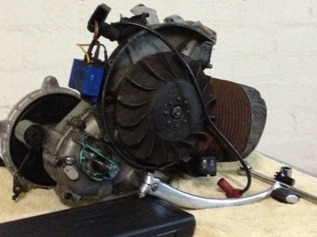

We have done "some" of the work today.
Firstly, the bastard clutch nut finally moved and loosened. I've had a bit of an issue with the clutch jumping on first and fine the rest of the time. the cork plates are pretty black, but the bush and main components all seemed good. I'll still replace the bush, springs and of course the plates and rebuild in the next few days as other things progress. I presume rebuilding the clutch after doing the normal soaking in oil etc is fine if it is a week or two before the bike is back together? I cannot see that anything would go amiss.
The flywheel etc is off. I do have a question on the stator. I have not "removed" it and have it still connected on the wires, mainly cos I am a tad uncomfortable with play about with anything "electrical". If we keep it out of harms way is that Ok? Or should I bite the bullet and get it off completely?
Everything else is off for the main part, and I'll split in the morning. Noticed a weird looking part of the case at the top of the case where the cylinder sits (see below). The case "looks" like it was put on not straight, but the numbers seem to line up ok and the bottom of the case looks OK. Is this normal?? It looks odd, although I guess the cylinder and gasket are across that area and so I should be sealed ok.
I am glad I order the Pinasco as the piston looks to have seen better days. And the cylinder was a bit grimy as well. I leave that for Scooter labs to sort.
So tomorrow, we'll split and then tackle the 4th gear, cruciform, brakes and shocks. I hope. I'm rubbish at remembering to take photos unless I have a question, but I'll make sure I have more tomorrow.
I was going to put in a new front suspension spring as it never felt stiff enough when I rode the bike before. Is this an easy job? Having cursed the design of the rear suspension top nut and needing go-go gadget fingers to do anything around there, I'm hesitant to do too much there as I can find sfa about removing and replacing the spring anywhere.
Glad I had young sir about here to help. I love the fact that I have an almost 14year old getting in to the whole engine / scooter thing.

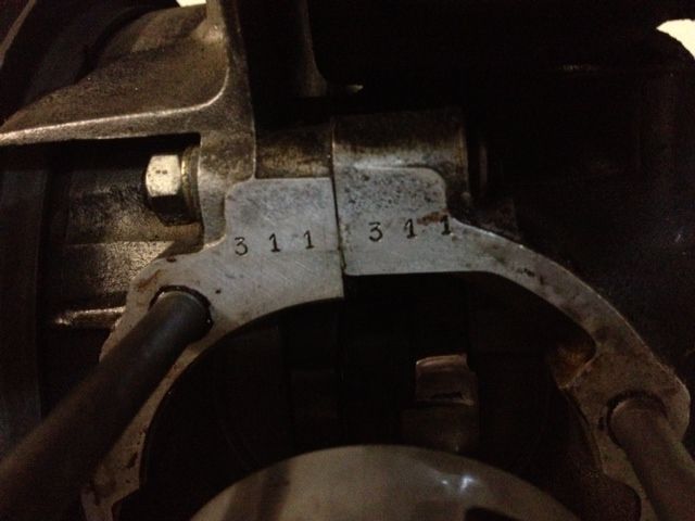

See how odd the join looks
Yet, down the bottom (sorry it is a crap shot) the joins look pretty much spot on. Should I be worried? Afraid? Or just curious?

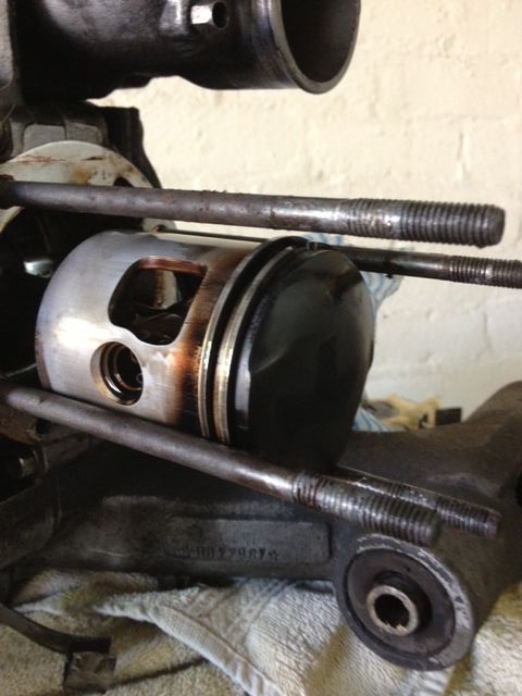

There was a few bits of gritty 'stuff' on the piston and cylinder, and the piston looks like it has been used pretty hard. As I said earlier, The Pinasco will be a vast improvement I think.

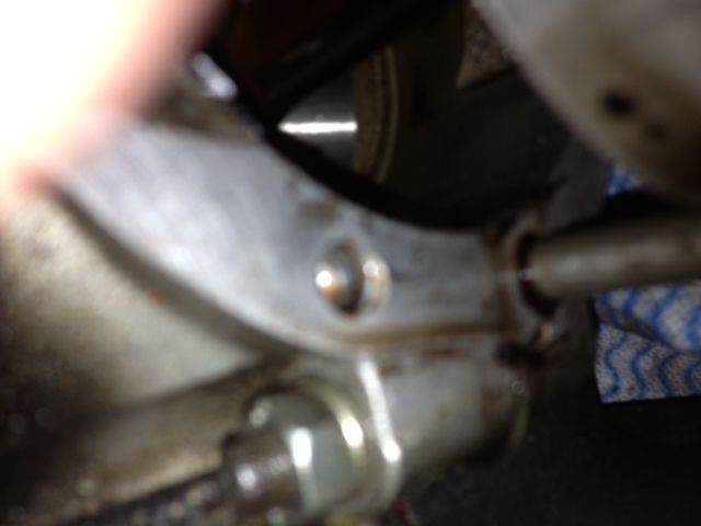

Another picture of the case. Clearer.

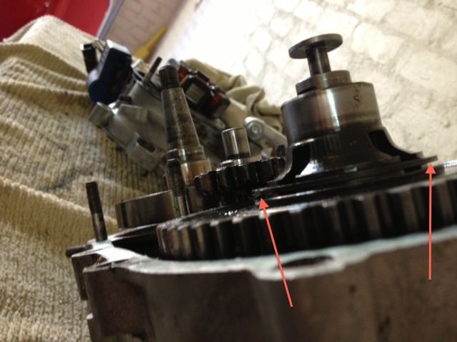

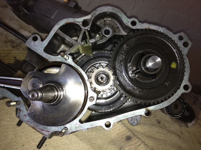

So, the gear side of the engine following the split. Everything looks OK from what I can tell. I did find more jiggle in the gears than I expected, but figured I was changing the 4th anyway and would see what it was like afterwards. I SHOULD have gone out

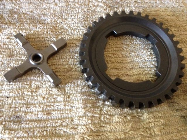

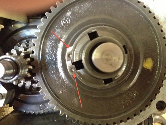

This is what started this project I guess, the wish for the t5 4th and the new cruciform to try and stop 3rd jumping

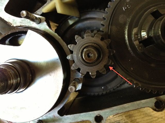

The pinion apparently usually falls out, but, not in this case, first bit to go to allow access to the gear stack

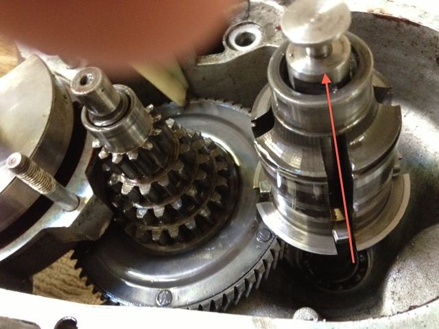

Next we get the circlip and shim washer off. As mentioned earlier and in a separate post in NSM, I should have got the second feeler gauge and checked the gap then and there. It definitely "felt" a bit more jiggly than I expected

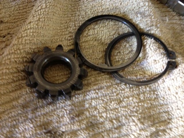

And here they are.
And here they are.

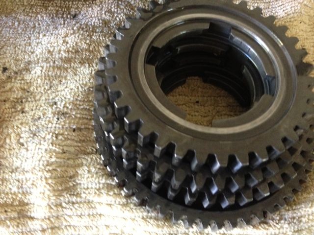

I should have used the grease pencil or something similar, but instead just stacked the gears as they came off in a way I would remember.

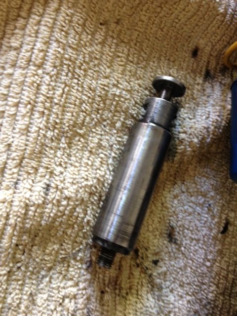

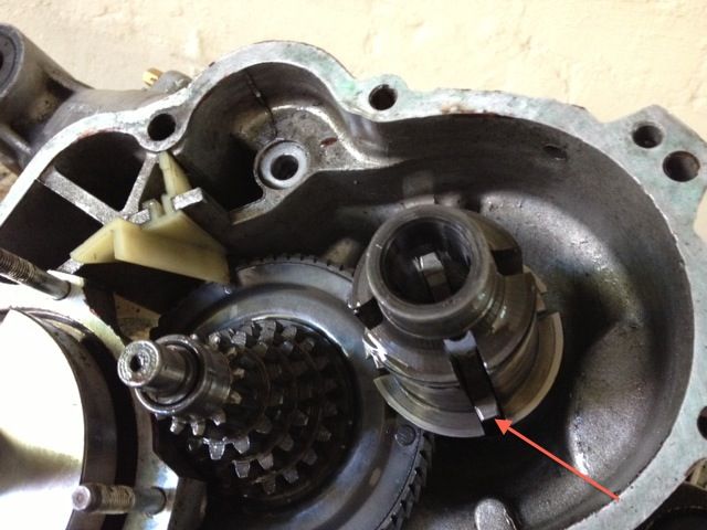

Next to come off is the Selector Rod. This was very tight and I have to admit I was concerned that the pressure I need to exert to get the bastard to move was greater than I expected, but I did it as carefully as I could. From memory it was a 13mm spanner
The Selector Rod and the washer all intact. Next step the Cruciform
This came out easily, but when I was putting the replacement in it seemed more fiddly. Not sure why. could be the slight wearing of the old cruciform? Anyway, I jiggled around a bit and in it popped.
This is the gap I looked closer at following the replacement cruciform and 4th gear. (remember to make sure the gears are correctly placed for the Criciform as well, I almost forgot to do that and as I looked down at my lack of handiwork, noticed and quic

Nice work mate and cool photos. Good luck with it.

I really hope that you are going to use a long stroke crank with the pinasco kit. Youll also need to buy/machine another head if you have the old style pinasco head.
Good luck with your project.

That kit is a dog with the stock stroke crank. It was designed for a 60mm stroke.
The cases are supposed to be like that with the lip.

Thanks travis. I did hear about the weirdness on the case, but was still surprised when I first saw it. glad to get second confirmation.
I keep reading / hearing different things on the Pinasco. We'll see how it performs first up with the standard crank, matched ports and the Worb5 head. There seems to be so much about this kit, some folk saying it needs the 60mm crank, some that it is fine on the standard as long as ports are matched and the head is corrected, and some that it depends on which version of the kit you have. I'm just keen to get the bike back on the road. Spring is coming, winter has been quite mild and some good riding days have soared by whilst the bike is in pieces.

Whilst the case is off having ports matched and I wait on some needed bits to arrive I figured I should have a squizz at the speedo and cable as it has never worked since I got the bike.
I think I can see why after having just a cursory look at the lack of attachment to the speedo gear.
So, it looks like the cable was there, but nothing was attached to anything. I ordered a new one, and will try and do the replacement business before I fly out on Sunday. I did have a stupid question though, given that what I had in my set-up was so minimal, the new cable comes with bits and bobs loose, and a connection at one end on the cable already. I'm presuming the existing connection is for the speedo, and the bits and bobs that are not on the cable yet go on the end to be attached to the speedo gear??? Or have I got that completely wrong?
Thanks
Not a lot of inner here
and no connection to the speedo either. No wonder it popped out so easy after unscrewing it...
but we did find time to locate something to put the stereo on finally. Now to get that restored too. At least my turntable will have a home soon. Probably about the time the rally gets back on the road

Sounds right about the cable. One end screws into the bottom of your speedometer and the other to your gear in the hub. The extra bits probably are a dust boot and maybe an extra collar.
One way I've heard of people testing the speedometer outside of the headset is to hook the cable to a drill and spin the internals and see if the speedometer registers. Might be good to check it.

Thanks Mj. We fought the good fight and got the new outer and inner in OK, and tested the speedo / cable with the drill and looked perfect. Unfortunately time is too short to finish checking the speedo gear next, but I'll do this in a few weeks when I get back to Melbourne.
