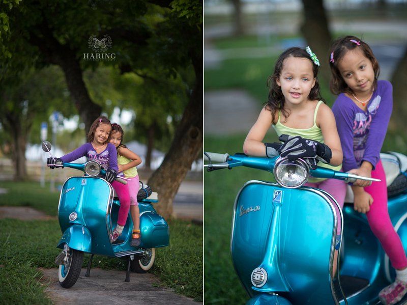

By the way, here is the scooter:

Lovely looking bike!!
