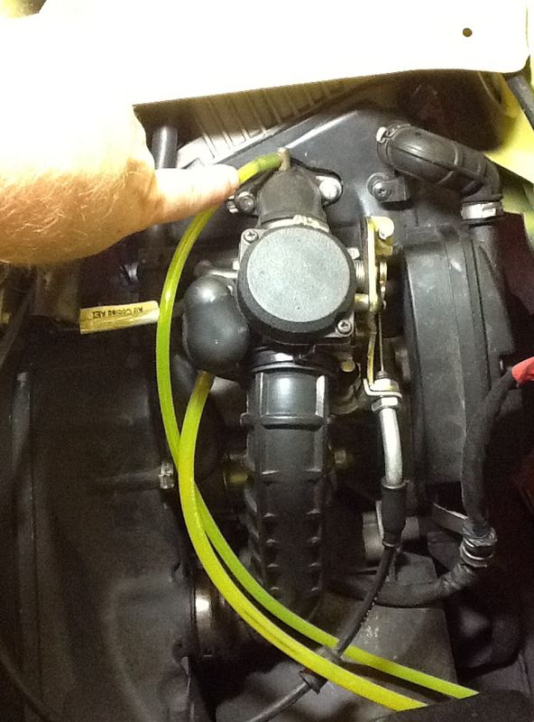

Well I give it a try,
Open seat(thing you ride on )pull that plastic bucket out,set it out of your way.Theres two lines(gas and vacuum)bottom right side of gas tank.
The gas line goes to carb(on top of motor)on left side.Remove line and that goes in a gas can on right side close to the tank.Plyers to squeeze the hose clamp.
The other line from the tank is your vac line ,remove the other end (in front of motor) squeeze that blue thing and put in the line.That will put a vacuum on the valve and let gas flow in the can.
You can stop the flow by removing the blue bulb if you have to.
Now loosen clamp (bottom of gas tank)pull down.Your cap thing should be close!DONT look in the hole you could get gas in eye.try your finger,a wire to fish it out.
In pic the two yellow lines (this is a different bike)the line in front is vac line.

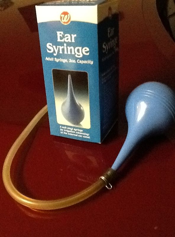

This might not be a terrible idea. If you think of doing it, you may as well put gas in the jar to see if it attacks the cap seal. Really, when you think what it's supposed to be sealing, it should not melt or dissolve or whatever.

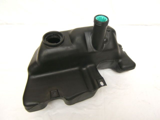

This is the shape of your URL tank so I don't think you will be able to shine a torch and fish it out. I would just leave it in there as worst case scenario is it breaks down and blocks the fuel filter, then you can remove it and clean it. Best case it just sits at the bottom of the tank for all eternity

Wow! Thanks for the pic. I see the challenge now quite vividly!
So, wait+see vs. syphoning? Given the pic, it doesn't look like syphoning would even help, does it?
After two days of no-ride worrying and all of the great input here, I think I'm going to ride and see... and ask the Vespa gods to be kind
