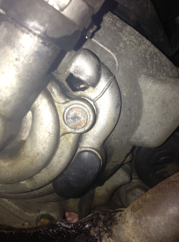

The engine started after, but I noticed a hole in the exhaust and also the air box had a large crack in it at the bottom.
I have glue the air box back and patched the exhaust, but I am getting no power on full throttle and can't figure why?
Then I noticed this on the side, the hole looks too rugged to be there naturally, can anyone shed any light?
The bike used to get up to 65/70mph on a nice road, not a have to feather it to 55mph and acceleration is woeful at best as I can't open up the throttle too far.
I have posted an image below and hopefully someone can help.

The hole is normal - no worries there.
Now for the bang and lack of power. I hope it's not this, but it sounds a bit similar to what happened once to me, and the culprit was a valve that was sticking. So be prepared to have to have the head off and examine the condition of the parts therein.

My first response was "valve"...
