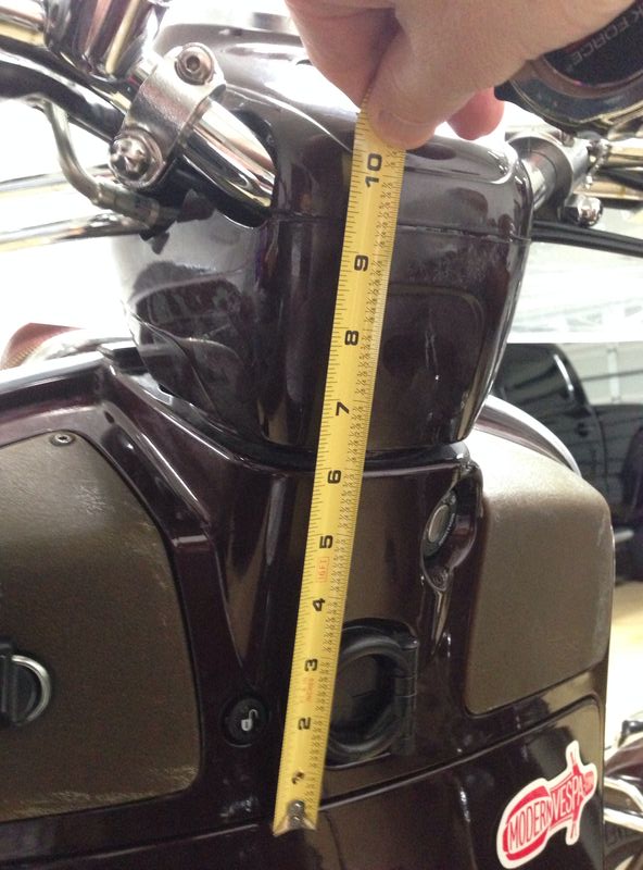

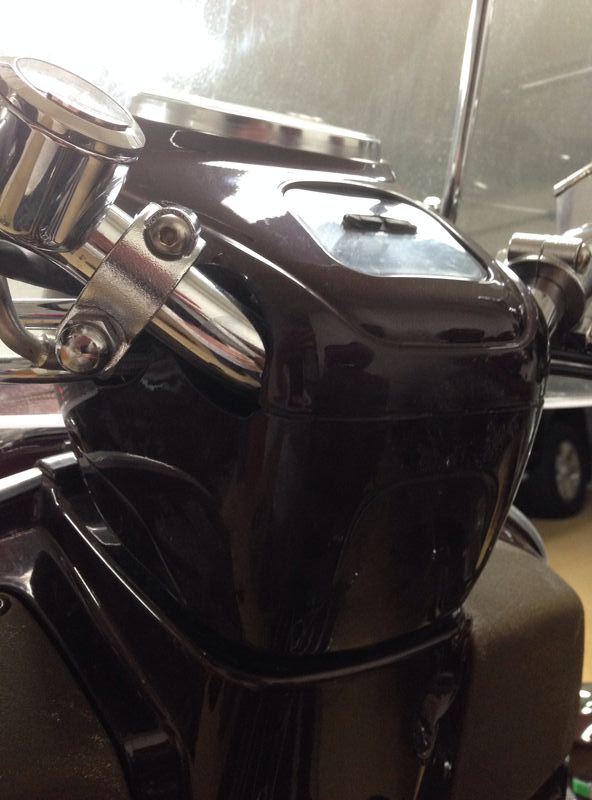

I finally took some pictures today...
Looks like hell.

I took the front two screws out and the headset is very 'firm' in place. If I wiggle the top piece around enough, eventually the speedo cable comes unplugged and then I have little more wiggle room. (it's still held in place by the wire harness)
It appears the back of the clam shell has a lip (as previously mentioned) but then a smaller post on each end, to the left and right of the tab. One of those is broken. I can't imagine that this tiny tab is making the entire piece fit like shit.
This is the kinda thing I can't help but notice and wonder, "i bought a vespa....and have to stare at this?"

We've got to resolve this. I took a photo just now to compare, and see if the top or bottom or both is the trouble.
I thought it might be the top... but now I'm thinking your base and top are mismatched. Perhaps one is of a different dash design, and the factory didn't match like-for-like...?

How about some measurements... Hope this helps.

After study of your stuff, it looks like the bottom piece is too high in front. Needs to be rotated down in front, letting the rear rise up. Wish I was there to help.

Looks to me like the handlebars are rotated too far up/back. See if you can rotate the handlebars more forward/down, and perhaps it will no longer interfere with the upper part of the clamshell.

Further review, I see this handlebar cannot be rotated (I am from bicycling background, handlebars can usually be rotated in their stems...). Anyway, perhaps the handlebar clamp is not fully inserted onto the steering tube. Or unfortunately the scooter was in a head-on type collision, causing the steering tube to be bent up a little, enough to cause the handlebars to interfere with the plastic clamshell.

I don't believe it's broken, it looks like the retaining tab at the back of the bottom half of the clamshell just isn't locked properly into the top half. The two pieces should snap together if you give the rear end of the clamshell a good squeeze. If you'd rather be more gentle about it, remove the two screws beneath the front of the clamshell (use a magnet to prevent the screws from falling inside the legshield), lift the front of the clamshell slightly, locate the tab at the rear into its slot on the top half, then replace the screws at the front, again using a magnet to keep the screw from falling into the legshield. FYI, you may need to remove the horn cover to access those screws. Presto fixo.
