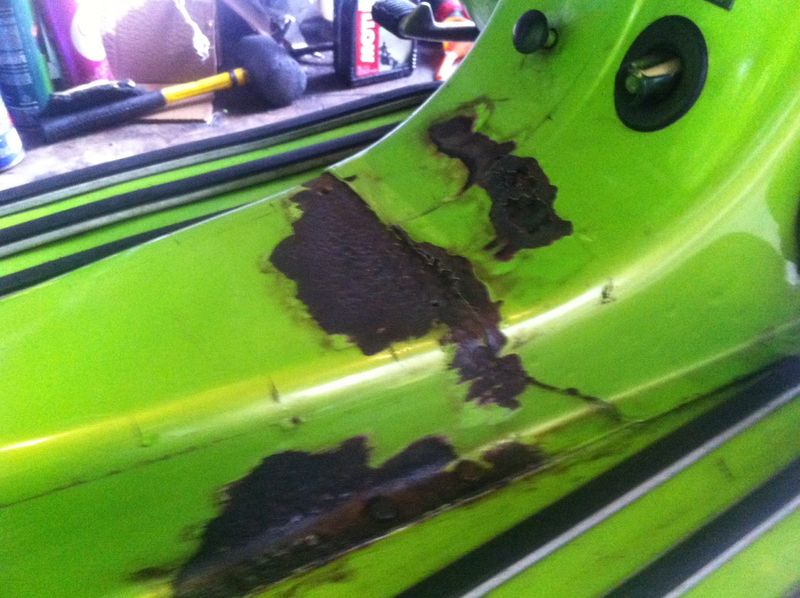

Any opinions on what I need to do about the rust. There is a hole just under the sight glass as you can hopefully see in the picture.
I want to get it cut out and what not.
Is there anything else to consider?
Thanks for all the on going help.

The top part, has 2 layers of top skin and another underneath i think, the centre tube has one.
Mask out double layer, around the black area and paint strip. Just to see how far the rust goes.(bottom pic) Id advise removing the inner floor runners either side.(easily reriveted)
Before cutting, it will probably be a good idea to jig the frame, welding a bar from the headstock to the seat frame can add support. im sure others will add there ideas.But the body will need supporting and its easily removable.
The red area is the likely area requiring removal and bending up. easy enough for a decent panel shop to do cheaply. You will need to have a piece made for the floor tube. Its the stand that causes the body flexing and the rust there.
Then the main floor tube will need to be bent and tack welded and then properly welded in, followed by your 3 main top pieces. A panel shop may try to get away with just a couple for the top bit but it needs the strength, so ask them to do all 3.
Its a bit of off road time but its easy to do. They can even bog the weld grinds and prime it for you. wont cost much, but it will also not be a priority for a panel shop so be patient.
Its easy and will end up looking good.
Definitely get rid of the rust at some stage

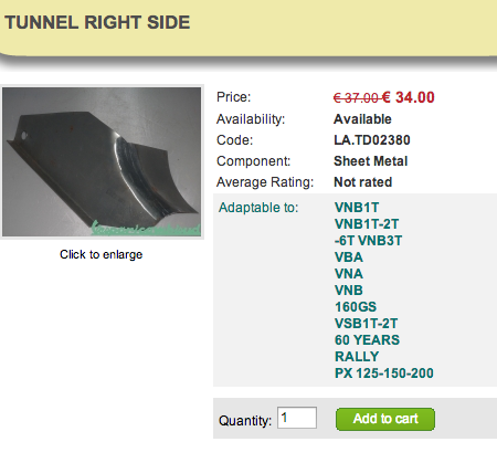

http://www.vesparicambisud.com/shop/index.php?route=product/product&path=5_53&product_id=2164#content
Dunno if it's the bit Ginch is referring to but may help knoxy.
Good site! I guess this is one bit that frame needs.

So this is the same product from scoter centre but slightly cheaper.
http://www.scooter-center.com/product/7671323/Repair+part+center+frame+piece+rear+part+OEM+QUALITY+Vespa+PX+T5+125cc+Vespa+Rally180+VSD1T+Vespa+Rally200+VSE1T+Sprint+TS+Super+GL+SS180+VSC1T+GS160+GS4+VSB1T+VNB+VNA+VBB+VBA?meta=7671323*scd_ALL_en*s18177839331424*repair*8*8*1*16
Although it says it may only fit 200 PX E (VSX1T - 1981-83).
Is there much of a change between year models in that part of the design?
Helpful that its in English too.
Cheers

As I read it - suitable for all px. Scooter-center recommended, good prices and reasonable shipping.

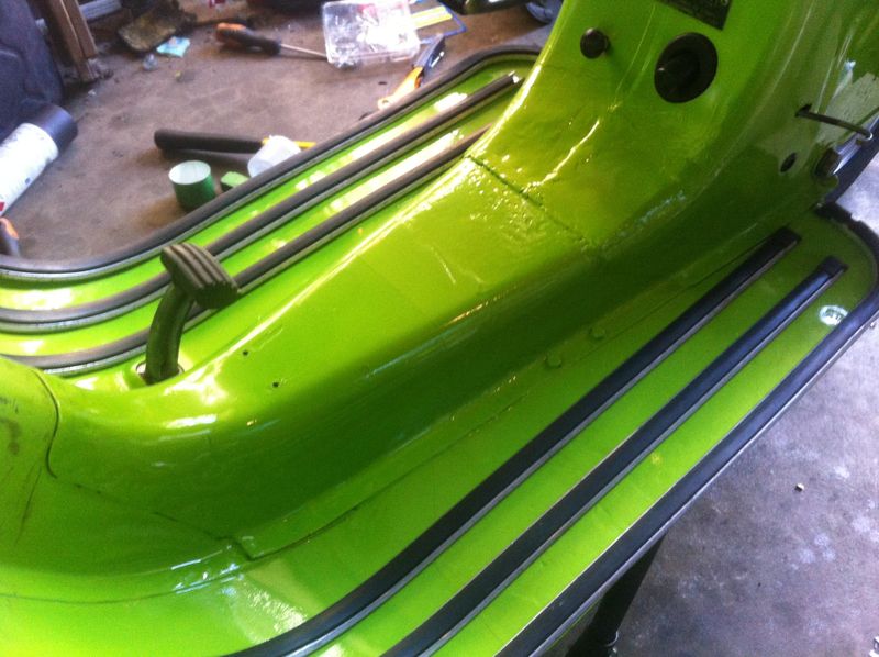

Hi just a note to finish this topic. Got it back and repainted that section. He ended up cutting and re welding the worst bits. Looks pretty good after its all painted.

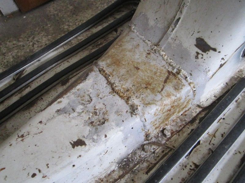

Would you mind sharing how much they charged to repair that?

Yeah sweet 300 bucks and he gave me a can of kill rust primer. It's not perfect but it's much better than it was.

I'm glad you're putting in the effort & cash to save her.
YES I know that adding $300 to a rusted out P seems silly to many.
Just remember that while you can buy a nonrusty P beater for that some places, other places have VERY little to choose from.
I think it looks like a 'best possible for the money' weld repair job from the pics, hard to tell for sure without looking inside with a lite & mirror. Just remember that the MOST important area structurally is the floor sheet, which is in tension under load. Look for bad areas there under the tunnel. The upper tunnel is under compression loading and could only fail by collapsing into itself. This considers the primary loading, but does ignore torsional loading which should normally be much less.
If you imagine a bodge with a broken in half body, you'll likely expect the floor torn apart with a big gap by tension, while the top is still barely joined but bent by the collapse of the unsupported center. Yes, I've given this some thought. QUITE a lot of thought in fact:
