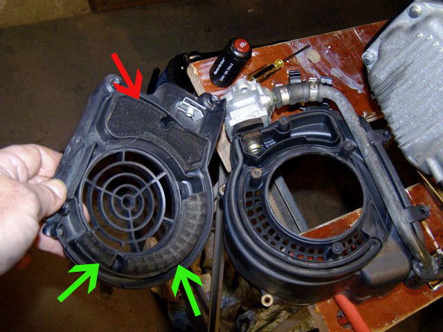

what is this?
red arrow sas filter. green arrows ????????

Coincidence
I was going to ask that question and you beat me to it. My misgivings were directed towards whether or not one needs to overhaul the flywheel or just undoing the screws of the cover and replacing the filter would sufice. Thanks for the thread.
Edited for title mispelling.
The Filter I Am Taliking About

Hi Max,
I still have not attempted this so apologies that I cannot shed any more light on it. I have too many other jobs going on at the moment with the exhaust, transmission, etc. I had a quick look and it does look like one could pop off the cover of the filter by undoing the 3 screws holding it and examining the filter. I don't think there would be a need to totally disassemble the water pump/flywheel cover, only if one wanted to check out the SECOND filter contained in the housing. I would do a hassle vs reward analysis and wonder of the benefits ??

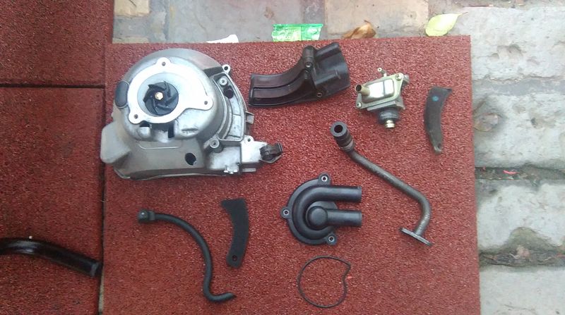

Well here I am, 3 years later and after much procrastination, this weekend I finally removed and cleaned the SAS filter !!
I have to say that once I got into it, it's not massively difficult but it is time consuming-allow 4 hours at least. I used the workshop manual which can be a bit unclear at times, but I took a few photos:
The full exhaust/muffler would have to be removed for this.
1. Disconnect the coolant hoses and drain the system.
2. Unplug the black electrical connection at the top of the flywheel cover.
3.Disconnect the small 9mm black tube called the depression pipe in the manual.

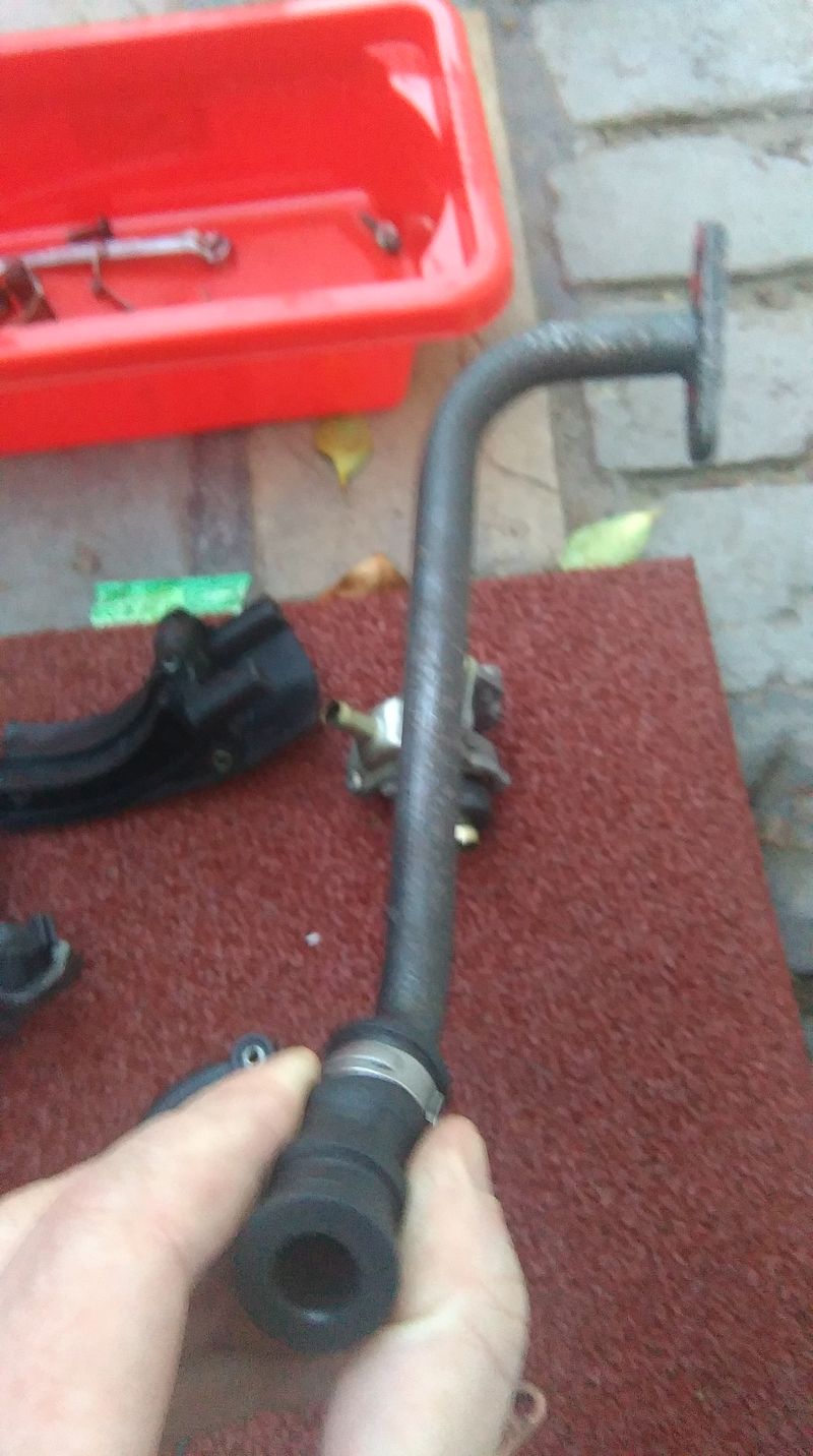

4. The SAS valve is connected to the head of the engine by a hard metal pipe, via a rubber coupler at the SAS valve itself. The manual says to disconnect this coupler by removing the clamp, but next time I wouldn't bother. At the head of the engine, disconnect the metal pipe from the header by removing the 2 bolts (10mm spanner). You will need to get under the bike for this.
5. Take off the bolts holding on the flywheel cover and it should come right off, with the hard metal pipe attached.

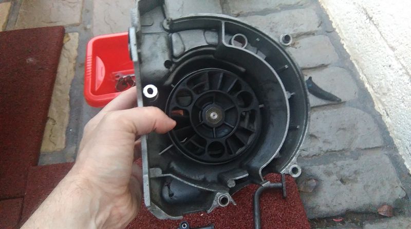

5. Now you can access the plastic housing for the air filter
You will now have something like this !

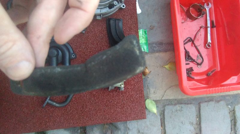

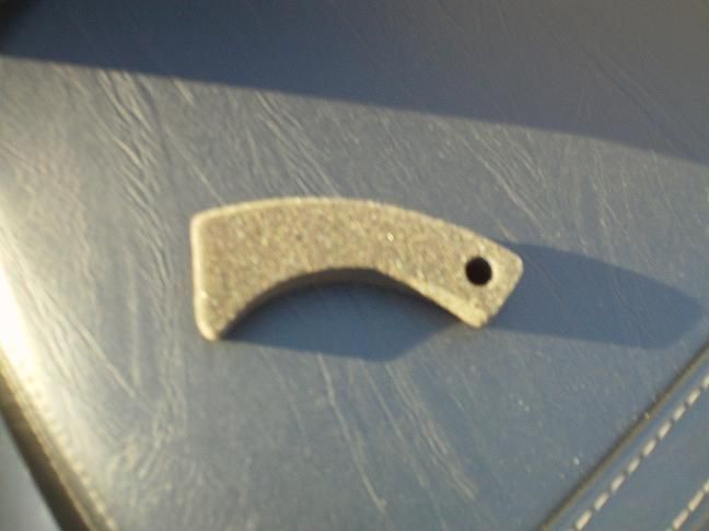

The old filter- pretty crud

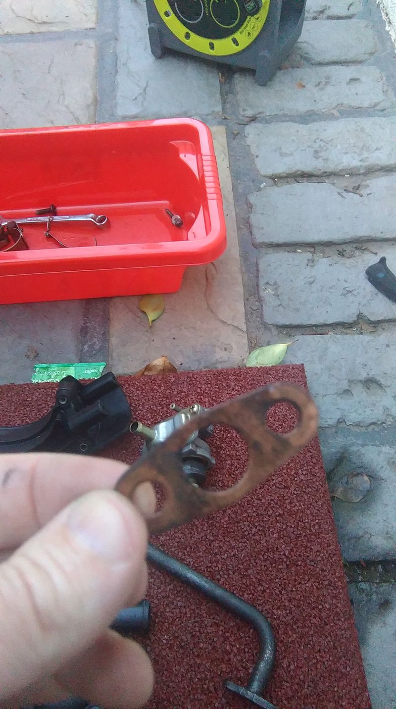

Don't forget the copper gasket when you are replacing the hard pipe back on to the cylinder head !

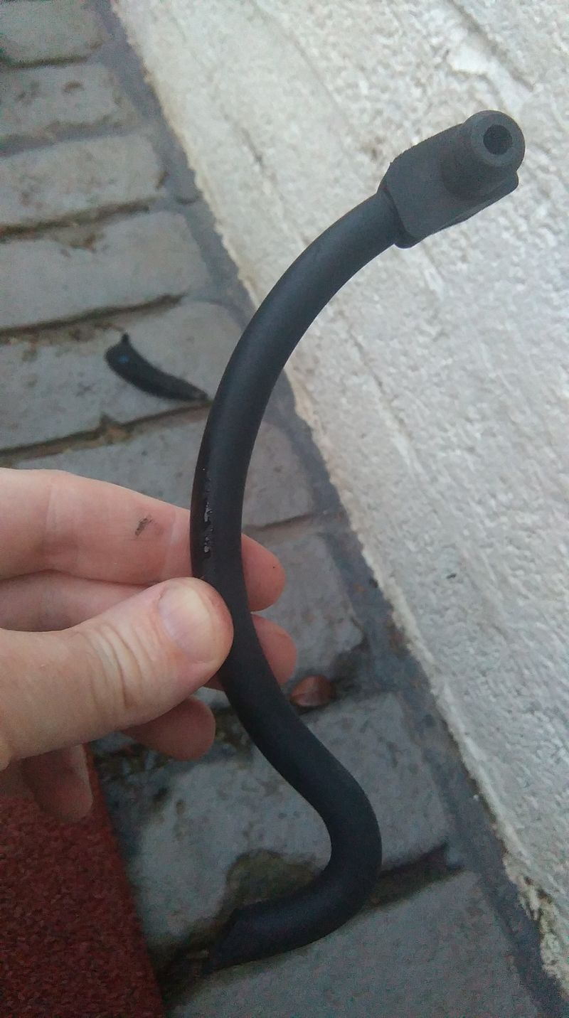

Hard metal pipe connecting the SAS to the engine head

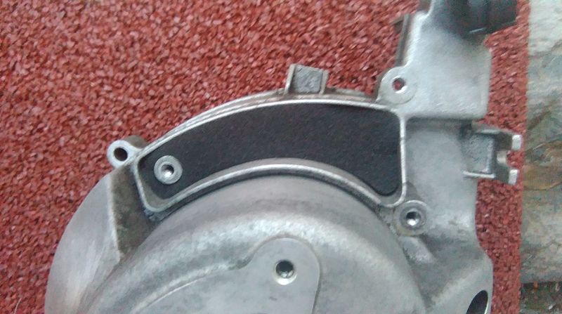

This is the air intake pipe for the SAS filter located in the flywheel cover- note I have only one filter in my particular SAS arrangement
New filter Installed

so the process was a bit of a pain but I'm glad I did it as it had obviously never been done before. The OEM filter was pretty crappy and there was also a dead beetle in the housing !! Will it improve performance? we'll see....
The manual recommends doing it every 2 years but I think you'd be mad to do it that often- every 5 years would be loads. or, if like me, the bike is 10 years old and you suspect that it has never been done.
The filter replacements are about EUR3 each so it's pretty cheap.

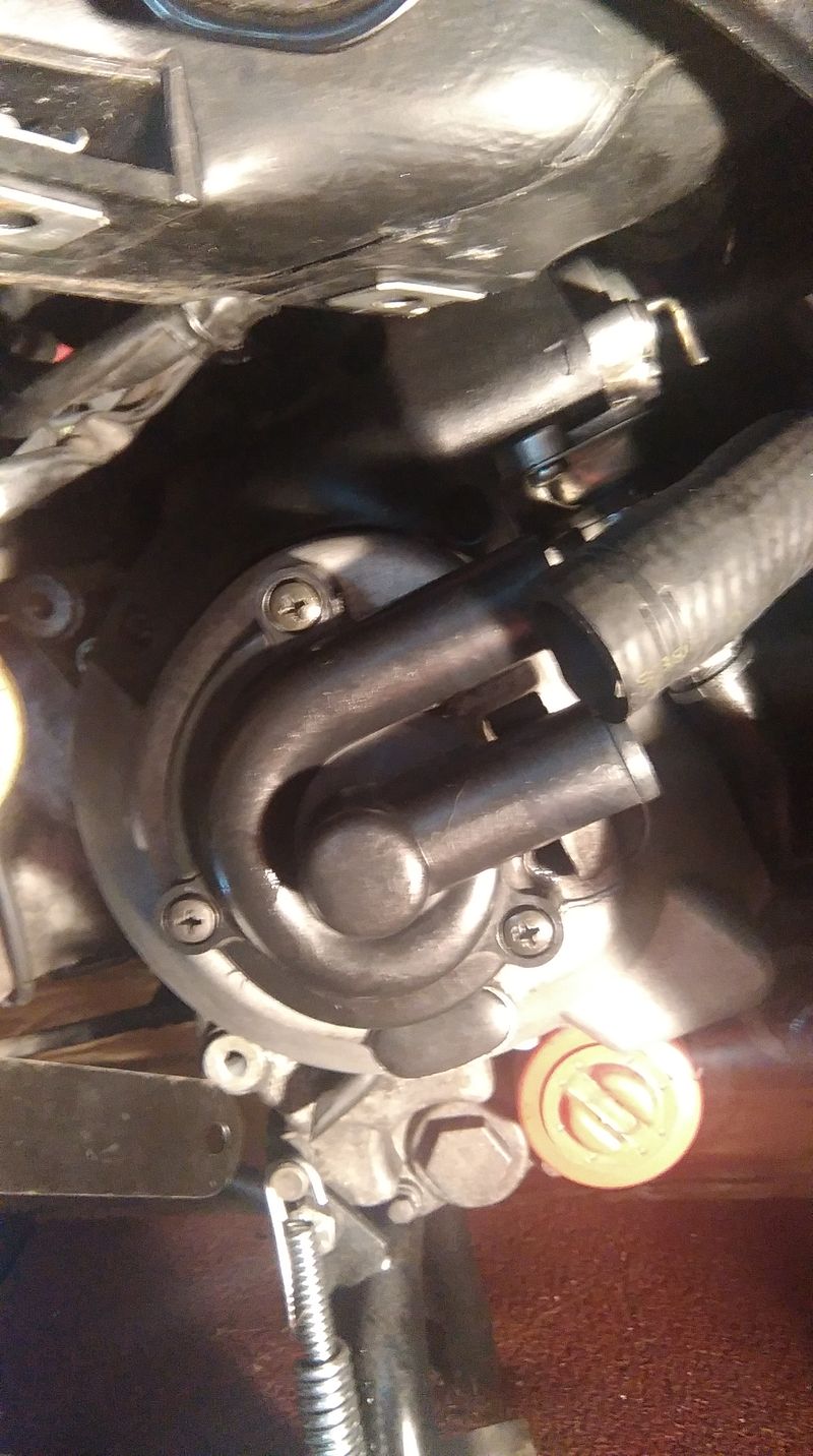

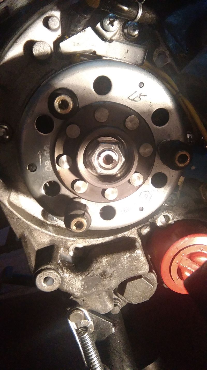

One of the trickier things on reassembly  is to match the holes in the black plastic disk here.....
with the locator pins in the flywheel. it takes a bit of maneuvering. Leave the black plastic water pump cover off and turn it by hand to get the holes and the pins to line up....
