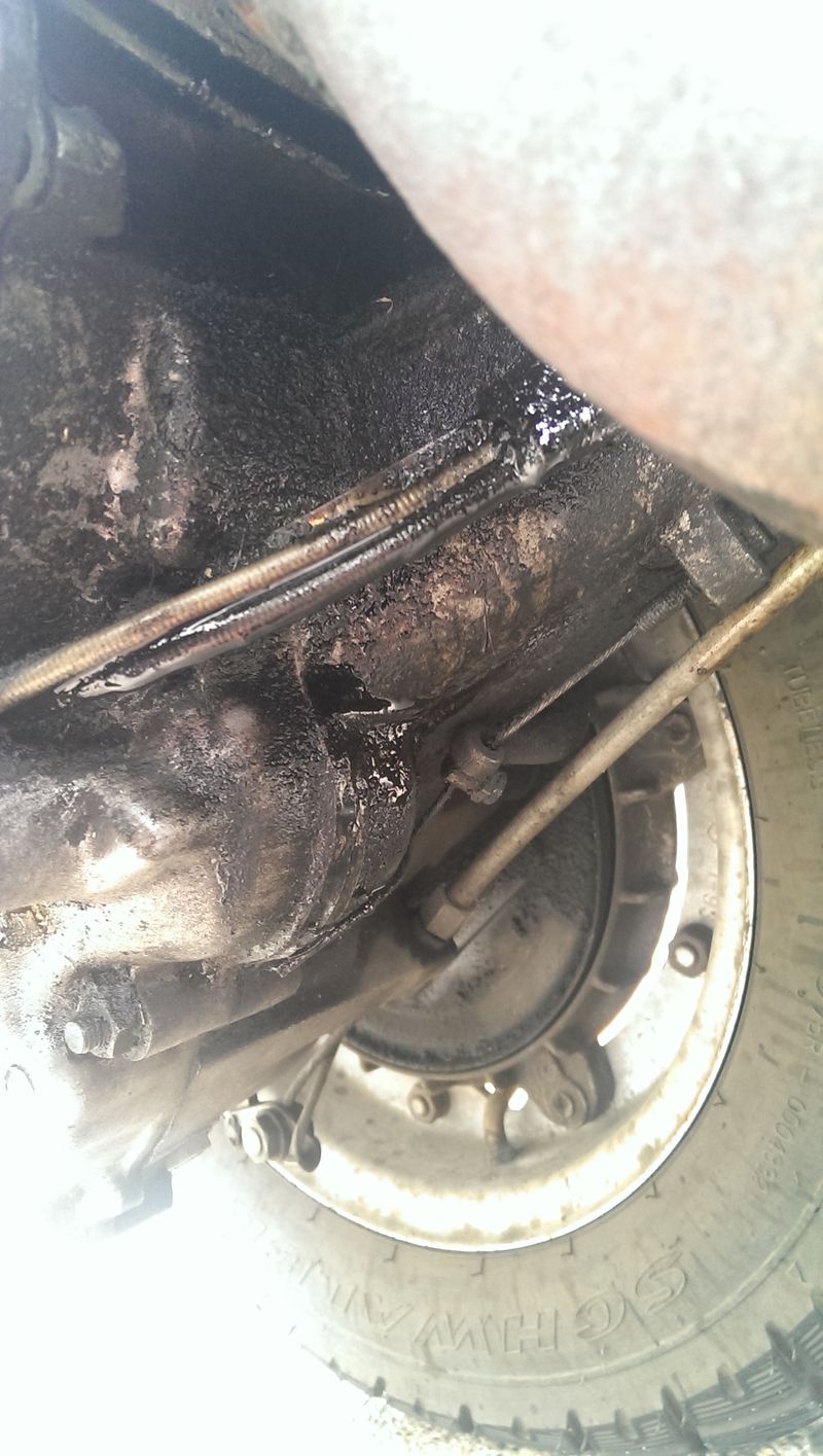

Gidday!
So I bought a PX after looking in vein all year (couldn't justify a purchase until now) and have been blatting around town on it and absolutely loving it!
However....
There is a small oil leak coming from somewhere...so I took it to my local Vespa garage....AND...they thought there was a slightly funny noise coming from the engine, potentially an issue within the crank case. Hearing that was not music to my ears.
They informed me I was looking at 1000+ for the to diagnose - source parts - replace parts - get it running again. Half of which will be labour costs. Of which I cannot afford right now.
SO, I am thinking I will embark on the journey of diagnoses etc myself. I am very keen to get to know the Vespa engine intimately anyway so what better way than this?!
I am wanting to know if there are any important tips/tricks I need to know/watch out for before I embark on this journey.

First thing is to try and work out where it's coming from. Clean all that gunk off and go for a ride and see where it's leaking from.

Try simple green or purple power if its hear you.Spray on and wipe off with paper towels .

Looks pretty normal. Oil leaks for me most often seem to turn out to be coming from the carb box or clutch breather. A lot easier to see once you've cleaned it as has been pointed out.

Cleaned it as well as I could with what I have at home (will get some simple green and a metal brush and do it properly asap) and it appears to be coming from quite far up ie the casing has a fair amount of oil between the grooves....how worried should I be?

+1 on the clutch breather and by the way when you pull the clutch lever in it sometimes sounds dreadful.

looks like a head or base of the barrel is leaking
you can fix that with a new gasket set and / or lapping the head to make sure it is flat
could be the oil tank since they leak at times at the oil sight glass and / or rule lines hose clamps or tap
pull tank and take a peak

I reckon you're probably right spiderweb. Mine gets grotty at the back end - I think from the carb box as Ginch said. Never at the front like that. As far as the kick start goes it could be the return spring or mashed up rubber buffer in there. Probably not worth splitting the cases for.

+2 on the clutch breather.
But as suggested. a can of engine degreaser from repco and a dish brush (2 dollar shop) to remove gunk. You could also get yourself an extension dentist mirror from repco and once clean and ridden, use a torch and see if you can find where it leaks or check if its coming from the clutch side.

Uhhh, isn't there a hole in the case? Or am I just seeing things?

grscum, where abouts on the case are you looking? I will go back to the car park and check it out in a minute..

torque it down at the head

In the picture, look to the left and a little bit up of where the clutch cable is in the clutch arm gizmo lever. I see what looks like some clean aluminum and to left of that is a big black spot that looks like a hole. It could be an optical illusion, but right now it looks like a hole.

i think that's just pooling oil.

Yeah just oil, sorry whole thing is filthy. This weekend I will give it a proper go over.

Degrease the engine as other posters advise then, to help identify exactly where the leak is coming from, dust the engine cases with talcum powder. After a couple of days there'll be a tell tail trace leading to the exact spot.

Ah good, better than having a hole in the case.
Clean it up, track down the leak, fix, and enjoy!

My former P series, and Sprint did that as a normal course of use.
Tighten airbox, carb etc. and wipe engine frequently to remove film before it grows into goo.
Totally part of the 2T experience.
