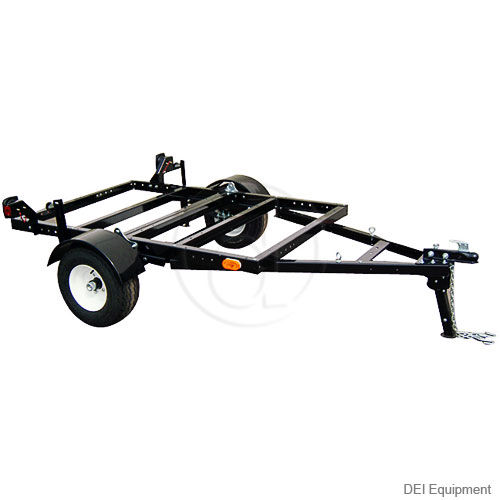

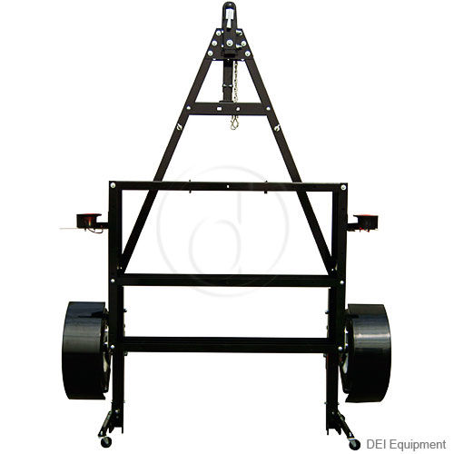

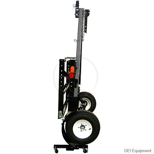

I'd spend the dollars to get a unit that I can load myself. That ups the ante.
More like this.
I'd feel secure with the Toyota but the Honda is a stretch. There is a 150lb capacity difference. Someone will doubtless pop up and claim they do it all the time, but I tend to want to have wiggle room within the specifications.
There's always a folding trailer.

tom ,Are you saying you can load a bike your self with that Boss.
Pick the rear end up and slide a pin in ?Well maybe with a jack but seems it'd be a pain in arsh.Sometimes you don't get what you pay for.Hint

No not at all.
tomjasz wrote:
More like this
. It looked like one that might be possible. You make a very good point. It would take some searching to find such a rig, IF it exists. I went with a trailer. It folds up, self loading, and does other chores. I can use it with any vehicle. Even a little Yaris. It stores so nice, a buddy lets me use a bit of his garage space. I should have kept my nose out.

Toms folding trailer is a good idea if you don't have much room .

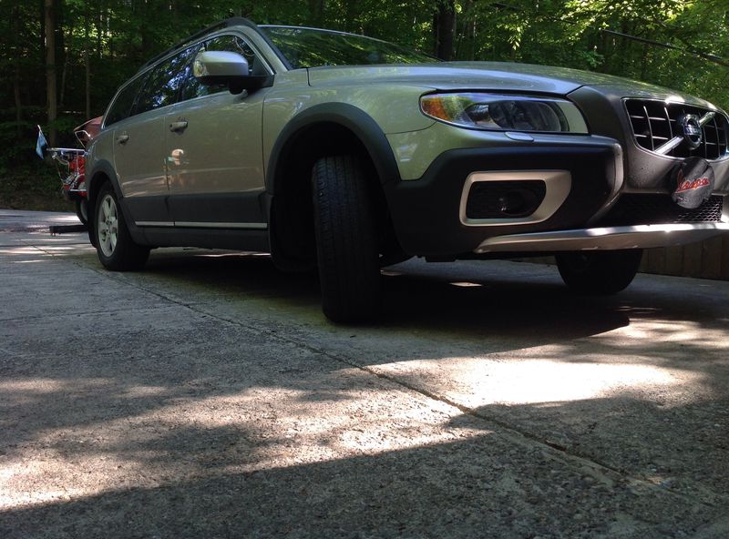

Here it is loaded, one person operation, but it takes some skills Laughing emoticon

Maxx I like it!
See front wheel in choke,it won't go forward any more.
See straps that not only hold it up ,won't let scoot go back.Its locked in!
Straps crossed looks to have an advantage .I do that with certain things
I haul.
It would freak me out not strapping the rear down.

psst, specifically what trailer do you have? Folding and small car friendly is exactly what I need.

Black, 50" X 72" Foldable Utility Trailer
Model Number: LCI-746TE
I added a chock and decided on a deck and no rail. The chock needs to be set forward into the A frame tongue section given the weight and balance of the GTS being towards the rear. NOT a good choice for two GTS sized scooters. I added rear and tongue stands so t can be loaded and unloaded unhitched. We have some great farm and ranch stores around MN, you might poke around those for what's available. This trailer is heavy and takes more strength than I have to get up after folding. I could do it 5 years ago, so maybe it is manageable for you. Where I you and with what I know today, I'd search for a steal or deal on a trailer in a bag or similar. Unless you can use a utility trailer for other chores. I'd prefer, as it turns out, to have a dedicated scooter trailer that was easier to handle. But that's the result of my inability to handle the weight. ScootChef found a steal on a Kendon folding trailer. One sold in mid November on crags list Mpls.

I thought about hitch carriers many times. I read this thread few months ago. I tried tilt a rack today. I had to problems loading and unloading. HOWEVER, despite the fact that combined weight of the rack and the scooter was lower than maximum tongue weight, the set up didn't look safe to me. I didn't try driving with my scooter on the rack. It is not about the clearance. The clearance can be adjusted. It looked like the car's nose got up and rear suspension was compressed more than I expected. The car , Volvo xc70 has less than 15000 miles on the odometer.
air bags, if the tongue weight isn't over spec, but looking at the rig your numbers are seriously off somewhere. THAT is not in spec, or even close IME.
