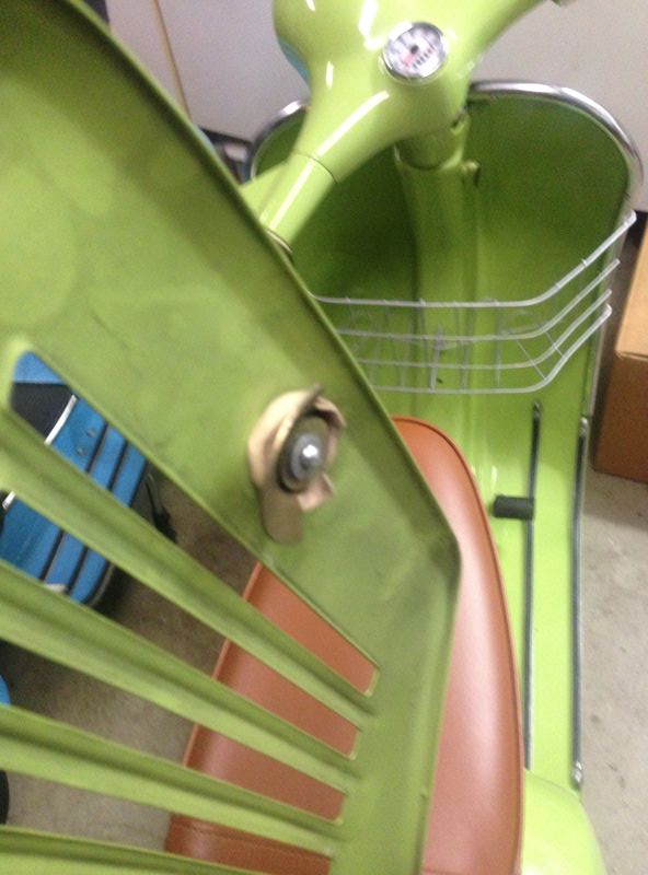

My battery door latch wants to vibrate towards OPEN. That is a big problem, based on the lack of battery side doors out there .
I'm going to get the new rubber nubs and adjust where possible, but are there any other tricks? Clamp something over the sheet metal where the latch engages to make it a more firm engagement?
Should I replace the handle with a lock? If so, do they pop right in the hole or does the door need to be modified?
Thanks for the advice. Cheers.

Primavera, right? You can modify a mailbox lock to work with it. Just drill out the brad that holds the current latch-doohickey (through the center). Then you'll need to cut a slot in the frame right inside the edge of the compartment and you'll need to open up the hole on the door so you can put the new lock mechanism in. I've done it a couple times for people.

Thanks, I'm leaning towards the lock idea. And yes, Primavera.

An easy fix is to wrap a rubber band between the latch and door. This will make the latch stay when you close it.
Wrap them in there tight! Worked on my wife's bike for the past 8 years.

genius!! That works awesome, at least gets me rolling. Thanks!

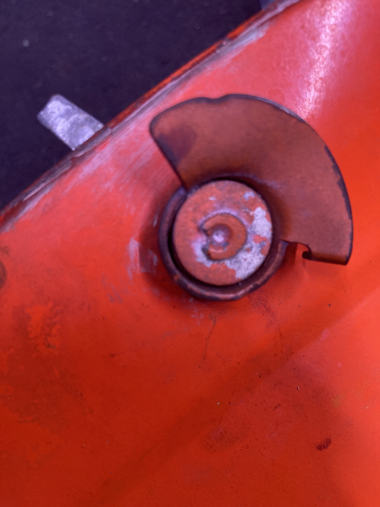

sdjohn did you end up replacing the latch with a lock?
Given the availability of these doors and anecdotes about losing them, I've decided to put a zadi lock from Scooter Mercato on mine.
Just want to confirm, I need to drill out the thing there that looks like a backwards C?
smallframe batter door latch, inside view
yes
