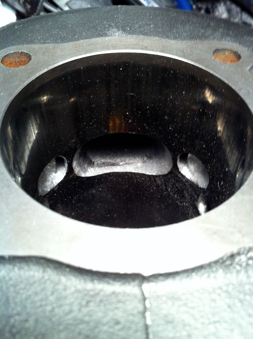

Do you have a 2mm base gasket?

Sara Alexandra wrote:
I have a 2mm base gasket ( 1mm for the longer stroke and 1mm for the transfers and exhoust port)
What port timings are you aiming for?
Nothing to extreme. It have to be torquey and rev to about 8000rpm.
I also opened the ports on the base of the DR, just like the Polini.
They where designed to fit on the standard cases and where restricted.
For the moment i would like to try it with the DR, just to see how far i can get, tuning-wise that is.
And my colleague has also a PX, with a lot of money in the engine, a Polini racing cilinder, flowed crankshaft and cases, disc valve, Dellorto 30mm carb, etc....
And he just paid over 600 euro's to get the engine tuned. 15.5 hp.
I want to beat him for a fraction of the money.
Luckily i know how to put my hands and mind at work. Laughing emoticon
So when spring comes, i will be ready. Laughing emoticon

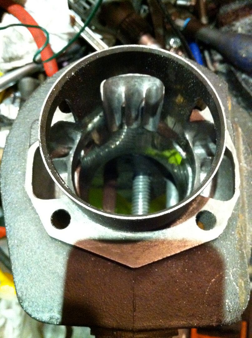

DR is a 2 face baby with its exhaust boosters:
@ginch avatar
Posts: 9144
@ginch avatar
Posts: 9144
Nice work Fastfrog. So what do you mean "boosters"?

the 2 boost ports...
@ginch avatar
Posts: 9144
@ginch avatar
Posts: 9144
Ok, so they're boost ports... the words "exhaust boosters" made me think you had found some way to add extra exhaust ports!
