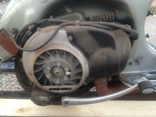

Any experience with sea foam deep creep case and cyinder cleaning? I'm cleaning up a scooter that some what low miles at 550, with its last registration in 1979. What made me think of using sea foam was reading the owners manual section describing how to Lay Up the scooter. It instructs to introduce 40 cc of SAE 30 weight through the carb.
The motor is not seized and no leaks. a good scooter wiseguy advised seals may be dry and possibly may be shot & the clutch corks. ( the petroleum fluid in the gas tank is still liquid- it is not gasoline either)- so i am thinking their might be a possibility the seals could benefit from a Lucas or Kroil oil bath and cleaning. I'm thinking of applying deep creep once a day for a week. Give the oil time to penetrate. - I also considered - aero kroil as far as "bath" for the case and cylinder to clean out the old oil, and lubricate the seals. - I am checking to make sure these are non detergent - or if so what to use instead. If there is post on this I did not find, please direct me to it.
I'll know more when I get the carb off and get to look inside there and see what is going on - Thanks.

I believe some people have had experience with seafoam, you will probably get a load of answers.
So you have a "new" scoot.
Youre trying to get it running?
I wouldnt bother trying to rehydrate old seals. The layup method is good for making the seals last but it wont help if theyre brittle
Remove the carb and use crc carb cleaner or the such. New gasget new fuel and put an inline fuel filter in unless your going to pull the tank and get rid of all the drud. Run it and see how it performs.

Is putting a teaspoon of 2T oil down the carb w/ the filter off and another half spoon in thru the plug hole a bad idea in cases like this?
I usually do it but I'm not positive it helps - give those dry bearings & rings some early lube or maybe negative - could make it harder to start, assuming it's getting fuel.

I'll defer to others with more experience about the seals, but personally I wouldn't worry about it. Ours started up with minimal fussing after sitting under a tarp for close to 17 years. All we did before kicking it over was:
Drain the old gas and replace with fresh
Drain the old oil and replace with fresh
Clean the carb
Put in a new plug
Spray a boatload of Berryman's down the carb and in the tank
Put a little 2% mixture in the spark plug hole to prime
It started after 5 or 6 kicks and has run like a champ ever since.

If the outsides of the cases are oily I'd spray them down with simple green and pressure wash them. Maybe hit the heavy spots with a wire brush. Chances are if the fuel is that old you'll need to pull the fuel tank and replace the petcock. I believe there is a screen on the inside of the tank on the petcock valve. The gaskets (paper) may need replaced in the carb. I would change the case oil right away but if nothing is froze or stuck can't see a reason to use kroil oil on anything.

I would pass on the simple green. That stuff is tough on aluminum and will oxidize it. WD40 works just as well to break up old oil deposits and won't attack the metal.

Thank you for the suggestions. I have planned on removing the fuel tank, washing the inside with acetone and a chain. Removing the carb and soaking it in a can with a basket of carb cleaner. I have a carb rebuild kit, may try running the bike with out a carb rebuild. I am also replacing the original fuel line and cleaning and rebuilding the USA version of the fuel control or switching it to the European with the plate and the gasket. I plan to clean the entire fuel system and replace the sediment screen. Last replace the dried out tires with a vintage set of Continentals. I have a set of clutch corks in case that is seized. I have a new spark plug as well. I plan to keep most of the original parts so If I sell it, I can include all the original parts. I'll keep you all posted with the progress. The scooter appears to have been garaged as the original Scooter Ville dealer stickers have absolutely no sun damage.

Picked up my 1980 P200 with only 69 miles on it about 4 years ago. Never split the cases. 13000 miles on it since. I put in a new Stella tank right after I bought, later a new stator and carb. I have always worried about the seals, but so far no leaks have appeared. Good luck with it. Any pics?

Simple green is an alkiline and should not be left on alm for a long time. I bought in bulk years back some 'exstreem simple green'. It has been rated safe to use on aircraft. Ive not had any oxidation issues with it. Most cleaners are alkiline like simple green I think the biggest thing is to rinse well. As for the carb you can remove the jets without taking the carb apart I'd only do a full rebuild if the carb leaks at the base or the bowl. Good luck.
