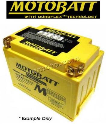

Capitano wrote:
http://www.wemoto.com/bikes/piaggio/vespa_et4_125_4_stroke/00-02/picture/battery_motobatt_sealed_high_torque/
Capitano do you work for Motobatt???? Laughing emoticon
I wish!
No, just a devoted fan. WEMoto sell them avidly and are about half a mile from my house. Therefore it's mutually beneficial to promote them now and again.
They are pretty good too.....WEMoto that is. Motobatts are excellent!
