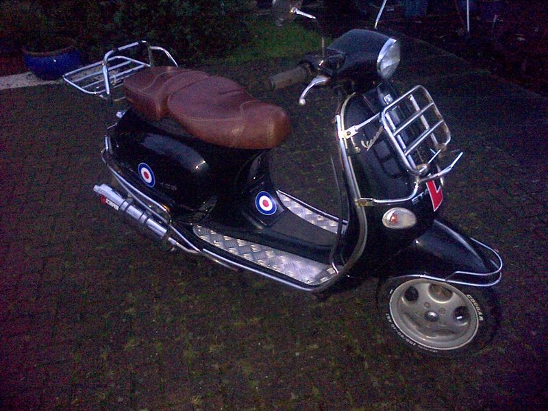

my et4
hi i have an et4 125 2002 in traffic mine seems to judder + some times off the lights but when shes warmed up she seems to be ok when i start her up most times in the morning + after short rides . after i stop for a bit she does not idle very well maybe for about 3 mins i have to give her low reves on the throttle for a min or 2 till the idle picks up.but if i take her for a dam good thrashing she rides great and starts fine after ??? i have shit loads of bottom end + she does about 64 top end on a flat i have a scorpion exhaust dose any know if this is normal or does it sound like my auto clutch is onits way out or my carb?????shes done 10755 miles about ......but worst times are when i start her up mornings and when she been stting for a long time like after work any one got any !!!!!!!!!!!!!!!!!!!!!!!!!!!!!!!!!!!!!!
