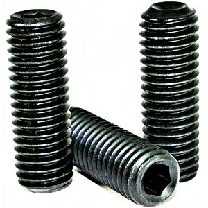

Go one step further and change over to an allen wrench set screw.
still not good as the weight will not be equal. this is why you need 1 set of matched cones and put the set screw or thumb screws 180 deg apart.
