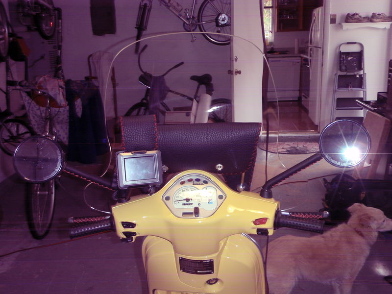

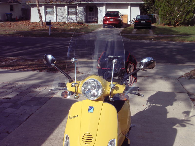

So here you go Joe. The speaker system is a little behind from the great white north but, is on the way. Mr Massey thanks again for the electrical info. So the wind shield is in place and I added a wind shield bag, to hold the important stuff. Clear glasses for nite and sunglasses for the sunny Fla days. Follow the thread.
Faco brand tall. 15 1/2 inches tall. I am 5'10" tall.

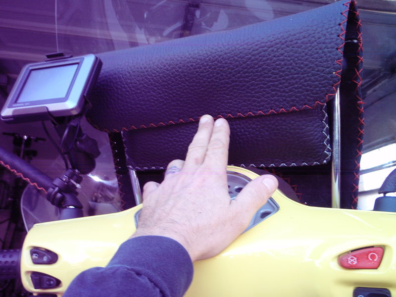

I made myself a lil windshield bag to hold the essentials.

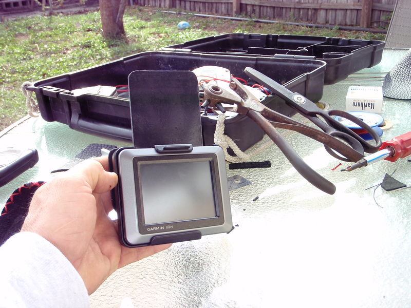

Took a piece of plastic the neighbor tossed in the trash for the frame work. Attached to the ram mount for the GPS. Ram rocks! Rock sturdy.

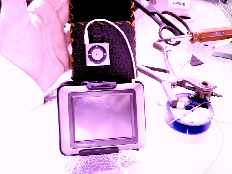

Made myself a lil leather bag for the I pod.
My view. Once I figure out the speaker situation....Will follow up. Don't worry Joe, only 100 watts. Promise you will never hear me.  LoL....

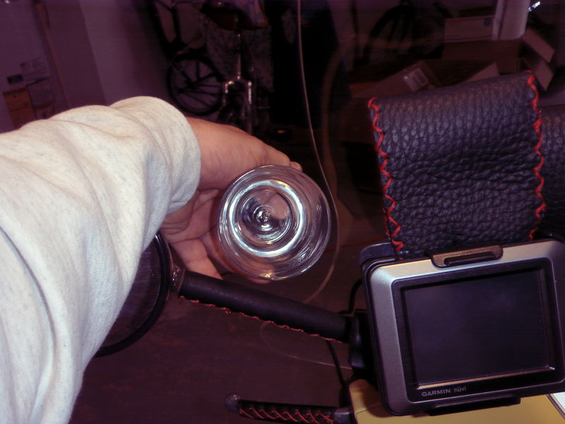

This is a drink glass that is 3' by 3'. The speakers are the same exact size. The mounts are 7/8 meant for handle bars. I think.... Not sure so it won't be hard to do some leather work. then upsize the mirror post to make it fit and look good. I blue lock tighted the mirrors in place and an extra nut to keep everything secure for the extra weight. Fun part is taking everything apart once again for the final install.
3"x3" with the 1/2 inch rise for the mount.

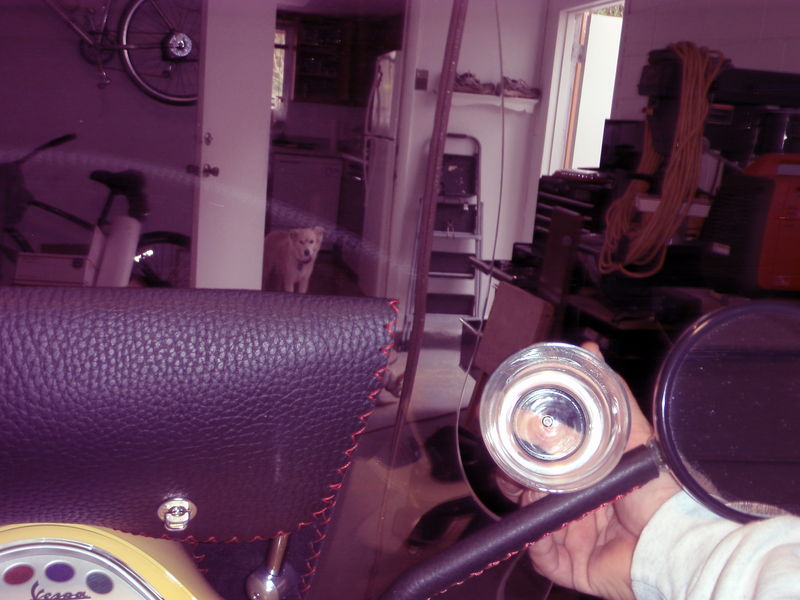

The right side.
The right side.

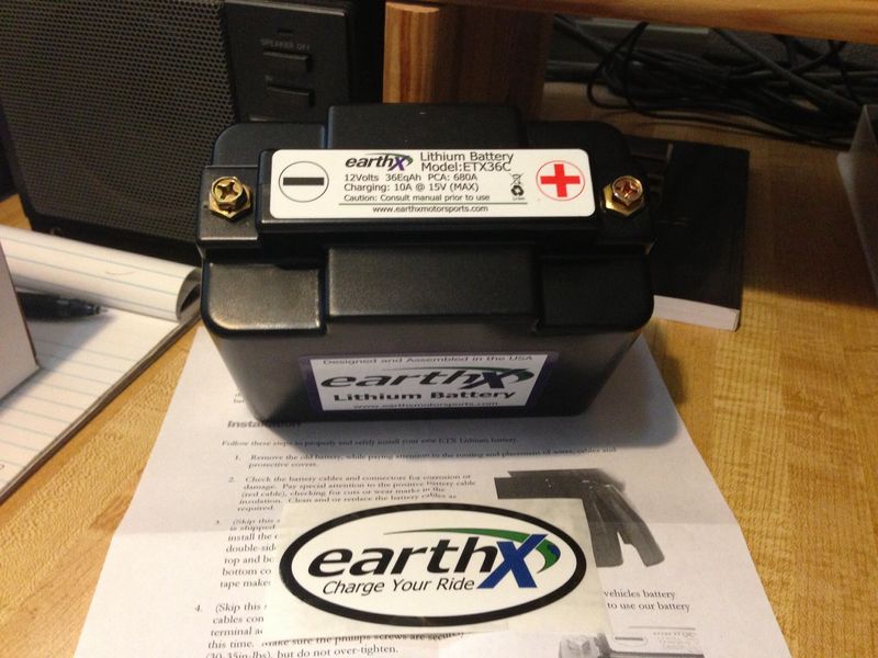

Upgrade to a EarthX Lithium Iron Battery.
Install the Highest Amperage that will fit or you can afford.
Your charging system is still lacking, but it will provide more capacity.
Look at the ETX-36C and go down from there...
