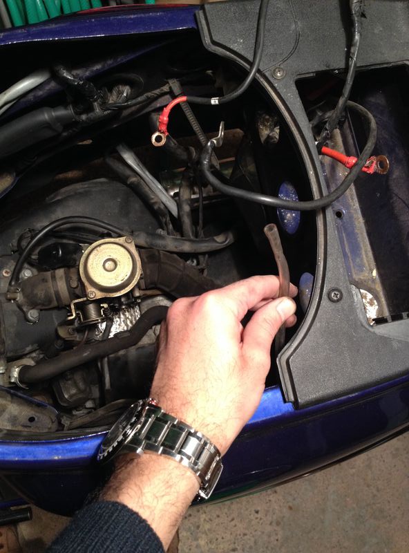

Hi guys,
I have recently bought my lovely Et4 125 pre leader
Just took the battery out to give it a charge and noticed a pipe floating around... It runs from near the battery compartment, along the side panel and dangles out at the bottom of the bike. Looks like it should be an over flow or something.
Can anyone please shed some light on this mystery... I am not technical please assume very basic knowledge... I am learning lol

I'm pretty sure that is your battery compartment drain pipe. Someone will correct me if I'm wrong.

I'd agree with that. You should see a spot on the battery itself to connect it to. It is supposed to be a pressure relief for the battery, and direct any runoff away from expensive bits that could be corroded...

Battery drain tube for old-style 'wet-cell' batteries. If you have a more modern 'maintenance-free' battery then it's irrelevant.
