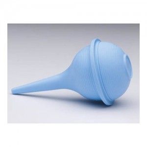

For those that do change their brake fluid I have found that an infant bulb syringe works splendidly for extracting the old brake fluid. Mine cost about a dollar at the discount store.

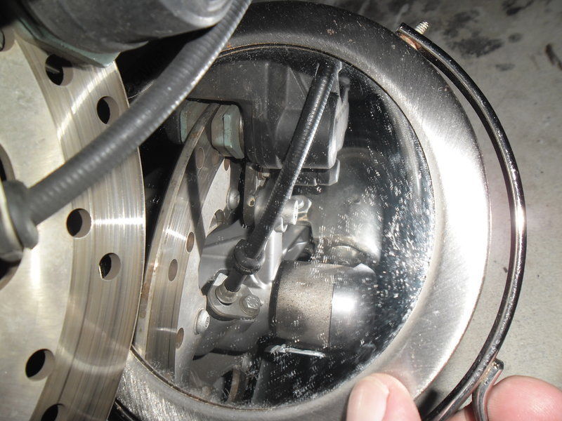

Good advice from jimc using a mirror to inspect the brake pads. With a small mirror and a flashlight it is easy to do.
Inspect brake pads using a flashlight and a mirror

well, got a mirror down there today and I really can't see much meat left on them at all so they must be fairly close to the backing plate...
