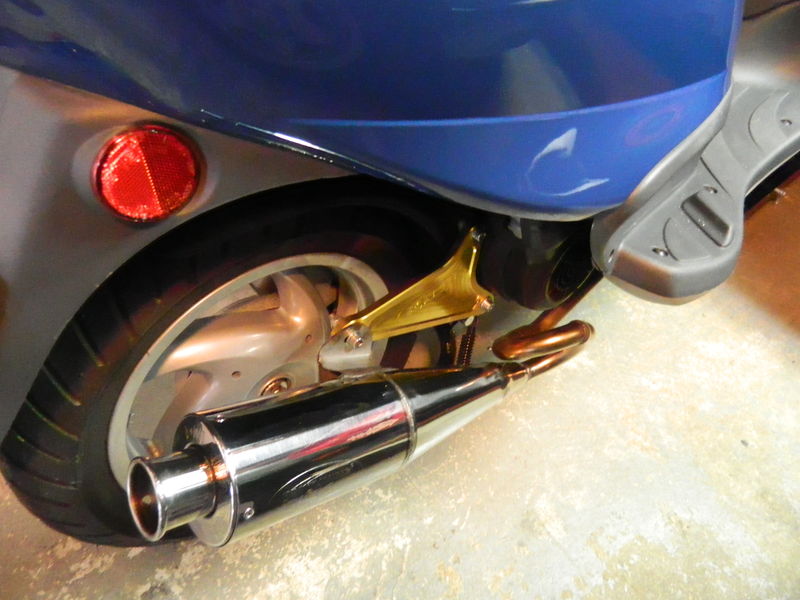

Results Are In
This project has been an entertaining period of "constructive recreation". It gave us something to do in the basement over the winter. Here is a summary of the results from our tinkering.
Many thanks to my Friend Vic, whose mechanical skills made this happen.
The Fly started with about 14,000 miles.
Stock performance with new 10gm rollers, belt and rear tire yielded an acceleration time of 10.51 sec over a measured course. Top speed per gps was 57mph.
The following changes were made over a period of testing that measured performance after each modification.
PM Tuning Pipe
Piaggio Liberty 200cc cylinder and piston.
White Malossi main clutch spring from Multivar variator kit
Remove intake tube from air filter.
95 main jet
.05 shim washer under clip on needle.
DR Pulley sliders in stock variator. Total 60gm (same weight as stock)
Red clutch shoe springs. (stock springs seemed just as effective.)
Results......9.10 ET over course and top speed of 58.5mph.
This time is lower than my GT200!
##Note that the top speed was recorded on a separate run than the acceleration. Don't want you to think 58.5 mph was reached in 9.10 sec. We will have that number after taking it to the track.##
The original goal of stronger, quicker acceleration up to 50-55 mph has been met. Higher top speed was not expected due to gearing. Actually when the bike was at sea level in stock form, the top speed seemed to settle in closer to 60, but that was not verified by GPS.
Here in the hills and mountains of North Carolina the Fly pulls very nicely. Pull out of the turns is strong, making for a fun ride.
All of our testing (details in the linked thread on ADV) was extensive, putting over 600 miles on the bike. There was a lot of trial and error getting to the final configuration which works well in our hands.
Hopefully, this summary will allow anyone wanting install this kit to go right to the target without much distraction.
After thoughts....
Disconnecting the shock and allowing the wheel to drop a bit makes removing the tranny cover much easier. The body work of the Fly makes it much more aggravating than on an ET4 or LX.
Very little change in top speed can be gained without changing the gearing. An up gear kit can be installed and with the increase in power higher speed is available (not what we were looking for).
Speaking of power...this kit has a lower compression than the stock 150 or the Mallosi kit. According to Liberty specs, peak power is delivered at lower rpms 6750. As one inmate said "like a VW". Still, good torque but not to the point of lifting the front wheel off the pavement. Just a strong solid pull right on to 50mph.
We learned about tuning the variator to work most efficiently at peak power output. Lighter rollers/sliders gave very snappy off line acceleration but got past the peak of the power curve too quickly resulting in lower top speed and a fall off in acceleration above 45mph.
Plans are afoot to have a face off with a Fly modded with the same pipe and the Malossi BBK at the dragstrip. Might be interesting and fun at the least.
Now that the weather is easing it will soon be time to get out and beat the BlowFly like a rented mule. As Devo said "Whip it, Whip it good!" 8)
