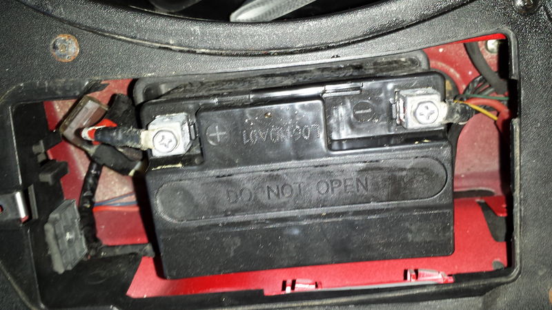

Need some help diagnosing a problem. I went for a ride yesterday, and as I pulled up into my driveway, the scooter died on its own. After trying to restart it, nothing happens. The engine doesn't turn over, and I hear nothing that would indicate the starter is working. Any ideas? I checked the fuse and that seemed to be good.

Check your battery connections and battery. How old is your battery?

I'm not sure how old the battery is. I just got the scooter this past year, so I'm guessing it's much older than that.

Connections seem to be good. Can you see anything I might be missing?

No all the parts seem to be there. Since you checked your fuses I would say the next step is to have your battery tested.

This might seem like a really dumb question, but I've never had to check a battery. Where can I go to get it tested?
I'd get a new battery. Chances are it's old. You can test it yourself to see if it's good. I take mine into the battery place where i buy mine and they test it for me. However if you don't ride a lot or keep t tendered they don't last long. Not that expensive and i'd get a new one just for the reliability factor. Good luck

I'm a retard. Somehow the killswitch was on. I don't know how, but now it's off, and wouldn't you know that it starts just fine. Thanks for the help!
