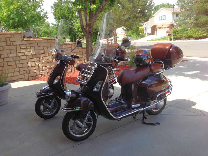

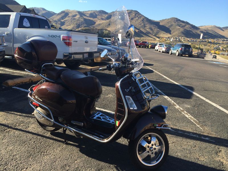

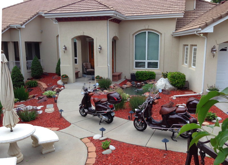

Here are a few pics of the GTV with wind screen and top case. LXV pictured also.
I chose the tall windscreen, and the GT/GTV case for both scoots.

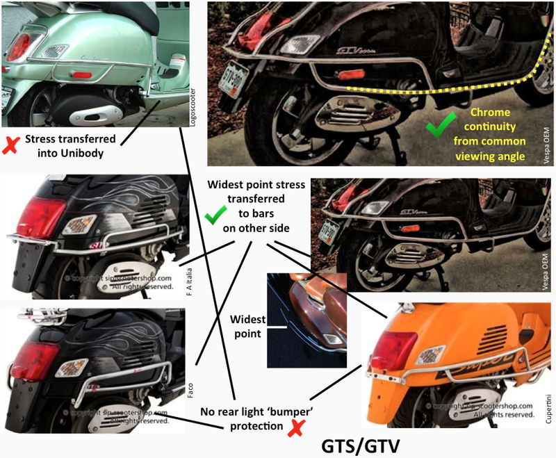

A photo comparison of crash bars, should you be shopping for this protective mod.

yes I would be. I put the top left on my GT200. Found it a tad tough to install but once on it was nice. Which do you (or others) think gives the overall best protection (not that it would be dropped but it does happen). (from experience on a rental and EUR200 later

I believe Vespa OEM bars will provide the best protection for you, along with the best looks, and the largest debit from your pocketbook. 8)

LOL Large is good right

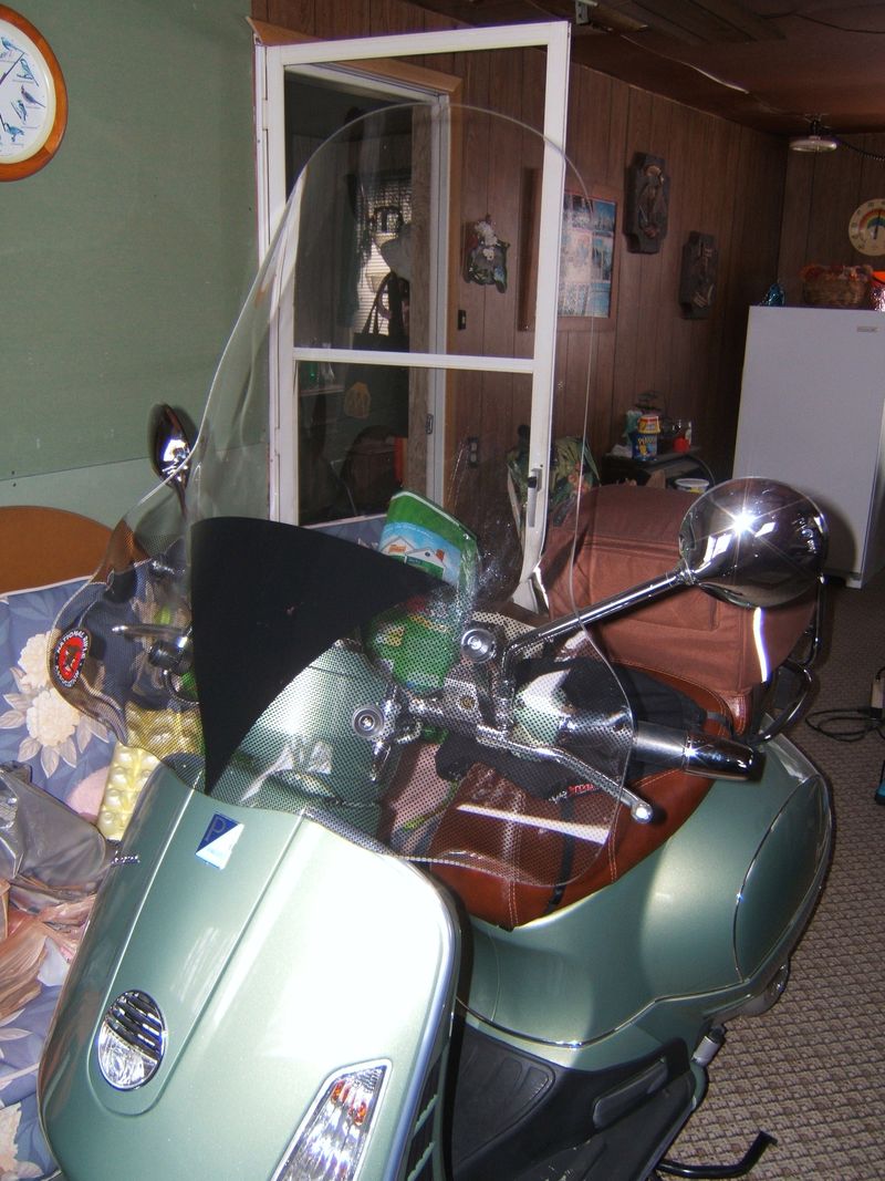

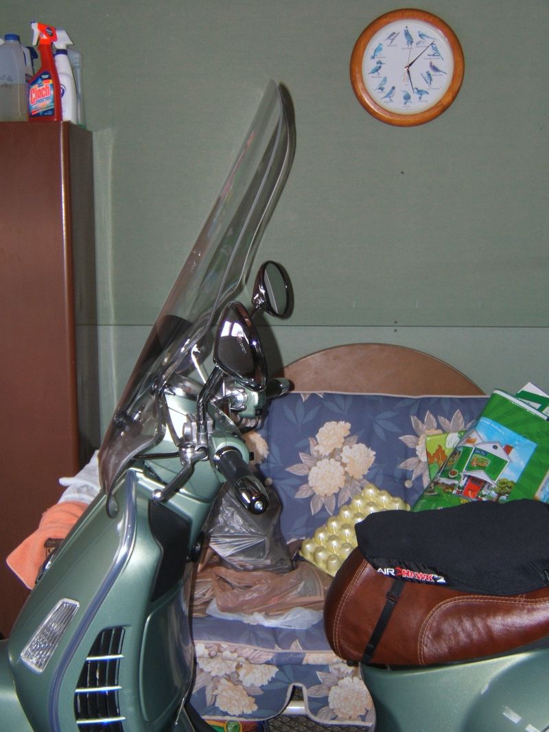

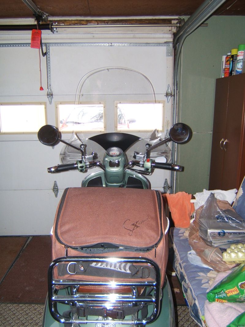

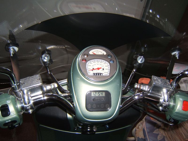

cuppini tall
i did add a couple of shaft locking collars on the stems to keep the brackets from creeping upward. i was afraid to over tighten the screws in the windshield.

Thanks looks pretty straight forward. Appreciate the extra effort on this.
