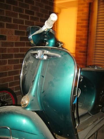

Hey there everyone,
I was referred to this forum by an Australian vespa forum who suggested this would be the best place to have my question answered.
I came into possession of this a few months back and want to put it on ebay or similar but have no idea what year or model Vespa it is, or what it may be worth to someone. I can't really advertise it for sale unless I know what model/year it is.
It has a square number plate holder with 'Made in Italy' written on it and a 'Vespa 150' badge on the front. The odometer reads '180' but I have can't vouch for the accuracy of that.
It's a bit dusty in the pics...sorry about that . But I was hoping someone with a keen eye and a good knowledge of Vespas could take a stab at identifying, the specific model, year of manufacture and how much it may be worth based on it's condition.
It has no key and I have no idea if it runs. There are numerous parts for it, but I am unsure what parts are missing. The seat is missing but the cover on lower left side is not attached, but still with the bike.
If anyone wants more detailed pics of a specific part of the scooter to help them identify it, let me know and I'll take some...whatever you need or if there's an engine/model number or something, let me know that too...I don't know where the identification numbers are on these things.
Hopefully someone can help me identify what this scooter is. All I know is it's a Vespa, but aside from that glaringly obvious fact, I have not a clue. I think it may be a VBB, but am unsure.
Also, hypothetically if you were in the market for this...what would YOU pay for it? Just a general ballpark to give me an idea what price range it might fall into. I don't want to ask way too much and never move the thing...or way too little and end up unwittingly giving it away.
I just want it to go to a good home for a reasonable price really.
EDIT: After much googling, I think it may be a VBB. But I'm not 100% certain. I'm assuming the 'Made in Italy' on the license plate surround means just that and it isn't an Indonesian or Indian built scooter.
Cheers everyone, much appreciated.

this site will show where the VIN and Engine numbers are. Have a look there and then check for a match.
http://www.scooterhelp.com/serial/vespa.serial.locator.html
Looking at the photos, and I'm no expert at this, I would be highly suspicious of the history. It does have some Asian import features.

Looks like a Vietnamese import alright. As such is worth what someone will pay for it. Be honest though, those things are often dangerous, so the person buying should know what they are getting into. I know that's not what you want to hear, sorry dude.

To answer your question after the obiously nearly certain VN connection comments, don't expect to get much from anybody that knows about VN Vespas. Maybe a hundred or two if there are some good parts, maybe not. You might get more from someone that does't realize what it is, but please don't do that. In all likelihood, it's much worse than it looks.
And I know there are exceptions but there are too many red flags to imagine this is one.

that couldnt be more nammy if ya hung noodles on it to dry

If you really like scooters and that one was given to you. Do yourself a favor and get a good used scooter from a good source.
That one is not the one you want to begin liking scooters with.
Posts: 10075
Posts: 10075
There are many typical points on this bike that usually signify Asian restoration such as the chrome trim bits, rubber mat and even the color. If you read some of the Bodge Spotting thread, you'll find more.
It's not all so obvious to the uninitiated, but the real problem is any bodywork that may have been done can be very risky and these bikes have a reputation for that as well as 'refurbished' worn out motors that break down soon & often.

Another big problem are the worn cases.
It is common to find bearings that have been 'dimpled' so they fit.

Those yellow boots on the center stand are common on VN bodges, but could also have been something available cheap to anyone or taken off a bodge.
Most sure method would be to take the body down to bare metal and see if it was pieced together or seriously patched. The welding should be relatively obvious.

Most imports also have a new speedo with low milage as yours does.
I'm pretty sure you have something from SEA. BUT, it may be in reasonable condition and usable, but you or someone really needs to do as Aviator suggests and have a good inspection of both engine and body work.
In Melbourne either Roberto or Derek would be able to have a look (Vespa Wizard or Scooterlabs) and give you a rough idea of its condition and possibilities. Both will give an honest impression. Roberto has seen a lot of 'em that people have bought in and they have been real dogs. The problem is that it does take a lot of work to do a full inspection of all the shit that could be wrong with it.
Have you tried the kickstart to see if the piston is seized or not? Whereabouts in Melbourne are you?

Is this a VBB Vespa?
Most Vietnam rebuilt models have been converted to 10" wheels. If it is a VBB it has been converted. Vietnamese paint job. Vietnamese accessories all point to the fact that it has received the V. treatment. Most Vespas ex. Vietnam have had the VIN number restamped so the identification may not be truly possible.
The IGM number is a design registration and for VBB models should be 'IGM 1380 OM'.

Re: Is this a VBB Vespa?
Bill - Vespas in vietnam didn't have unique VIN's . . . did they . . . ??
Or am i misunderstanding your point about restamped VIN's?

monkeyboy666 wrote:
Anyway, what tells you guys this scooter spend time in Asia and has had it's Italian purity violated?
Again, thanks for all the help with this
I'm a relative newcomer to world of Vespas, but can identify a few items that tend to be common to Asian bikes:
- Yellow boots
- Glove box on leg shield not appropriate for year/model
- Near florescent "minty" paint
- Chrome hubcap
- Chome thing under the headset
- Chrome helmet hook
- Floor mats (possibly hiding sketchy bondo work or worse)
It's possible all the above was done by a local Aussie, but more likely that the bike was imported from Asia.
Asian bikes get ridden hard as they tend to be the primary mode of transportation for many people, and they are often used as work scooters to haul things. When they wear out, they tend to be repaired "creatively" with inexpensive, recycled and jerry-rigged parts. Like a used car, shiny paint on a scooter doesn't mean it's sound.
People who know Vespas will pay what it's worth. Your best bet is to learn a little more about that model and inspect it more thoroughly before you put it up for sale.
Good luck.

It is not clear whether Vietnamese Vespas imported to Vietnam in the 1960s and 1970s had VIN numbers but of the rebuilt models exported, a proportion have VIN numbers in a style that is identical to those imported into the Uk during that period. The majority ex. Vietnam have VIN numbers in the same format as the Italian stampings but are evidently newly marked. In the recent past the Italians had a scrappage scheme where the surrender of an old machine (generally two stroke) earned a discount against a modern 4 stroke. It is possible that the chassis numbers and engines found their way to Vietnam. Some machines ex Vietnam have chassis parts containing a VIN number inserted into another chassis. The permutations are endless.
