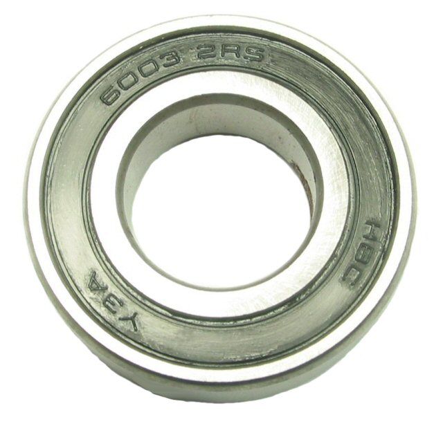

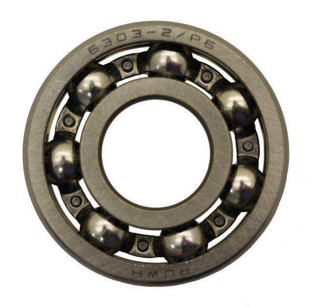

Why would you advise someone to pay about five times more than they have to for an item and then wait a week for it and feel like you are doing them a solid? He can walk into any auto parts store and have it in fifteen minutes.
Here's a picture of a Bearing...
This is another bearing, a sealed bearing.
As you can see, there are numbers on both of them. There are numbers on the bearing the OP needs too. He can write those numbers down and walk into any auto parts store and leave with the bearing, more than likely for less than $10,without waiting five days and paying shipping.
