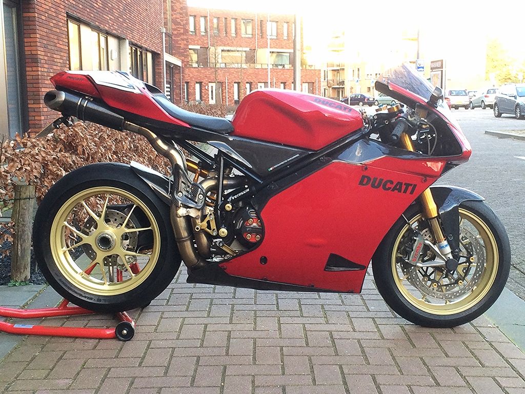

Here's a picture of my home made 1099SP carbon Ducati (custom 748R with a 1098s motor, Full Ohlins, 1098 subframe and tail, 848 swingarm, etc)

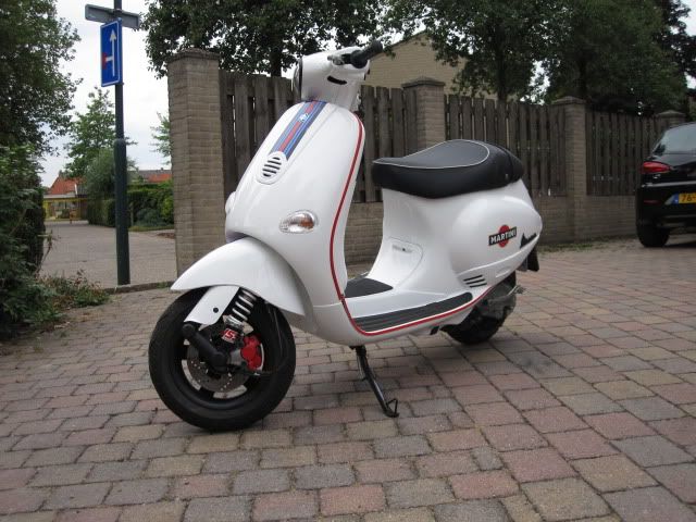

So last year I found myself another ET4 this time a pretty beat up Leader 150cc:

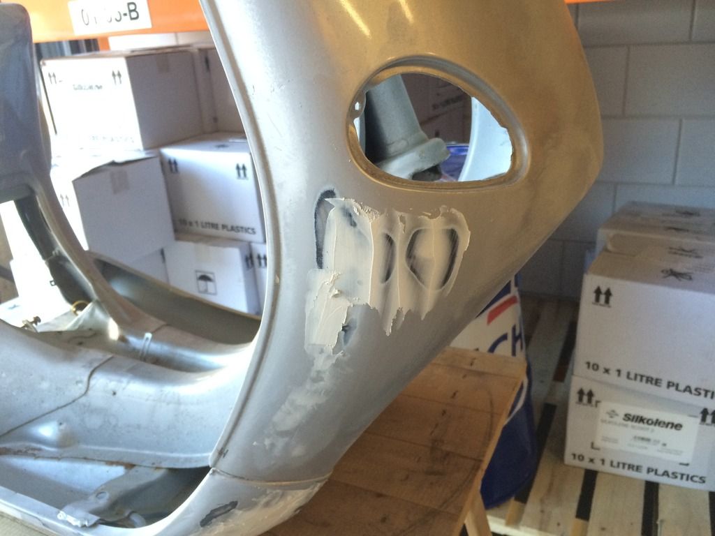

There is no rust at all on the bottom part of the frame... Never seen one in a better condition... The big dent in right lower front pannel is already "been taken care of"... And all the part have been scotched and sanded prior to painting... It will be white again, again with Martini Striping, LX wheels and LX S front fender!!

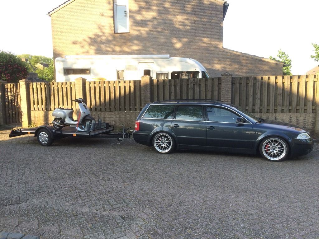

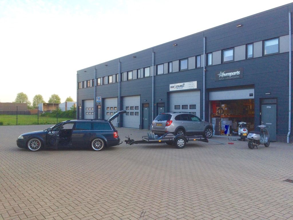

I hauled it on my motorcycle trailer to my mates shop for restoration...

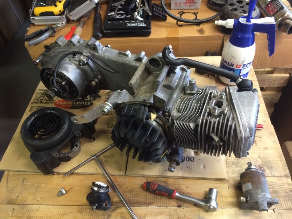

And then it began... Tearing it apart... My goal was to do a quicky on her... But as I gone along, all kinds of downfalls occured... So I decided to go all the way... As a true perfectionist, I just couldn't live with the idea of skipping some parts...
My life quote: the jobs worth doing are worth doing well...

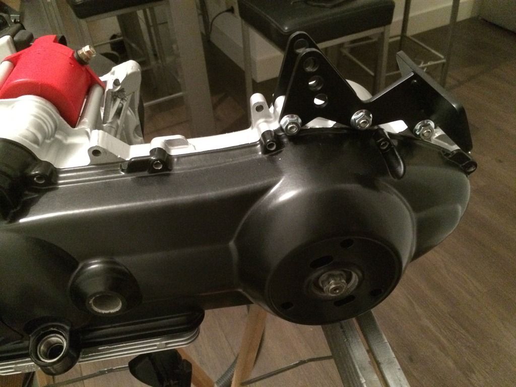

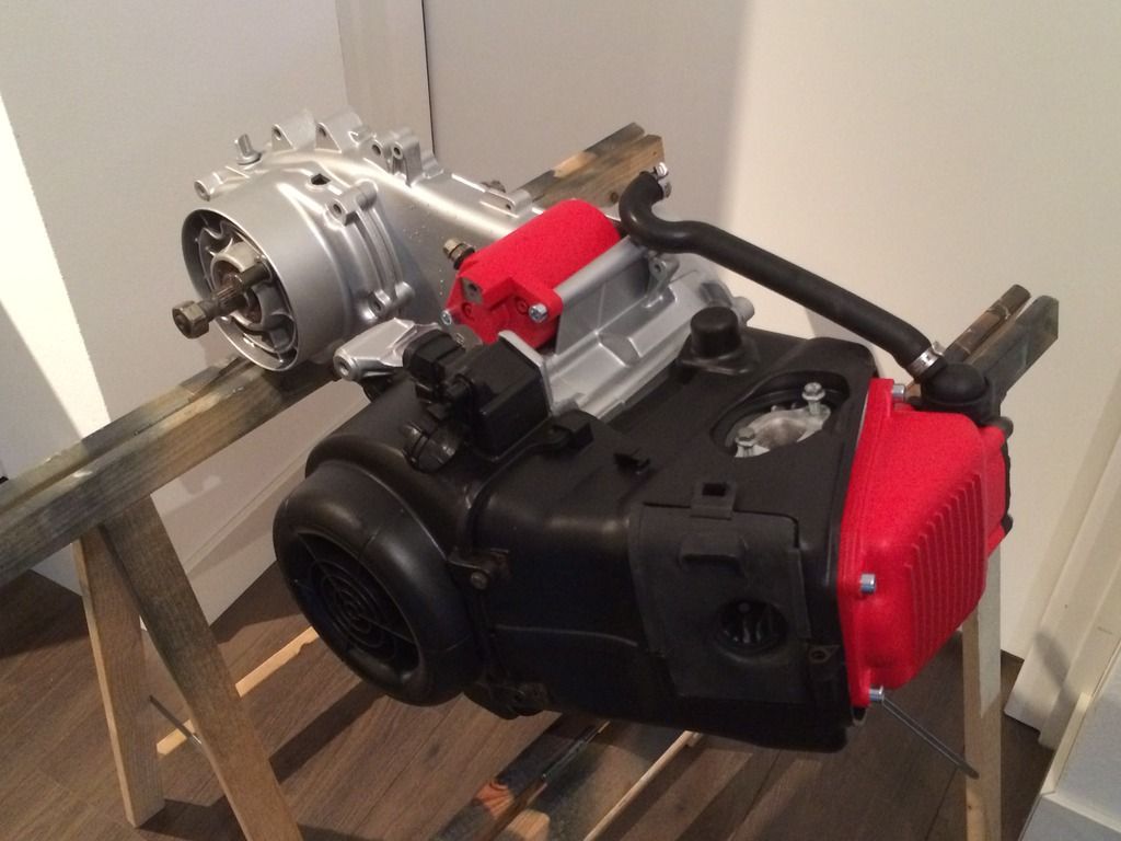

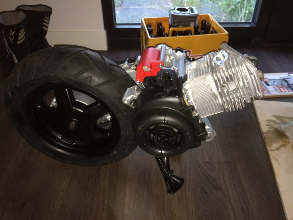

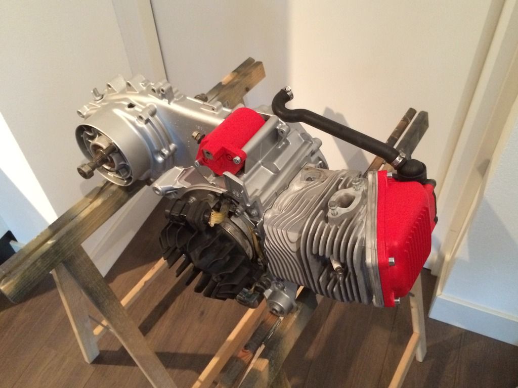

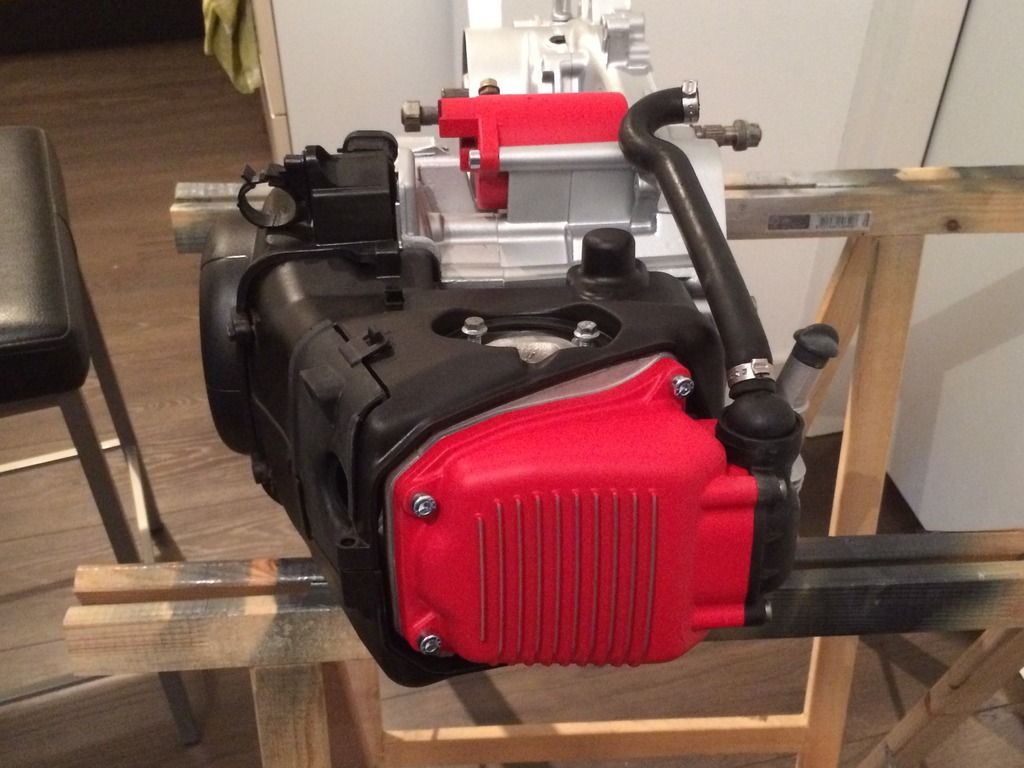

Took the motor out, the bugger was nasty as .... Cleaned it, soda blasted it, and gave it a fresh layer of paint... (Motor "tech" will be mentioned later...)
Before:
After:

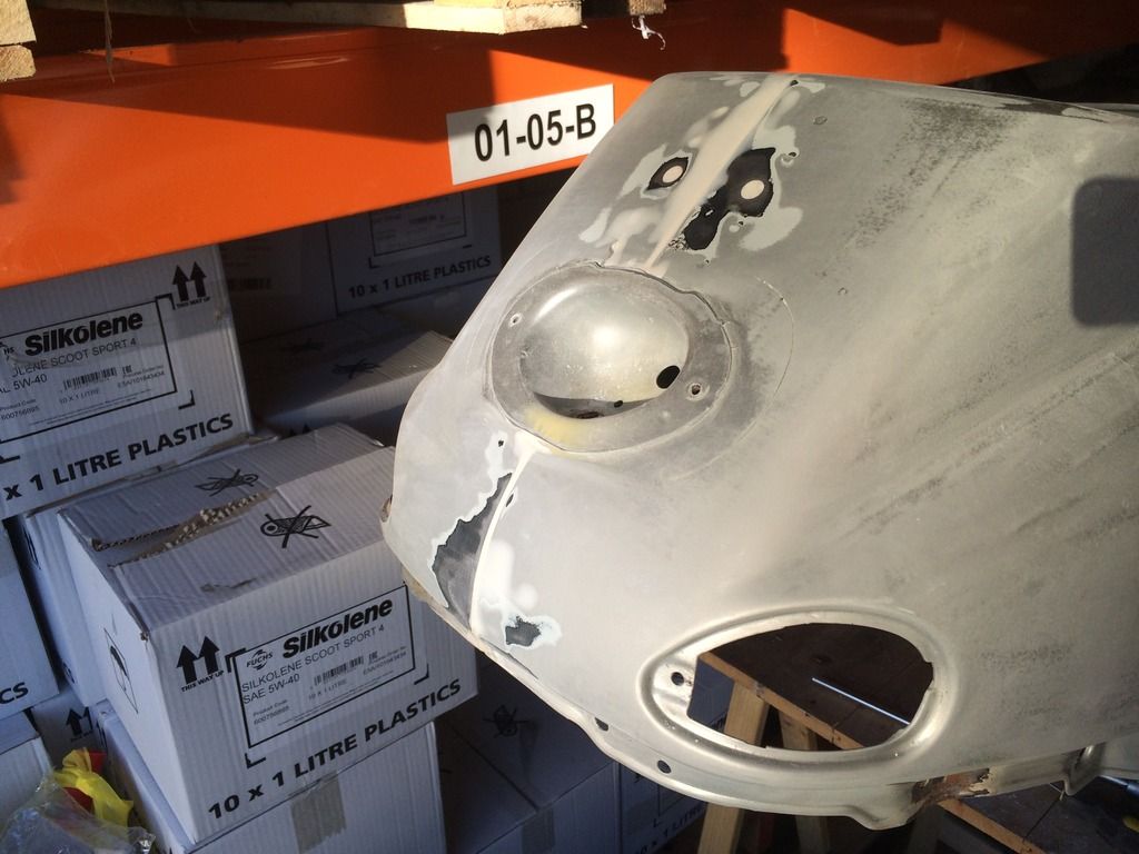

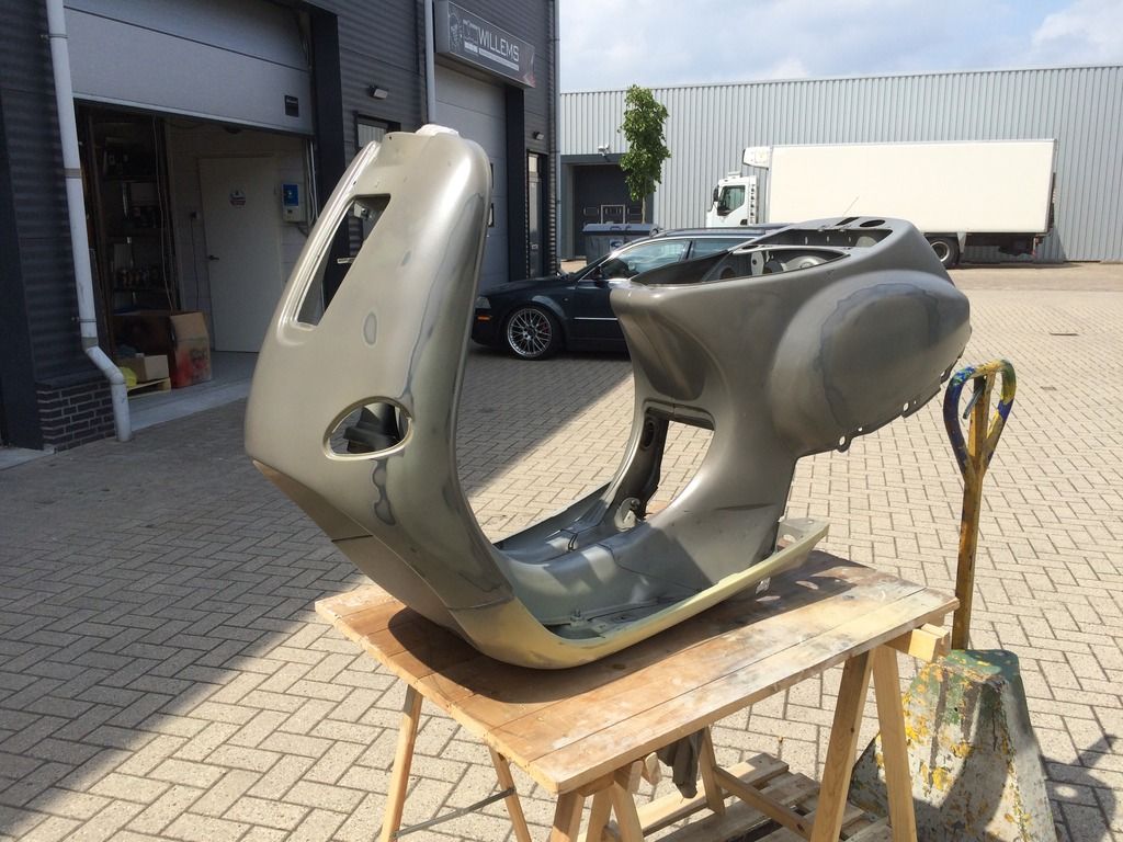

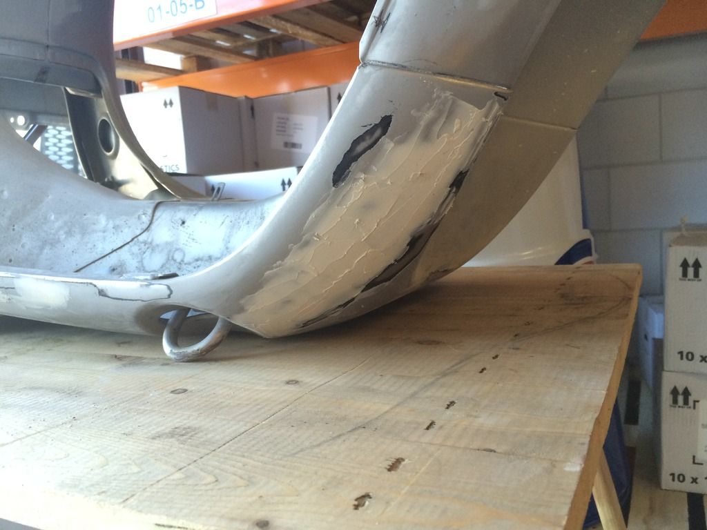

Did some repairs on the body, some where a real p.i.t.a.

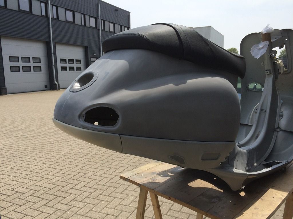

UV Primer on... Tight as a baby's ass!! LOL.. Took me 3 full day's to de-dent it and prep it for paint...
After some final sanding it's just waiting for paint at this moment...
Motor wise: It's a 150cc Leader, so I decided to go 200 Liberty on it... But due to the loss of compression ratio (200cc piston) I decided to machine the head a bit to higher the CR... But that aint enough... We need more air inside, so i have my camshaft machined as we speak... More lift isn't gonna do it by itself... bigger valves is the next step... Redesigned head with 34mm intake valve and 25mm exhaust valve are on the white board....
Vario wise: Malossi Multivar, Polini evo clutch + clutch bell, Polini upgear

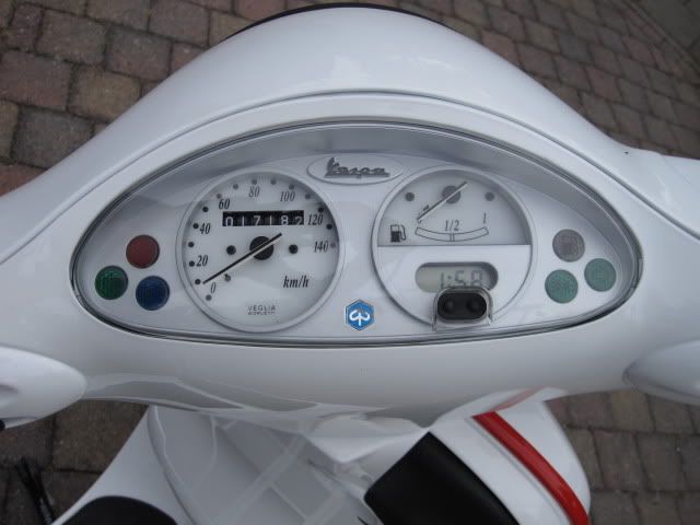

Oil temp & pressure gauges
Rpm gauge...

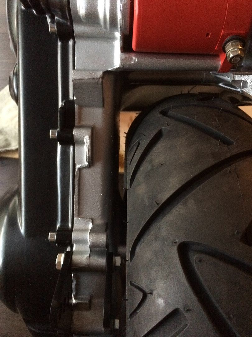

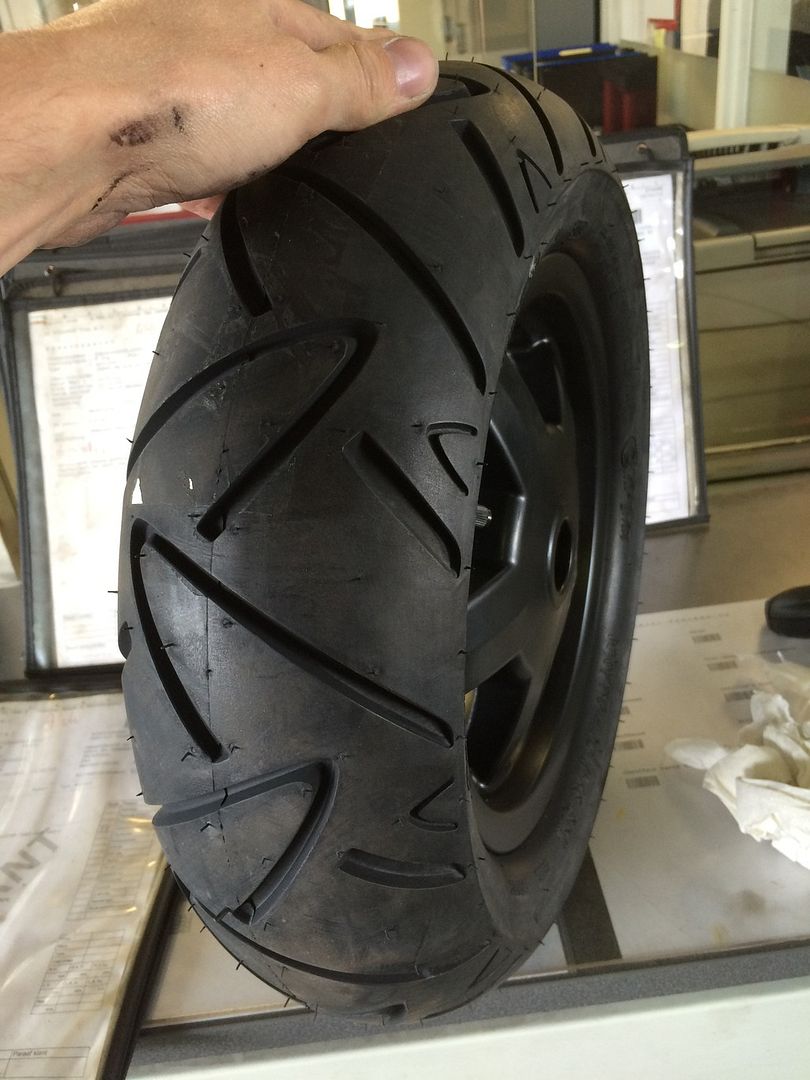

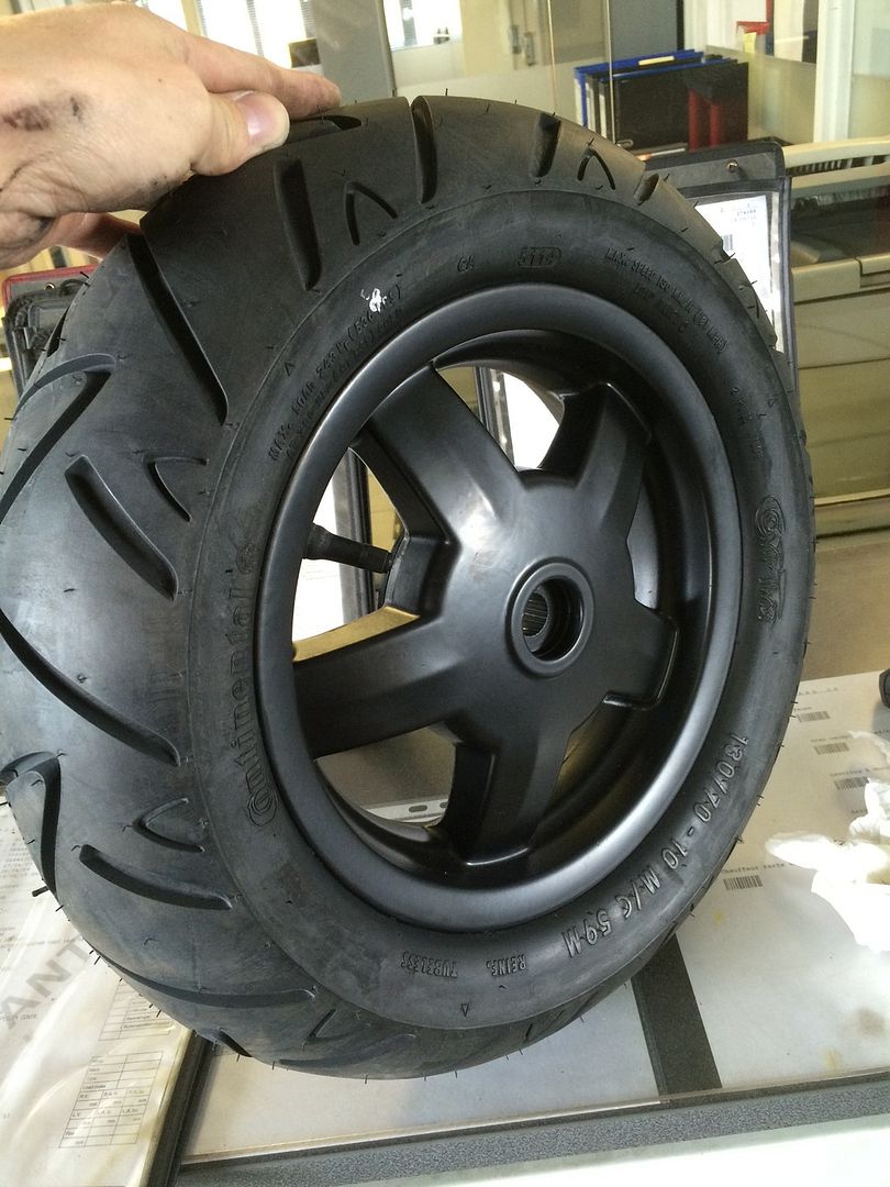

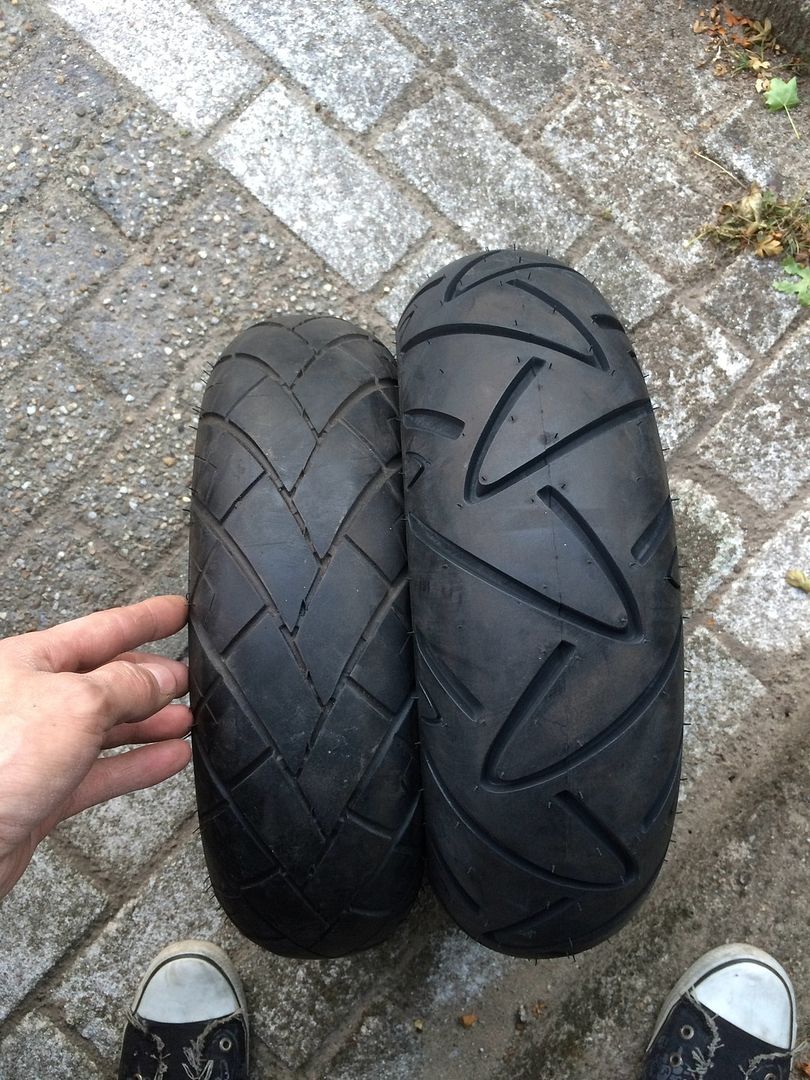

Today I received the Tyres... Went 130 on the rear...
Compared to my worn Michelin, it seems a huge tyre... Love the look, but it just makes me wanna need even more power... Upgear with this tyre will do alot to the topspeed... But only if I can find the hidden ponies.... Lol

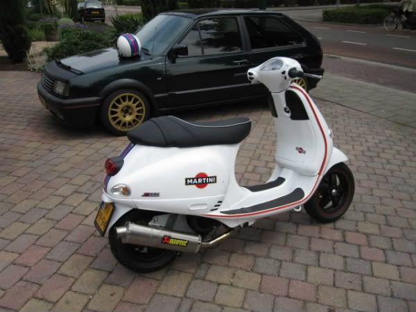

I love the cage mate. Do you not have speed bumps in Holland?

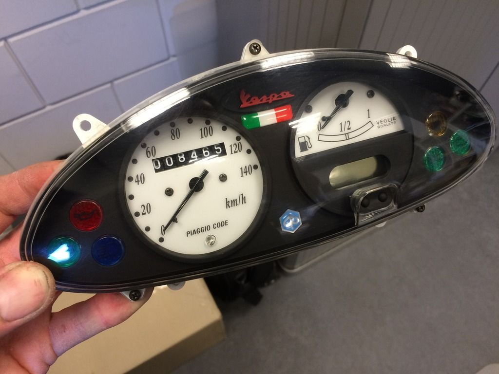

- I've been meaning the "gauge surround" black, looks GREAT. The small Italian flag is a nice touch too!
Is it difficult to get the clear plastic off? I've never really liked the yellowish color Vespa/Piaggio used
