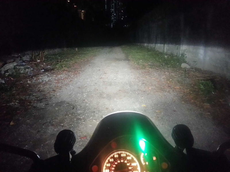

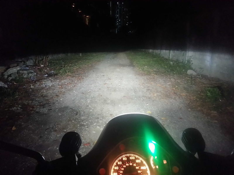

These are pictures of the lights.
I took measurements of the road, that should be part of the 2nd photo sessions.
Bixenon on Low Beam - No Denali's
Bixenon on Low Beam - Low Power Denali
You'll notice the walls are better lit.
Bixenon on Low Beam - Low Power Denali You'll notice the walls are better lit.
The photo doesn't show the true quality of the what you can see in person.

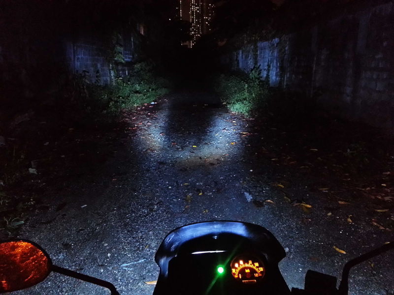

As a reference, this is a small displacement Kawasaki 175cc with HID. The lens was designed for and H4 bulb, that why the light dispersal is shoddy.

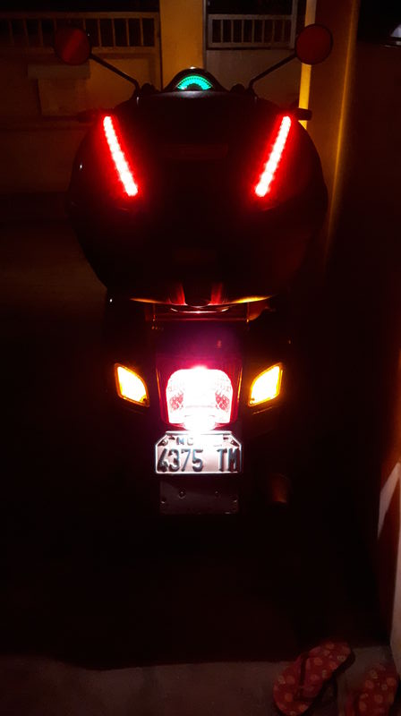

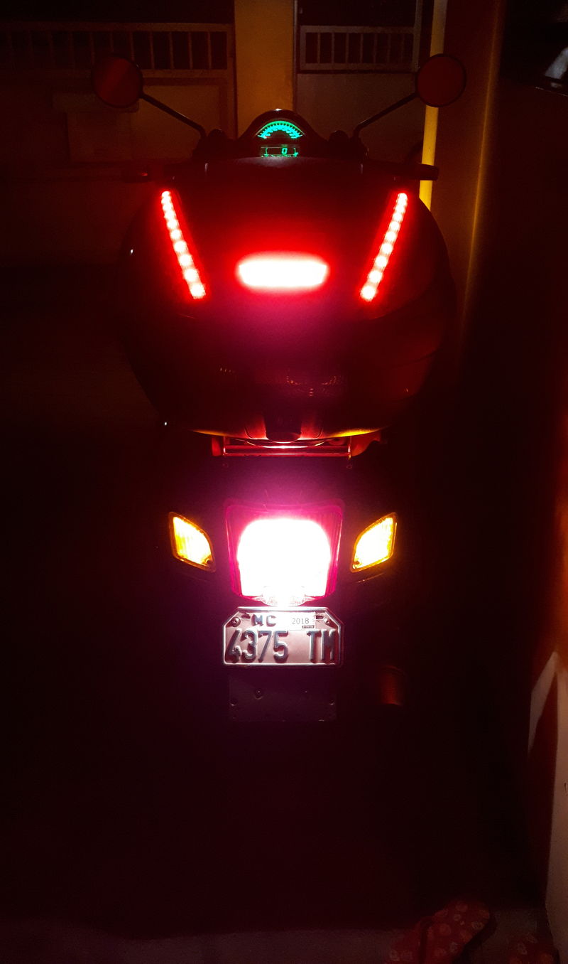

here are some rearward shots of the scoot, I still love it and have it.

Here's one with the brake light on.

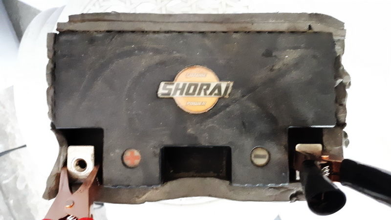

Back in 2013, I installed an extremely large battery in my GTS and I have an update to the mod I did.
I bought my bike 2nd hand, I had no knowledge how old the current battery was and being an automatic with no kickster, I was not looking forward to the batter conking out on me. So I replaced it.
I was given the option of getting a Shorai Lithium-Iron battery, which was like a 10th the weight of a normal lead acid battery. 12v12Ah is what was installed, like the numbnut I was, I asked if there are anything stronger. The guy said YES. But we'll have to remove the tray under the battery for it to fit. He then proceeded to glue foam pads to isolate the battery from vibration.
This happened back in 2013, the battery was 12v21Ah. Yes, you read it right, 21 amperes and SEVEN years later I'm getting the "heebeejeebies" because the unnatural life span of the battery.
I emailed Shorai batteries and they said to charge the battery up to 14 volts and let it sit for 2 days, retest the voltage, if it doesn't drop, it's still good. I did exactly that and the battery held the charge. I'm still worried, but I'm going to ride this train all the way to the end of the line, just out of curiosity.

Here's a picture of the battery's condition after 6 years.
